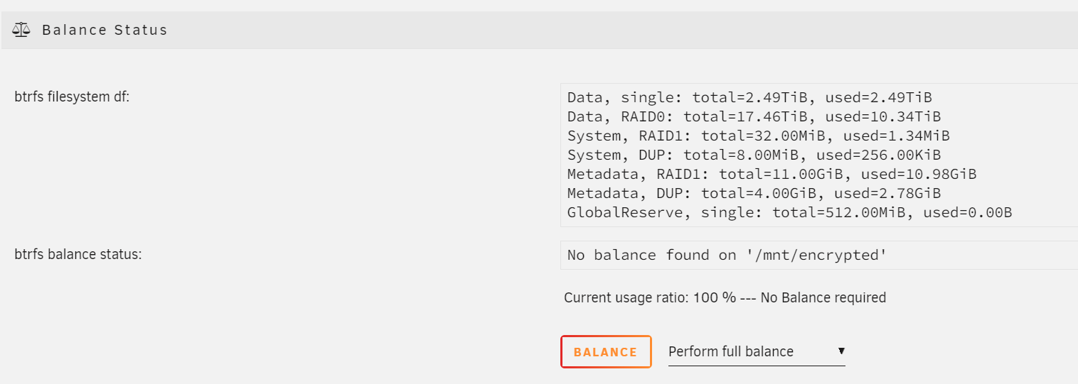

Any thought on reverting it back to single mode in place or is a copy and reformat the only option?

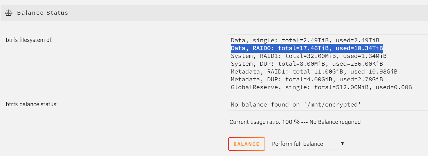

Before I do anything further I want to back up the data to the array. Curiously everywhere I look, the pool capacity is listed at different values. The GUI lists it at 22TB, the btrfs Balance status at 17.46TiB, and the unBalance plugin somewhere around 7.8 TB. Is there any risk of data loss here or should it all still be available just read only?

Thanks for the info. So at this point how do I go about correcting this? I tried to use the balancer to change back to Single mode but it doesn't appear to be doing anything.

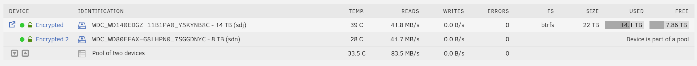

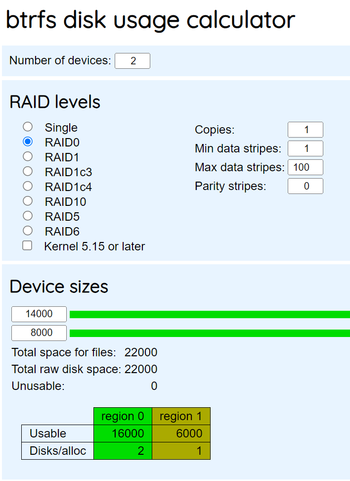

Good to know. I was using this link from the Storage Management docs which made it seem like I would be able to use the full amount of storage on the drives. Additionally this info from the Balance section in the pool config also led me to believe that I would have more storage than the single drive. I guess I just misunderstood what was happening. So are you saying I can have multiple drives in a pool and set it to single mode? When setting the pool to single, how is the data distributed between the two disks?
Drive Pool In Read Only After Adding Drive and Changing to RAID 0
I recently added a new drive to a drive pool and changed the type to RAID 0. Initially it seemed to work fine but once the rebalance finished the pool became read only. Scrubs also abort instantly with error -30. I m seeing a bunch of errors in the logs related to brtfs as well. Any Ideas what's going on?

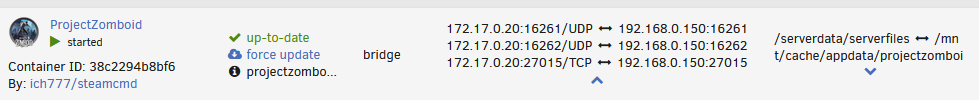

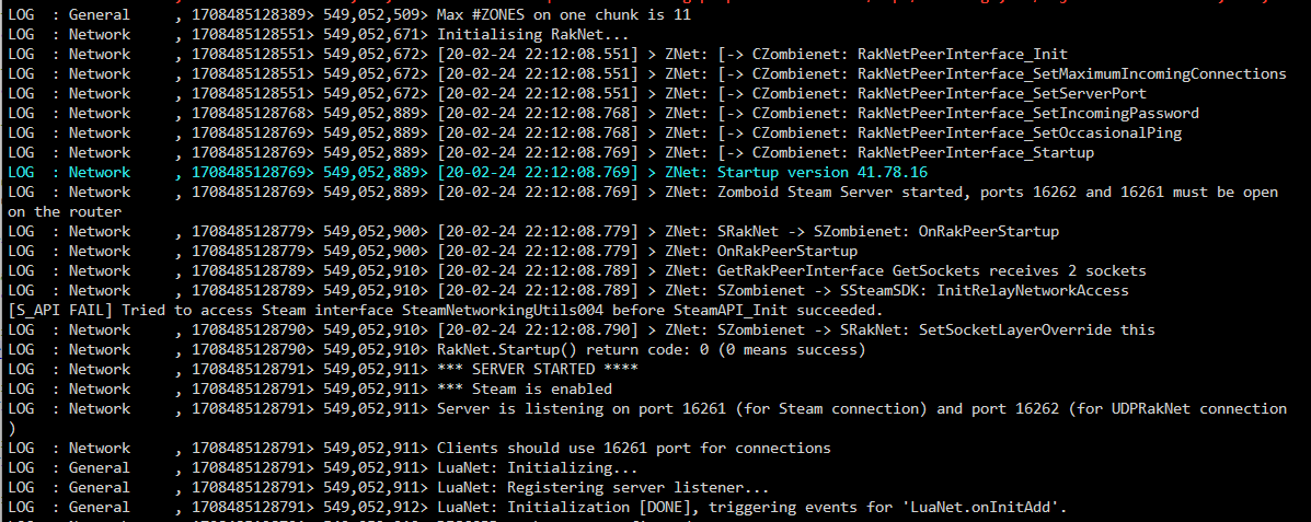

I am trying to get a Project Zomboid server up and running and I cannot get the port to appear available when checking via canyouseeme.org nor can I connect to the server. I've successfully set up port forward before for various ports so I know my router's port forwarding is working. I've installed the container with the default settings and forwarded the ports but its not working. I'm suspecting there is some firewall preventing access from within the container. Any ideas what I'm missing here? Container: Firewall port forwarding rules: Logs showing ports:
