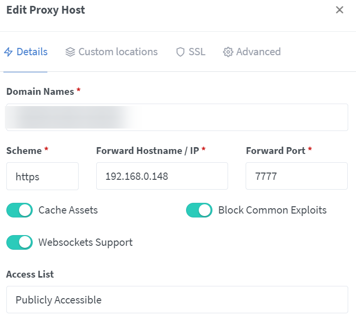

Hoi, what am i missing? My image host works just fine, and when i launch webui from docker list in unraid, it opens as expected in the subdomain it's assigned. But for hastebin for instance, opening it's webui is still local IP, and when i click on it's hastebin link in NPM, it redirects immediately to my image host.
I setup the cloudflare CNAME the exact same way as with the image host, ssl is set up as well. Other containers won't work either.
Edited by Duckers
Are you sure your hastebin runs in https? My guess is that it should be http.
