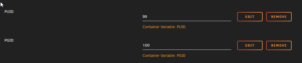

5 hours ago, TeKo said:
I'm getting this error:
Is there something I can do to fix this?
AFAIK,
Are these set in the config?
And what are the read/write permissions on the ..../appdata/Nginx-Proxy-Manager-Official/data/logs files? Make sure that they are set to this

3 hours ago, aglyons said:
AFAIK,
I added both variables to my config and set the permissions. Looks like the error is gone. Thanks a lot.
