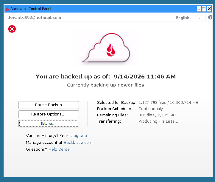

  4. I have a similar problem after successfully migrating from the other container. It was working for a week or so and I noticed today it says it hasn't uploaded in more than a day. I also noticed that nearly everytime I have looked at it this last week or so, it says "Producing file list...". Even right now. backblaze64-diag-202609151752.zip

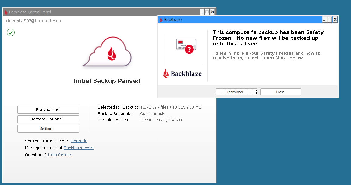

  6. Well I checked a little bit ago and noticed it seemed to have my correct size/file amount on the main window and said it was preparing files. It also said it skipped a few files due to permissions. So I figured it started working. Well now I checked again and I have this: Computer's backup has been Safety Frozen.

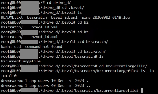

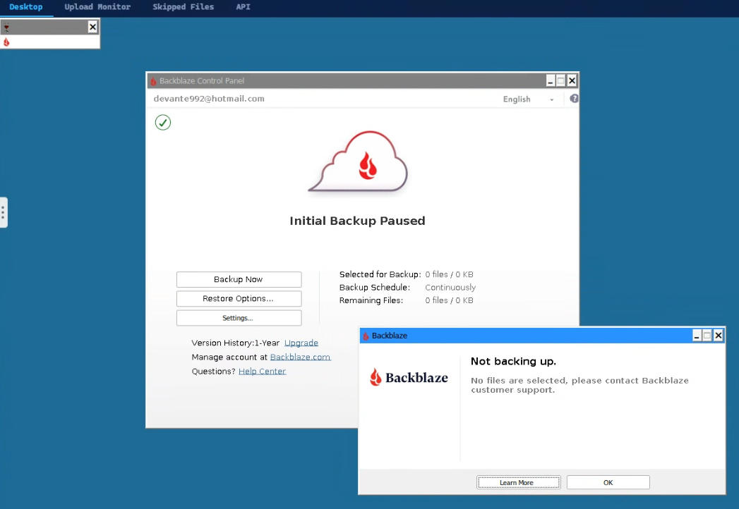

  7. Hey guys, So I disabled tessypowder and installed iamfoz. I set a different appdata folder and mounted the exact same mount for /drive_d/ (which would be /mnt/user/). I've tried both with and without trailing slashes. I inherited backup and let it scan. I came back after a couple hours and there was simply no window. Just the tabs at the top. So I had to restart. Checking the web dashboard looks like the inherit worked and the container stopped showing trial and shows my 1 year plan. However, when I start the container up, I get a box that says "Not Backing Up: No files are selected." and the main window says "Initial Backup Paused." When I check the settings, the D drive is definitely selected. If I try inherit backup again, it only lets me select the trial backup so it seems inherit worked correctly. I just can't get it to pick up my local files I guess? Going into the console and going to cd /drive_d/ shows the correct files. And there is indeed a .bzvol at /mnt/user/. The files in the .bzvol folder have today's date, but the bzscratch folder has 2023 (when I first started using Backblaze). bazscratch has a folder called bzcurrentlargefile and bazcurrentlargefile has nothing in it. Did I just... magically lose my backup or something? Also, wouldn't it still be trying to scan the files in my /mnt/user/ folder? Thank you!

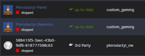

  14. Hey guys, just a quick one. Anyone know of any way to customize the name and icon of servers installed via Pterodactyl? For example, this is Minecraft: ' Clicking the icon shows only Start, Logs, and Remove. Thank you!

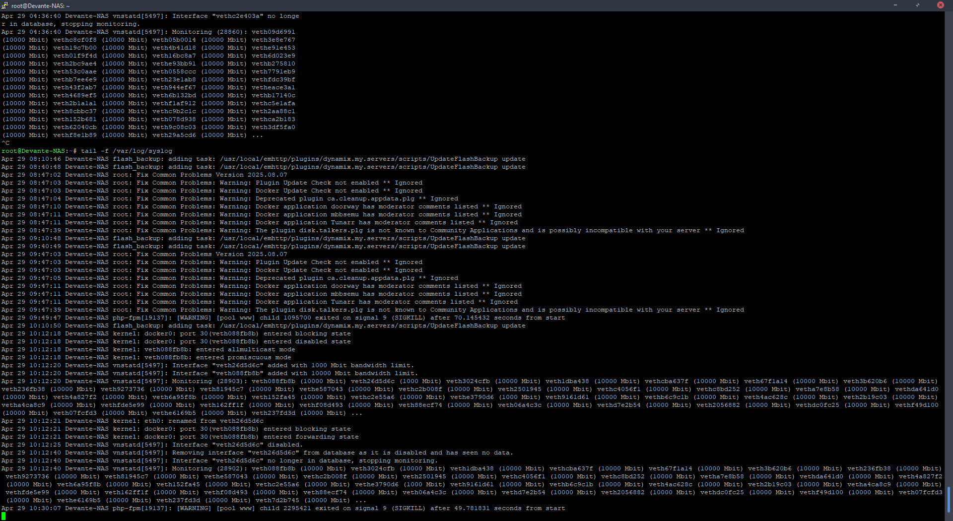

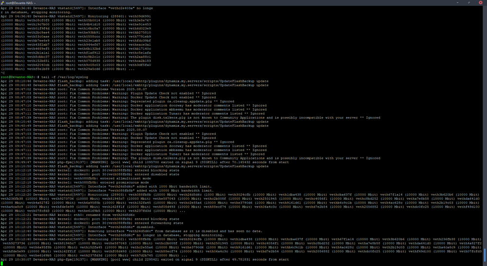

  15. Update Well guys, I don't wanna jinx it but I'm pretty sure I found the issue. You guys ready for this one? tldr; The stats in Prowlarr being called caused the RAM to max out. The culprit: the Prowlarr widget in the Homepage app/container. And only when actually bringing up the Homepage UI. So how did I get to that? Well over the months, I've turned on containers one by one and let it run. All the other times it locked up, I don't remember exactly what was running or what I was doing but I have had a feeling it was either Krusader or Homepage for months. If you see, I mentioned this on Feb. 25. Well a month or so ago I was talking with a friend about Homepage and started it to show my friend and the server locked up. So then I turned everything BUT Homepage on and it was fine. Then I started each app for which there was a Homepage widget until I started Prowlarr and it instantly locked up again. So then I load ONLY Prowlarr and it's fine. I click around and as soon as I click on the stats page, it spikes the RAM and locked up once again. My Prowlarr settings were set to never delete any history and so I had millions of queries from the past couple of years. Once I set it down to like two weeks, it still spikes the RAM if I go to stats but not as much (4GB vs the 20+ GB from before). I removed the Prowlarr widget from Homepage and turned everything else back on and so far it has been fine for a few weeks. One little widget caused me so much pain ha. I'm sure the widget was triggered whatever going to the stats tab in Prowlarr does. I think one thing that was making it harder was all the SIGTERM errors I've been getting. I don't think they're related at all actually. I think they're something else because I'm still getting them and it's still causing my webUI to lock up for a minute or two but the CPU and RAM both are at normal levels when it happens. Grok says it could be my disk IO wait times. I noticed usually when that happens, the busy percentage jumps from under 100% to like over 400%. I'm not sure how to tackle that issue though. I guess I'm just glad I found the original issue! THanks for everyone who tried to help!
