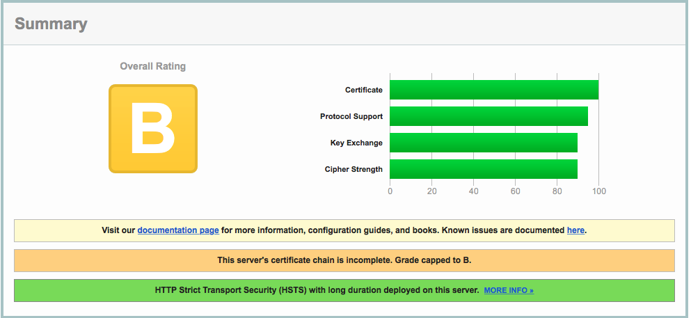

  • I have updated the ownCloud Docker.  nginx is updated to version 1.13.3.  I ran the SSL security check against my URL and ownCloud passed with flying colors.  If you want to test your URL and ownCloud

Dear dlandon and other folks,
Kindly I would like to inform you that we finished technical testing and that the software works to our expectation and beyond. We managed with ease to create a subdomain [https://paper.example.eu] with an aligned SSL certificate from https://www.sslforfree.com. The SSL test results are stated here below (Grade: B):
Our conclusion is that we recommend this software package as it is presented today.
Thank you for your time and explanations!
