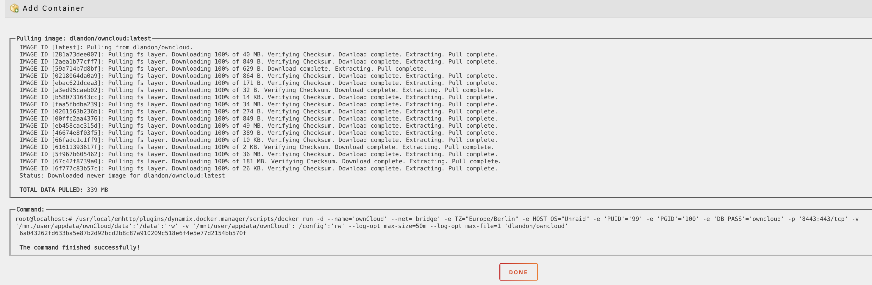

2 minutes ago, Squid said:
sorry, now I get it, but still no access.
root@localhost:# /usr/local/emhttp/plugins/dynamix.docker.manager/scripts/docker run -d --name='ownCloud' --net='br0' --ip='192.168.1.25' --cpuset-cpus='0,1,2,3,4,5,6,7' -e TZ="Europe/Berlin" -e HOST_OS="Unraid" -e 'TCP_PORT_443'='443' -e 'PUID'='99' -e 'PGID'='100' -e 'DB_PASS'='owncloud' -v '/mnt/user/appdata/ownCloud/data':'/data':'rw' -v '/mnt/user/appdata/ownCloud':'/config':'rw' --log-opt max-size=50m --log-opt max-file=1 'dlandon/owncloud'
a86eff774d57772e65e06894f5d53647b386711251fa28d68819075d99f60cf1
The command finished successfully!

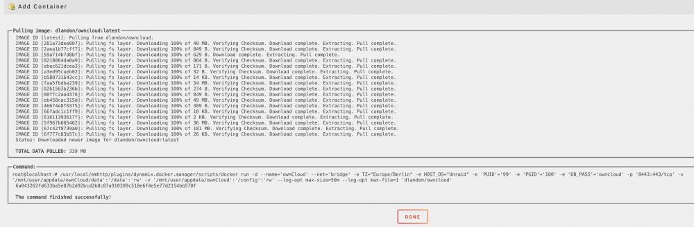

10 minutes ago, dlandon said:
Start over.
Remove the docker image and any orphans.
Delete the appdata/owncloud folder.
Use CA to find the docker and apply the default template.  Don’t make any changes.
Did it. Same game.
Shall I delete everything including DB and start again?

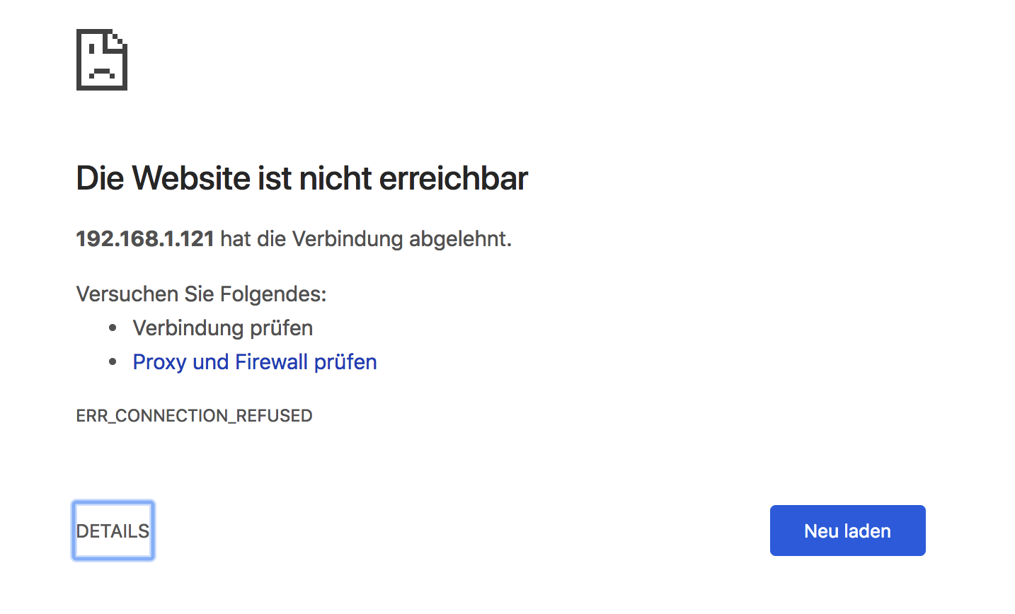

Show me a screen shot where you see the error.
2 minutes ago, dlandon said:
Yes.  Deleting the appdata folder removes everything.
thats what I did before... still not reachable..
That's a connection refused message.  That will occur if you try to access ownCloud with http:// which is what the nginx log showed earlier.  If you look at the address bar you should see a lock or https:// indicating secure access.  ownCloud refuses a http:// connection.  It has to be https://.
What shows when you click on the "DETAILS" button?
Try another browser or computer.  I suspect a browser issue.

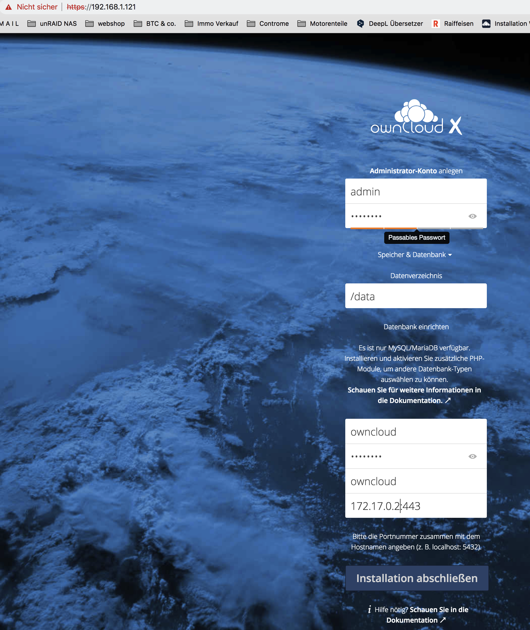

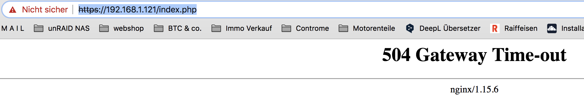

Like a wonder, after trying again.... I'm having fun again...
bammmmm!!! like a hammer in the face:

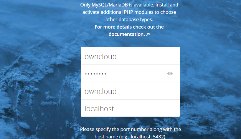

I don’t remember the :443 on the database ip address.  Did you add that?
i really don't know, where exactly do you mean?
Change the 172.17.0.2:443 to 'localhost'.  Like this:
tried yesterday. Try it again.... Just finished a new installation. See log attached. May be you can find something wrong...
install_log.rtf
It is unbelievable. I'M IN THE WEBGUI FROM OWNCLOUD !!!!
That "localhost" was wrong. But yesterday get an error with that. After that I allways wrote the IP with Port there...
Thank you VERY MUCH for not giving up with me !!! Wish you a good day/night, wherever you are at home ;-) i'm from Switzerland.
