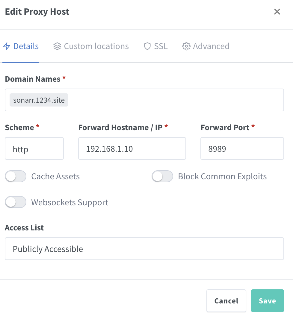

In my adguard home config, I created a filter, DNS rewrites *.1234.site and pointed to 192.168.1.3 (npm).
In npm, I have the following:
Doing so, I get 502 Bad Gateway.  Going to letsencrypt, using sonarr.1234.site, shows the following:
sonarr.qnap.site: There is a server found at this domain but it returned an unexpected status code Invalid domain or IP. Is it the NPM server? Please make sure your domain points to the IP where your NPM instance is running.
another proxy host tower.1234.site http://192.168.1.10:80 leads me to the Congratulations page.
I have a firewall.  I haven't port forwarded anything yet, as I believe that's what adguard is there for.  Internal access to sonarr.1234.site should point to app behind npm.  Is this correct?  Or do I have to configure firewall?  So far, no intention to access from outside.

Thanks!  I will try your suggestions.
@Espressomatic
After following all your advise, this is the final step got it working.
Now, I can access radarr.1234.site, tower.1234.site, all EXCEPT sonarr.1234.site.  Sonarr doesn't proceed.  But after sometime, it does.  Sometimes after 30 mins, this time, after restart of all docker, a day.  Similar behavior with other browsers, chrome, edge.  Any idea what causes this?

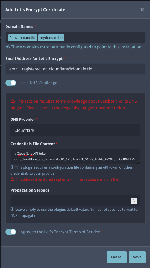

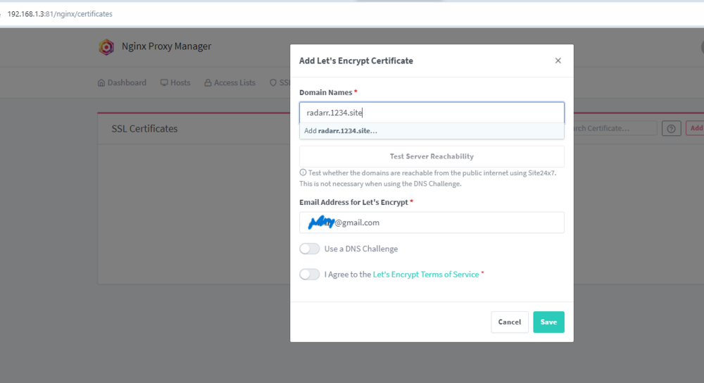

Lastly, how do you get ssl cert? Below test doesn't work.  I've tried *.1234.site, doesn't work either.  Error message says:
*.1234.site: There is a server found at this domain but it returned an unexpected status code Invalid domain or IP. Is it the NPM server? Please make sure your domain points to the IP where your NPM instance is running.
You start first by getting cert for your base domain and wildcard on same domain - you can use that cert for any subdomain. If you also want additional unique certs by subdomain, you can also do those separately after, the same way.
Your domain(s) need to have DNS set up with a provider that accepts DNS challenge for validation. If your DNS is not currently with someone that supports a challenge for Let's Encrypt, then you'll need to make those changes first.  Otherwise you will have to do HTTP validation which requires a connection into your domain, which means opening ports, etc.  NOT RECOMMENDED.
For example, if your domain is registered but not currently in use, you open account at Cloudflare (for example) and then set its DNS servers in the DNS record for your domain using your refgistrar's control panel. If the domain is already in use like for an external site, then you will also need to make settings at Cloudflare (or elsewhere) to migrate the DNS setup from your web/mail/whatever hosting company so all that keeps working. That's outside the scope of the info I'm giving here.
The form in NPM should be filled out exactly like this. Substitute your domain(s) and email, plus select the provider of your DNS. I use Cloudflare and a couple of others - for no particular reason.

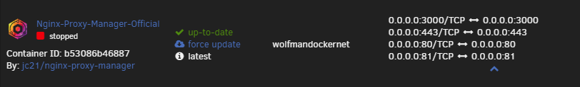

I'm having some issues starting up NPMO.  I currently run nginx on my firewall, but it has not been updating the Let's Encrypt certs automatically (I cannot figure out why).  After an issue with Google flagging my apps as dangerous (got that resolved) and restarting my current nginx service, now 2 of my apps are not working...  I decided to switch to NPMO in unRAID as all but one app that needs nginx is on the unRAID server anyway.
When I try to start it up after selecting my docker custom network, I receive an error in my logs and this is what the mapping looks like in the Docker tab.
This is the error in the creation log.
docker: Error response from daemon: driver failed programming external connectivity on endpoint Nginx-Proxy-Manager-Official (ea336f70b9060a33facb1c1604d88956cacd513ac79bc324b838e9220addbb0a): Error starting userland proxy: listen tcp4 0.0.0.0:443: bind: address already in use.
I did have pihole installed in unRAID, but it was not running when I created the NPMO docker container.  After uninstalling pihole, I still receive this error and I do not see port 443 allocated in docker anywhere.

Thank you for your patience @Espressomatic.  The SSL is the last thing I am figuring out.
I can already go to sites via sonarr.1234.site, tower.1234.site, and this is coming from external WAN connection.  I assume my firewall is configured properly that's why it hits the intended server.  But when I go to ssl and test server reachability, using the same tower.1234.site, I get this error "Communication with the API failed, is NPM running correctly?"
When using duckdns, something.duckdns.org, testing server reachability provides the same error.  When doing the dns challenge, I get the following:
Error: Command failed: certbot certonly --config "/etc/letsencrypt.ini" --work-dir "/tmp/letsencrypt-lib" --logs-dir "/tmp/letsencrypt-log" --cert-name "npm-12" --agree-tos --email "[email protected]" --domains "something.duckdns.org" --authenticator dns-duckdns --dns-duckdns-credentials "/etc/letsencrypt/credentials/credentials-12" An unexpected error occurred: ModuleNotFoundError: No module named 'CloudFlare' Ask for help or search for solutions at https://community.letsencrypt.org. See the logfile /tmp/certbot-log-zox60zoj/log or re-run Certbot with -v for more details.
I wonder why there's the word CloudFlare in there?
Any clues?
Edited by jang430

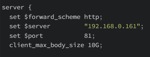

Where do i go, and what file do i edit to increase it's allowed filesize to come through to my server? As i set xbackbone to allow 25GB, but still, i get errors when i try to upload a 2GB file. Read that i'd need to set the amount in nginx as well, but can't figure out where to do that. I added it like this in an attempt, for the xbackbone config within nginx's appdata folder, but didn't help, and still denied me to upload it.
I don't understand what you're trying here. If you have NPM working correctly, any visit to your FQDN should automatically be reritten as HTTPS and use the cert. It doesn't matter if you type http or https or nothing when hitting the site from your browser. NPM is listening on both port 80 (http) and 443 (https).
Do *all* your testing from inside your LAN only. Don't bother trying any connections from the WAN side until you know everything is working 100%
I also strongly recommend closing all incoming ports on your firewall and using Tailscale instead - but just like above, only after making sure everything is 100% inside the LAN.
Edited by Espressomatic
I've got nginx configured properly, for me to be able to access domains from internally, to sites such as sonarr.1234.site, and tower.1234.site, this greatly helps, and is what I wanted to achieve.  What is left for me to do is to access this sites without showing not secure.  This I am still trying to figure out.  I should be generating an SSL cert first right?  To do so, I'm testing server reachability first using both sites above, and I'm getting "Communication with the API failed, is NPM running correctly?"
I am using a firewall.  Do I need to do anything?  Do I have to open any ports for the server reachability to work?
For NPM to be able to get certs 80 and 443 need to be forwarded to it, yes.
AFAIK the server reachability check is broken, don't use it, just do the cert request when set up.

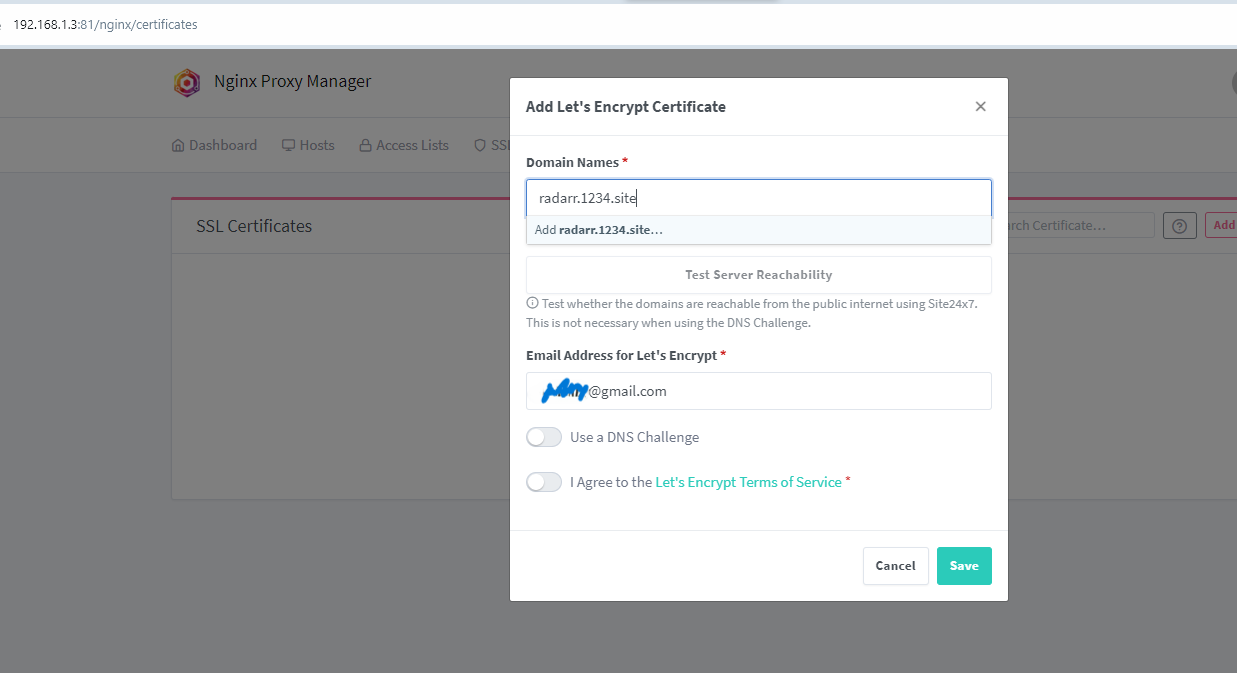

I have Adguard Home (192.168.1.2) and have DNS rewrite *.1234.site to Nginx Proxy Manager (npm, 192.168.1.3).  In npm, I went to add certificate, under domains, I put in *.1234.site, use DNS challenge Cloudflare.  I created a token in Cloudflare before this.  Under DNS of 1234.site, I also put in a CNAME * under name, Target I used something.duckdns.org (this points to my public IP). Proxy status is turned off.
I'm getting this error:
Error: Command failed: . /opt/certbot/bin/activate && pip install --no-cache-dir certbot-dns-cloudflare==$(certbot --version | grep -Eo '[0-9](\.[0-9]+)+') cloudflare && deactivate An unexpected error occurred: ModuleNotFoundError: No module named 'CloudFlare' Ask for help or search for solutions at https://community.letsencrypt.org. See the logfile /tmp/certbot-log-daeijkey/log or re-run Certbot with -v for more details. ERROR: Ignored the following versions that require a different python version: 2.10.0 Requires-Python >=3.8; 2.11.0 Requires-Python >=3.8; 2.8.0 Requires-Python >=3.8; 2.9.0 Requires-Python >=3.8; 3.0.0 Requires-Python >=3.8; 3.0.1 Requires-Python >=3.8 ERROR: Could not find a version that satisfies the requirement certbot-dns-cloudflare== (from versions: 0.14.0.dev0, 0.15.0, 0.16.0, 0.17.0, 0.18.0, 0.18.1, 0.18.2, 0.19.0, 0.20.0, 0.21.0, 0.21.1, 0.22.0, 0.22.1, 0.22.2, 0.23.0, 0.24.0, 0.25.0, 0.25.1, 0.26.0, 0.26.1, 0.27.0, 0.27.1, 0.28.0, 0.29.0, 0.29.1, 0.30.0, 0.30.1, 0.30.2, 0.31.0, 0.32.0, 0.33.0, 0.33.1, 0.34.0, 0.34.1, 0.34.2, 0.35.0, 0.35.1, 0.36.0, 0.37.0, 0.37.1, 0.37.2, 0.38.0, 0.39.0, 0.40.0, 0.40.1, 1.0.0, 1.1.0, 1.2.0, 1.3.0, 1.4.0, 1.5.0, 1.6.0, 1.7.0, 1.8.0, 1.9.0, 1.10.0, 1.10.1, 1.11.0, 1.12.0, 1.13.0, 1.14.0, 1.15.0, 1.16.0, 1.17.0, 1.18.0, 1.19.0, 1.20.0, 1.21.0, 1.22.0, 1.23.0, 1.24.0, 1.25.0, 1.26.0, 1.27.0, 1.28.0, 1.29.0, 1.30.0, 1.31.0, 1.32.0, 2.0.0, 2.1.0, 2.2.0, 2.3.0, 2.4.0, 2.5.0, 2.6.0, 2.7.0, 2.7.1, 2.7.2, 2.7.3, 2.7.4) ERROR: No matching distribution found for certbot-dns-cloudflare== [notice] A new release of pip is available: 23.3.2 -> 24.0 [notice] To update, run: pip install --upgrade pip at ChildProcess.exithandler (node:child_process:402:12) at ChildProcess.emit (node:events:513:28) at maybeClose (node:internal/child_process:1100:16) at Process.ChildProcess._handle.onexit (node:internal/child_process:304:5).
In my firewall, I have http, https pointed to npm (192.168.1.3).  Am I missing something?  I can't get ssl to work.
I saw this on my logs:
[12/2/2024] [11:24:02 AM] [SSL      ] › ✖  error     Error: Command failed: certbot renew --non-interactive --quiet --config "/etc/letsencrypt.ini" --work-dir "/tmp/letsencrypt-lib" --logs-dir "/tmp/letsencrypt-log" --preferred-challenges "dns,http" --disable-hook-validation
P.S.  I also thought test server reachability might be broken.
Edited by jang430
No, this doesn't need to be done to generate certificates and using DNS challenge. And shouldn't be done at all - use Tailscale AFTER setting up NPM locally, including certificates.
