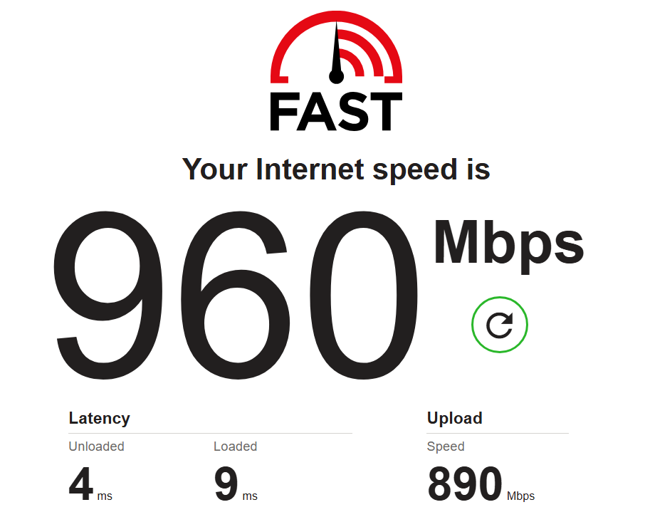

  12. I just wanted to say thank you for this information. I just built a new Unraid server (my 2nd one) and it is my first time using a windows VM in unraid (first server had ubuntu, home assistant, and freePBX VMs). I went from 60 Mbps download using fast.com with frequent timeouts while browsing or logging into apps through MS Edge to 960 Mbps down/ 890 Mbps Up (940 Mbps fiber service). Now I just need to find an updated guide to passthrough my nvme drive to the Windows VM as a boot device and my VM setup will be complete.
