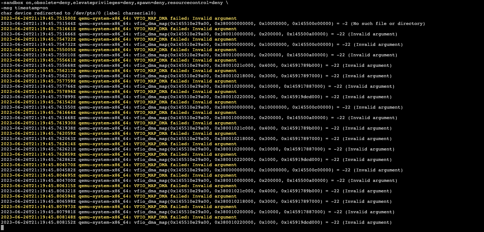

qemu-system-x86_64: VFIO_MAP_DMA failed: Invalid argument
Looking for a push in the right direction. I've had GPU passthrough working for quite a while until today. I swapped GPUs for a bit and reinstalled the original. The GPU i tested sucked so I rolled back to my original, AMD RX570X. I was able to boot a VM successfully once. Now unraid is complaining about VFIO_MAP_DMA failed: Invalid argument
What I've done so far:
Rebooted
Bind/Unbind GPU
Reseated GPU
I've searched a bit but couldn't find a solution to this problem. Any ideas?
I've attached my diagnostics.
Current GPU: AMD RX570x
Error: qemu-system-x86_64: VFIO_MAP_DMA failed: Invalid argument
Unraid 6.12.1
Edit: Attached additional error msg
ashla-234-diagnostics-20230626-1718.zip
Edited by darthkielbasa

I'm passing through an AMD Dell RX570x w/ windows 10. I had a few Linux VMs passing thorugh the same GPU w/ no problem.
I rolled back to 6.11.5 now i'm all good.
It must be a 6.12 bug. Personally it's not causing an issue for me.
Had this issue too in 6.12.1, updating to 6.12.3 fixed it.
Updated aswell, but vm still doesnt work, well it boots and then starts automatic repair, but vfio_map_dma failed is still there

I have the same error message (qemu-system-x86_64: VFIO_MAP_DMA failed: Invalid argument) on my Win11 VM with Nvidia 4070 passthrough. Nothing else passed through. I'm on 6.12.6. However, the VM seems fine, except that recently (and I don't think I changed anything) it pauses (sleeps?) soon after I disconnect my Remote Desktop and today I woke it up but couldn't get back into it from Remote Desktop except via Force Stop and then Start.
Any update on this?

I am on unraid 6.12.6 and am seeing this same error in my windows 11 vm logs when passing through a 3060ti gpu on and Intel 13900k system.  I have the gpu stubbed out and the vm starts but have no idea how to fix the vm so the errors don't occur. @ich777 and @SimonF, I tried the below and it did not resolve the issue, any ideas?

Update:
If I use the commands above and install OVMF for QEMU - edk2-stable202208, the errors in the log go away. I did this working my way back from the newest version and all of the other versions did produce the errors in the log.
Edited by lzrdking71
update
I've been getting these errors for months and have no adverse effects from them minus the errors in the log. My VM is super stable and GPU passthrough works fine.
Using intel i5 13500. Seeing these warnings on both linux and windows vms. GPU pastrough works fine, but my idle power usage on windows is 20w higher than linux, tested with and without GPU, the issue is with CPU.

Ok I installed the edk2 firmware from 6.11.5 as directed above, however I am still getting the same VFIO_MAP_DMA errors. I've attached my diagnostics but the basic situation is I have a 12600k and am trying to pass through the iGPU to a windows 10 VM. I am using the SR-IOV plug in currently under development here. The author of that plug in has said the issue is not related to SR-IOV.
text  error  warn  system  array  login
2024-02-20T05:20:41.404687Z qemu-system-x86_64: vfio_dma_map(0x1483cec48800, 0x381000000000, 0x20000000, 0x1483aca00000) = -22 (Invalid argument)
2024-02-20T05:20:42.966784Z qemu-system-x86_64: VFIO_MAP_DMA failed: Invalid argument
2024-02-20T05:20:42.966833Z qemu-system-x86_64: vfio_dma_map(0x1483cec48800, 0x381000000000, 0x20000000, 0x1483aca00000) = -22 (Invalid argument)
2024-02-20T05:20:43.017611Z qemu-system-x86_64: VFIO_MAP_DMA failed: Invalid argument
2024-02-20T05:20:43.017651Z qemu-system-x86_64: vfio_dma_map(0x1483cec48800, 0x381000000000, 0x20000000, 0x1483aca00000) = -22 (Invalid argument)
2024-02-20T05:20:43.072592Z qemu-system-x86_64: VFIO_MAP_DMA failed: Invalid argument

-blockdev '{"node-name":"libvirt-2-format","read-only":true,"driver":"raw","file":"libvirt-2-storage"}' \
-device '{"driver":"ide-cd","bus":"sata0.0","drive":"libvirt-2-format","id":"sata0-0-0","bootindex":2}' \
-blockdev '{"driver":"file","filename":"/mnt/user/isos/virtio-win-0.1.240-1.iso","node-name":"libvirt-1-storage","auto-read-only":true,"discard":"unmap"}' \
-blockdev '{"node-name":"libvirt-1-format","read-only":true,"driver":"raw","file":"libvirt-1-storage"}' \
-device '{"driver":"ide-cd","bus":"sata0.1","drive":"libvirt-1-format","id":"sata0-0-1"}' \
-netdev tap,fd=36,id=hostnet0 \
-device '{"driver":"virtio-net","netdev":"hostnet0","id":"net0","mac":"52:54:00:73:76:08","bus":"pci.0","addr":"0x2"}' \
-chardev pty,id=charserial0 \
-device '{"driver":"isa-serial","chardev":"charserial0","id":"serial0","index":0}' \
-chardev socket,id=charchannel0,fd=34,server=on,wait=off \
-device '{"driver":"virtserialport","bus":"virtio-serial0.0","nr":1,"chardev":"charchannel0","id":"channel0","name":"org.qemu.guest_agent.0"}' \
-device '{"driver":"usb-tablet","id":"input0","bus":"usb.0","port":"1"}' \
-audiodev '{"id":"audio1","driver":"none"}' \
-device '{"driver":"vfio-pci","host":"0000:00:02.1","id":"hostdev0","bus":"pci.6","addr":"0x10"}' \
-sandbox on,obsolete=deny,elevateprivileges=deny,spawn=deny,resourcecontrol=deny \
-msg timestamp=on
char device redirected to /dev/pts/0 (label charserial0)
2024-02-20T17:54:01.680257Z qemu-system-x86_64: VFIO_MAP_DMA failed: Invalid argument
2024-02-20T17:54:01.687495Z qemu-system-x86_64: vfio_dma_map(0x14f69d048800, 0x381000000000, 0x20000000, 0x14f67ae00000) = -2 (No such file or directory)
2024-02-20T17:54:01.745119Z qemu-system-x86_64: VFIO_MAP_DMA failed: Invalid argument
2024-02-20T17:54:01.745135Z qemu-system-x86_64: vfio_dma_map(0x14f69d048800, 0x381000000000, 0x20000000, 0x14f67ae00000) = -22 (Invalid argument)
2024-02-20T17:54:03.650076Z qemu-system-x86_64: VFIO_MAP_DMA failed: Invalid argument
2024-02-20T17:54:03.650107Z qemu-system-x86_64: vfio_dma_map(0x14f69d048800, 0x381000000000, 0x20000000, 0x14f67ae00000) = -22 (Invalid argument)
2024-02-20T17:54:03.679258Z qemu-system-x86_64: VFIO_MAP_DMA failed: Invalid argument
2024-02-20T17:54:03.679274Z qemu-system-x86_64: vfio_dma_map(0x14f69d048800, 0x381000000000, 0x20000000, 0x14f67ae00000) = -22 (Invalid argument)
2024-02-20T17:54:03.732239Z qemu-system-x86_64: VFIO_MAP_DMA failed: Invalid argument
2024-02-20T17:54:03.732283Z qemu-system-x86_64: vfio_dma_map(0x14f69d048800, 0x381000000000, 0x20000000, 0x14f67ae00000) = -22 (Invalid argument)
2024-02-20T17:54:03.764302Z qemu-system-x86_64: VFIO_MAP_DMA failed: Invalid argument
2024-02-20T17:54:03.764316Z qemu-system-x86_64: vfio_dma_map(0x14f69d048800, 0x381000000000, 0x20000000, 0x14f67ae00000) = -22 (Invalid argument)
2024-02-20T17:54:05.426380Z qemu-system-x86_64: VFIO_MAP_DMA failed: Invalid argument
2024-02-20T17:54:05.426401Z qemu-system-x86_64: vfio_dma_map(0x14f69d048800, 0x381000000000, 0x20000000, 0x14f67ae00000) = -22 (Invalid argument)
hal9000-diagnostics-20240220-0955.zip
