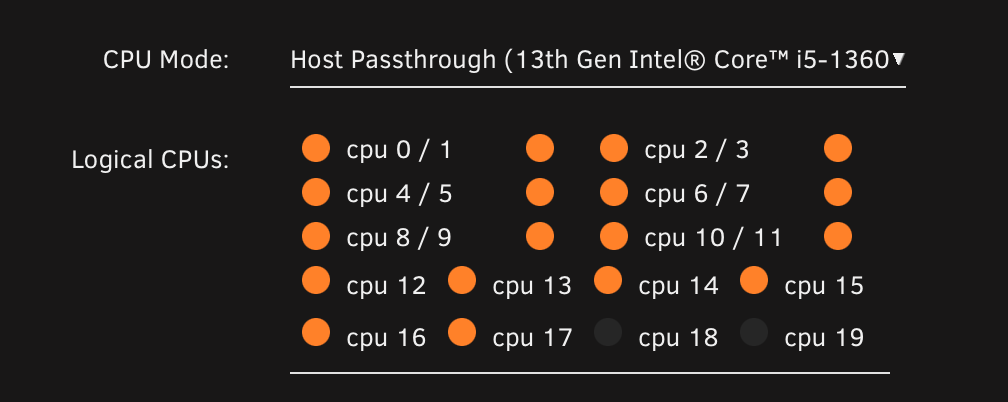

I got the 13600. I have assigned all except the last 2 E-Cores to my gaming VM and it runs flawlessly.

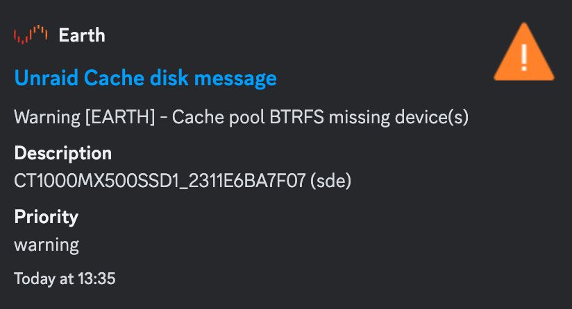

Unfortunately even after replacing the (what I thought) faulty new SSD - the issue is still here. At some point I get a warning about my log being full and I know what this means. Cache issues that flood the logs. Issues are like this: May 25 17:22:05 Earth kernel: BTRFS info (device sdb1): read error corrected: ino 0 off 7569215369216 (dev /dev/sde1 sector 255824472) May 25 19:07:10 Earth kernel: I/O error, dev sdb, sector 517930272 op 0x3:(DISCARD) flags 0x800 phys_seg 1 prio class 0 If I go and perform a Scrub I get millions of uncorrected errors. If I restart the array then one of the 2 cache disks is usually gone (this time it didn't) After the restart docker.img is corrupt and docker cannot start. Previous times libvirt.img was also corrupt. This time it didn't. I changes sata ports, cables, replaced the 1 SSD that was gone after errors and restarts. This is the log I kept CT1000MX500SSD1_2302E69B81B5 (sde) - red cable ------> this one I got replaced CT1000MX500SSD1_2311E6BA7F07 (sde) - red cable / ------> this one is the new ssd in place of the what I thought faulty one CT1000MX500SSD1_2302E69B81AF (sdb) - black cable This is which drive went missing after restarting the array after getting all the BTRFS errors. 10/4 CT1000MX500SSD1_2302E69B81B5 12/4 CT1000MX500SSD1_2302E69B81B5 12/4 CT1000MX500SSD1_2302E69B81AF (pre-clear errors) 22/4 CT1000MX500SSD1_2302E69B81B5 29/4 CT1000MX500SSD1_2302E69B81B5 27/5 CT1000MX500SSD1_2311E6BA7F07 (sde) This is the error I get after I restart the array after syslog is flooded with errors Also attached are diagnostics. So this happens every couple of days and I have to rebuild my docker.img and possibly the libvirt.img. I am lost here, If BTRFS is to blame I could go with an XFS single drive cache but what about redundancy? Any help would be greatly appreciated. Cheers earth-diagnostics-20230527-1332.zip
