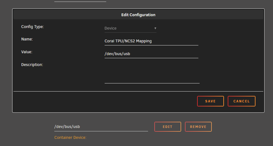

If you want to use a Coral USB TPU module, I got it to work by setting the docker to privileged....adding the device to the template (see screenshot below)....and then downloading the module in the webui. I got the idea from looking at how the Frigate template in CA handles it then doing it the same way.
