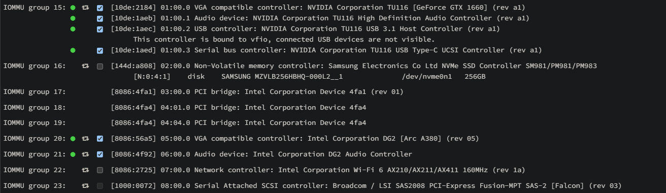

First post here guys, I have been running Unraid for a few months now and it seems stable enough however my VM's no longer run.
Have 2 GPU's in my system;
GTX1660
ARC A380
Setup 2 windows 10VM's - 1 for testing out gaming through parsec on the 1660 and another machine for video transcoding and other basic tasks, minecraft server etc.
Both were working fine, I had bound both IOMMU groups at boot and had the video drivers installed on each machine for both everything was working fine:
For the last few weeks I have been focused on work on not looked at my system to much until a couple of days ago and noticed I could no longer access either machine, after giving up I then tried making new machines and attaching the old disks to the new machines - didnt work.
Then tried completley new machines and new virtual disks, setup the systems with OVMF and Q35 as before and added a virtual GPU as well as a secondery GPU 1660/Arc respectively, machines booted fine, got my drivers installed, shut them down and removed the virtual GPU leaving only the physical card, start them up again and boom - nothing.
Logs are spitting out the below error for 1 machine:

I am now at a loss as to what to try next and hoping you guys could give me some advice,
Aboslutley loving Unraid so far, just seem to have hit a road black now which I cant solve.
Physcially nothing has changed in my system, both cards have HDMI dummy plugs in them if that helps and everything was just working fine until now.
If I have missed any info out just let me know.
