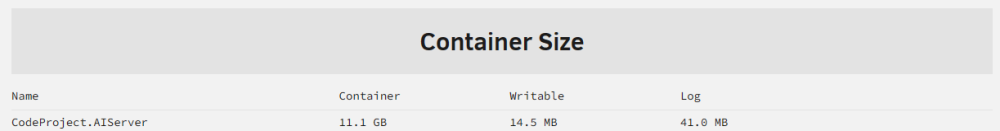

April 11, 20242 yr I am running codeproject/ai-server with the cuda12_2 tag, and it works well. However, I've noticed that the container size is 11.1GB in size, when looking at the docker container size section. Is this normal? Thanks
April 23, 20242 yr Can something assist in helping me set up a 2nd instance of codeproject please? I have tried to add the 2nd instance with different ports/name/appdata name etc. All unique values. But still the data and modules folders are empty on codeproject_ai-2 using 32168 for udp/tcp etc. Even checked in portainer and tried to recreate from there with all 2nd instance unique values. Says up and running but seems to be using the 1st port 32168 and not opening in 32170 for example. Anyone had luck in setting up a 2nd instance? Thanks
May 28, 20242 yr On 4/11/2024 at 5:22 AM, kyoumei said: I am running codeproject/ai-server with the cuda12_2 tag, and it works well. However, I've noticed that the container size is 11.1GB in size, when looking at the docker container size section. Is this normal? Thanks It's a large container. it is normal. On 4/23/2024 at 9:06 AM, only-university6482 said: Can something assist in helping me set up a 2nd instance of codeproject please? I have tried to add the 2nd instance with different ports/name/appdata name etc. All unique values. But still the data and modules folders are empty on codeproject_ai-2 using 32168 for udp/tcp etc. Even checked in portainer and tried to recreate from there with all 2nd instance unique values. Says up and running but seems to be using the 1st port 32168 and not opening in 32170 for example. Anyone had luck in setting up a 2nd instance? Thanks code project will report it is communicating on port 32168, but if you changed the port in the docker edit tab that is the port your unraid machine will be communicating to point to that container. On 3/22/2024 at 11:05 AM, only-university6482 said: For the mesh you'll likely need to change from bridge to a different network. the issue is that the container is on it's own network I havn't tried but host may work. What i did tog et it to work for me was switch to custom network BR0 and gave it a static ip, and had my router assign it the same ip then the mesh worked.

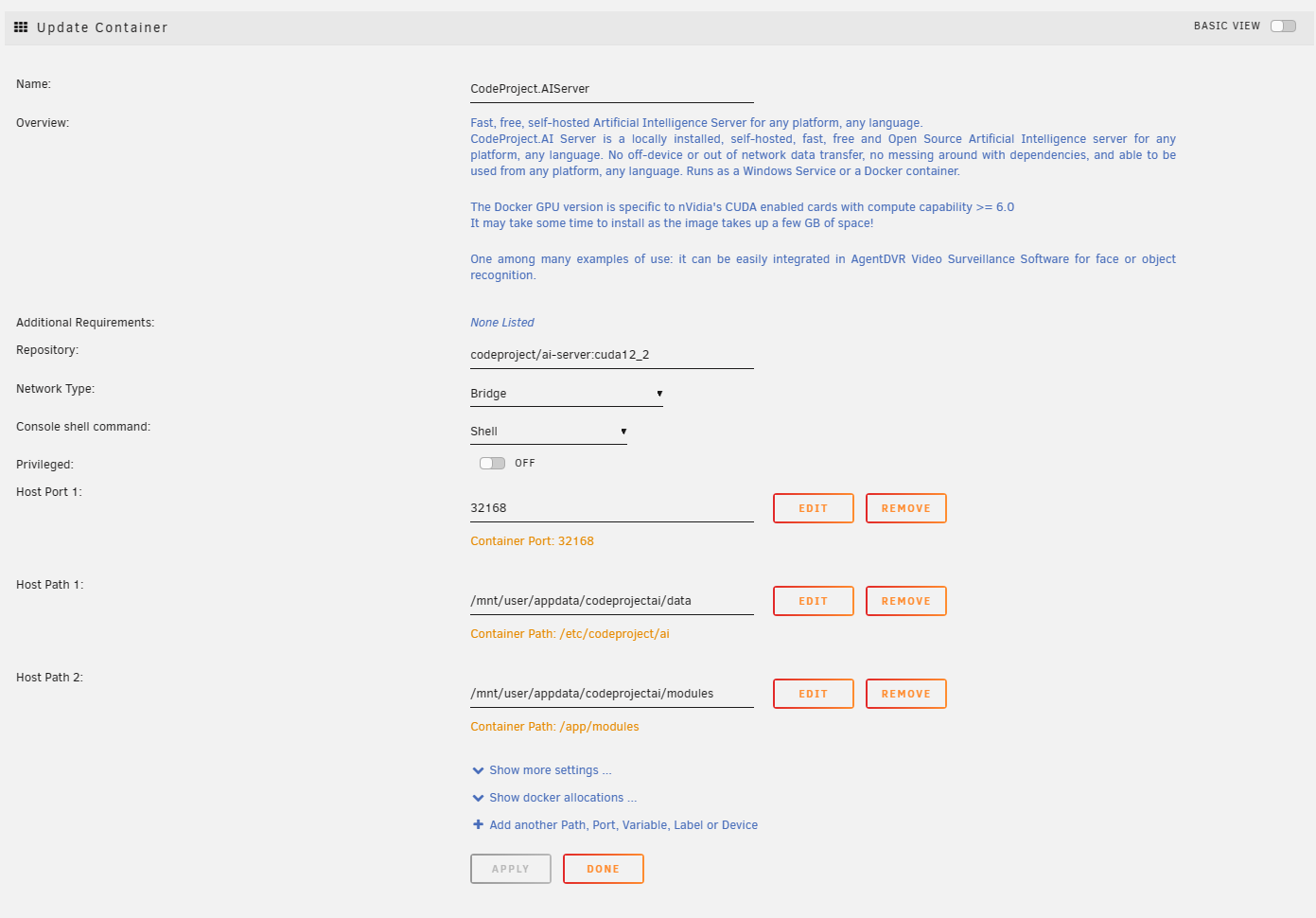

December 10, 20241 yr On 2/23/2024 at 5:02 PM, 5252525111 said: For those running CP.AI using the gpu docker container. It seems like CP hasn't been building it for about 5 months. What you can do is change it to a cuda container and have the latest version. Simply update `codeproject/ai-server:gpu` to one of the following depending on your GPUs capabilities. - `codeproject/ai-server:cuda11_7` - `codeproject/ai-server:cuda12_2` Hi, I'm sorry, I'm not sure what this means. Could someone talk me through what I need to do up upgrade code project ai GPU server to a newer version within a docker in unraid. The version on my system is 2.2.4 beta, and docker says it's up to date. Thanks des

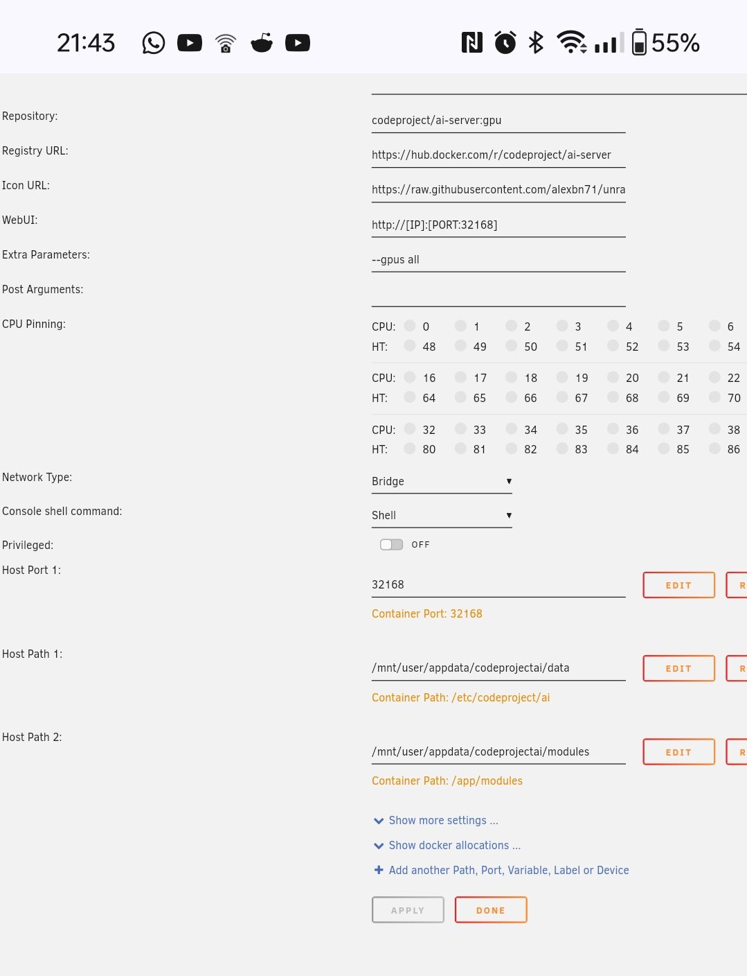

December 15, 20241 yr Sorry for asking silly question guys, but I'm trying to figure this out. The text " Simply update `codeproject/ai-server:gpu` to one of the following depending on your GPUs capabilities. - `codeproject/ai-server:cuda11_7` - `codeproject/ai-server:cuda12_2 " Does it simply mean I edit the container details within docker? At the moment I have the details attached. So change the repository and registry URL to one of the lines above? I currently have a Tesla p4 and also a Nvidia t400, so just want to pass one of these cards through to use. Thanks 👍
December 16, 20241 yr Just closing down my own question for future reference. I used the information here to get my system working. https://www.reddit.com/r/unRAID/s/eGZ03UXtfi Basically use the deep stack template and adjust it for codeProjectAI. That allowed me to point to the cuda version and I can also install extra modules now, so have number plate reading working. Very pleased. Thanks 👍

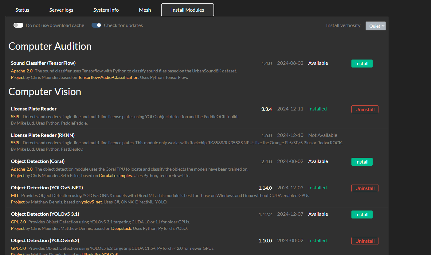

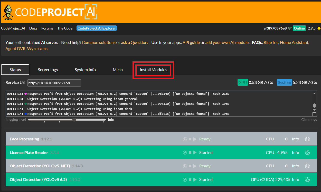

October 5, 2025Oct 5 How do I Add custom modules to Code Project AI? or any modules? I have the docker installed and running, and Blue Iris can communicate, but I'm missing the ALPR module and would like to add it in as well.
October 5, 2025Oct 5 5 hours ago, crusemm said:How do I Add custom modules to Code Project AI? or any modules? I have the docker installed and running, and Blue Iris can communicate, but I'm missing the ALPR module and would like to add it in as well.Access your CP AI IP and Port Then click the appropriate INSTALL for the module you want. Be patient as it takes time. Edited October 5, 2025Oct 5 by kimocal
