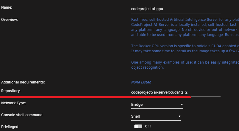

  10. What repo are you using? I am using this one as I have a Tesla P4. Post a pic of your container config to compare.

  13. I'm currently running this container with Repository: codeproject/ai-server:cuda12_2 I have a Tesla P4 installed. Object Detection (YOLOv5 6.2) 1.9.1 is running great with the GPU. Does anybody know how to or if the License Plate Reader module can use the GPU? Every time I try enabling GPU it reverts back to CPU. Also if I update YOLOv5 6.2 to 1.9.2 it seems to break GPU functionality.
