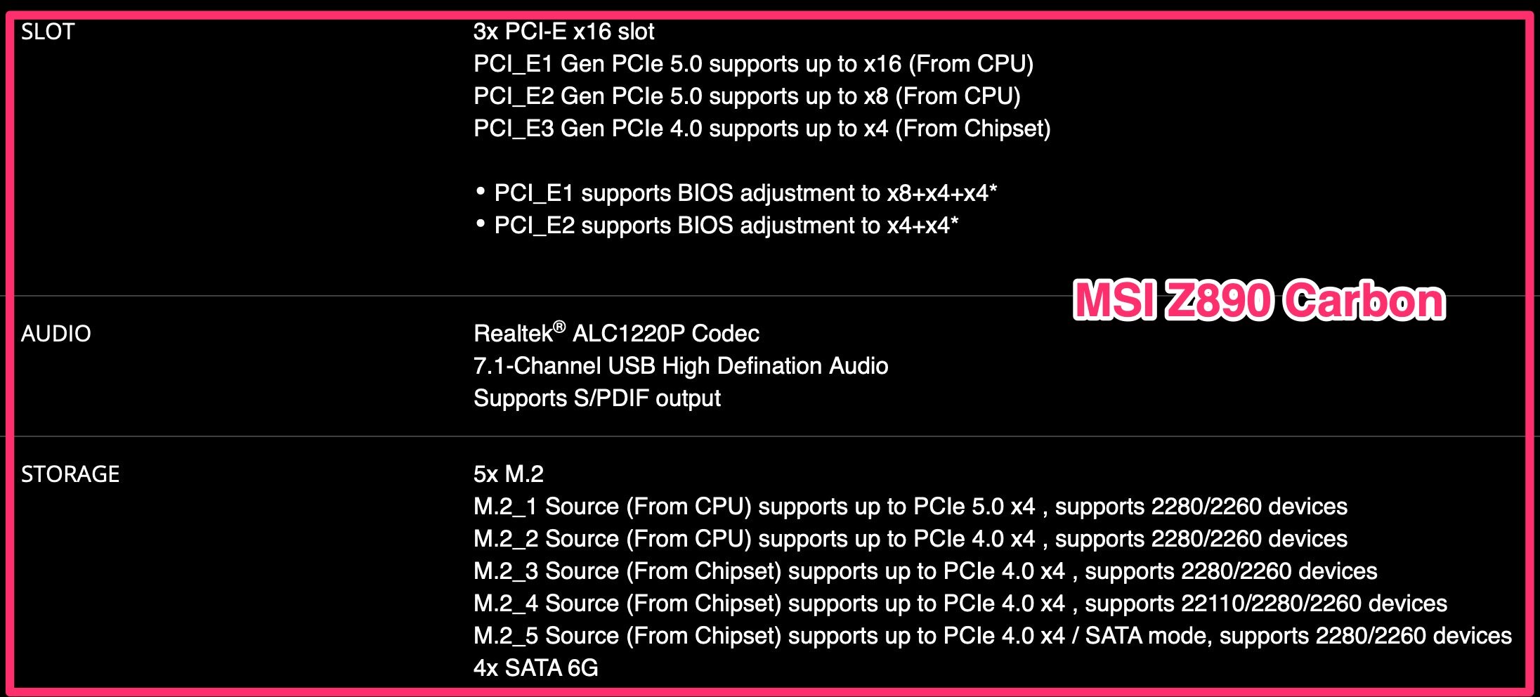

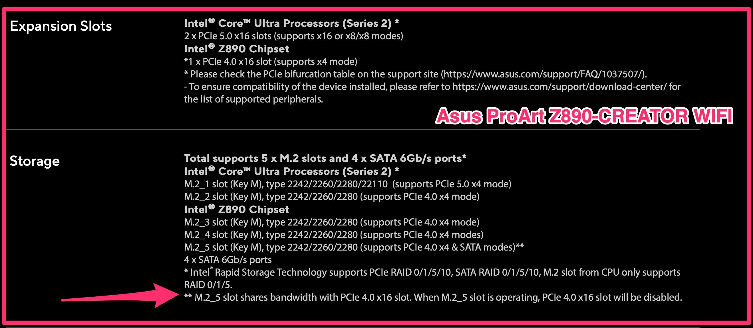

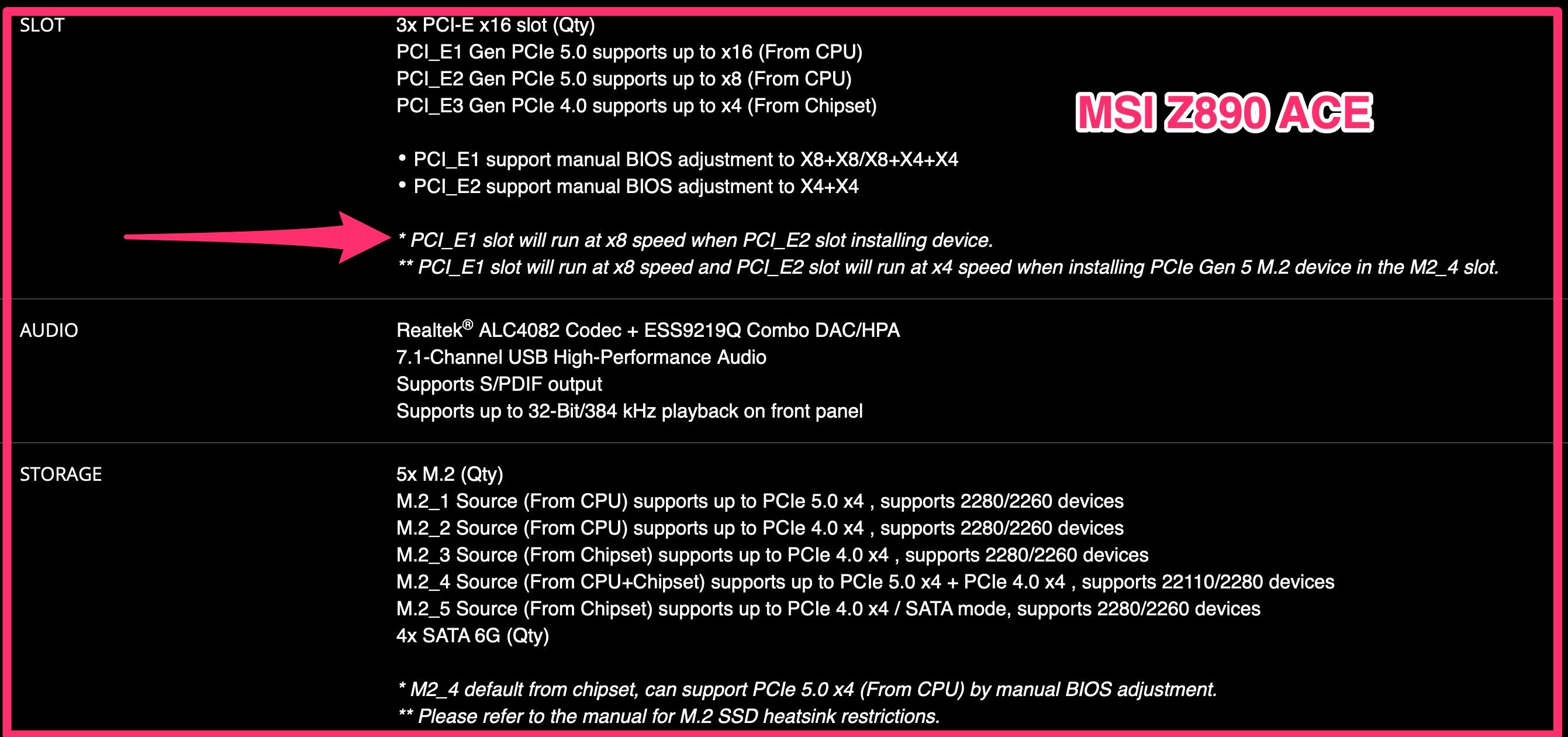

At first I wanted to buy the MSI Z890 ACE motherboard because of the 10 Gbits port. However, the ACE has line sharing for the PCIe card slots, i.e. if all slots are occupied, the lanes in slot 1 are halved (if I have understood this correctly). That's why I've decided in favour of the MSI Z890 Carbon, because there are apparently no restrictions with a full PCIe card configuration (if the official MSI specifications are correct...). But now I still need a solution for the 10 Gbits connection, without a PCIe card and it will probably be this one (should consume little power): IOCREST USB4 Single Port 10G Ethernet Adapter.
By the way, the PCIe line sharing on the Asus ProArt Z890-CREATOR Wifi is even worse, an entire x16 card slot becomes unusable when an SSD is inserted in the M.2_5.
