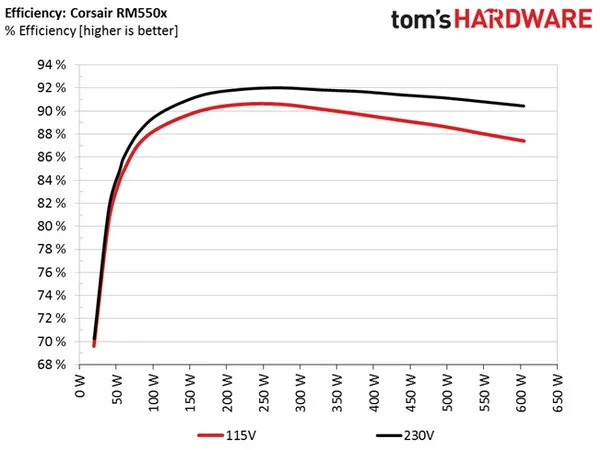

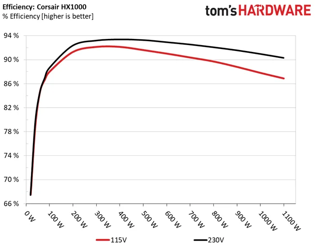

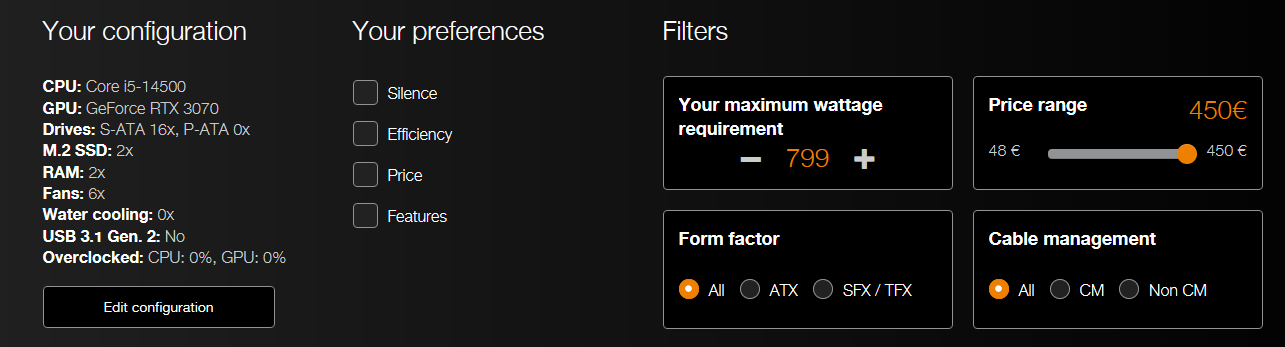

October 28, 20242 yr 22 minutes ago, Gazeley said: power draw from 2 more fans would be negligible correct, two fans only make about 3-5 watts My system runs with 2 front fans, the CPU cooler and a back fan. But I only have 4 HDDs and the NVMe's have a small cooling block. 25 minutes ago, Gazeley said: What PSU size would you recommend? Of course, it really depends on what you ultimately want to do with the system. But 1000W isn't even really worth it if you put an RTX 4090 in it and want to go all-out gaming with it. There are power supply calculators e.g.: https://www.bequiet.com/en/psucalculator Without a graphics card, the typical small power supplies with 550W should be sufficient (e.g. be quiet! Pure Power 11 FM 550W). That also covers a typical server GPU. With a gaming GPU, it just needs a bit more. You can't say in general terms, as everyone uses their server differently. But 1000W just sounds like it's better to have than need. 33 minutes ago, Gazeley said: You lost me here. What is C3? Intel PowerStates. If someone wants to save as much power as possible, it's interesting. There are probably hundreds of posts about it in the forum. If you want to go with Intel, ECC and IPMI, which was also important to me... it doesn't matter to you. All alternative boards are on the same level/power consumption. Someone measured this in a German forum: https://www.hardwareluxx.de/community/threads/vergleich-leistungsaufnahme-ecc-fähiger-lga-1700-mainboards.1339804/

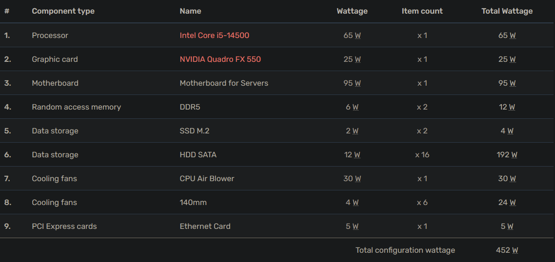

October 28, 20242 yr Author That PSU calculator is very helpful: Looks like 800W would be sufficient (assuming I add a GPU someday). I doubt there would ever be a scenario where all my HDDs are spinning AND I'm maxing out the CPU & GPU at the same time, so realistically I should never hit that max load. So I think 800W would be ok, especially if I don't add a GPU - although I may want to go with 1000W just to be safe, and give me headroom to add something like a RTX 3080 if I want to self-host an LLM or something someday. Either way you're right that 1200W seems to be overkill. Thank you again for taking the time to help!

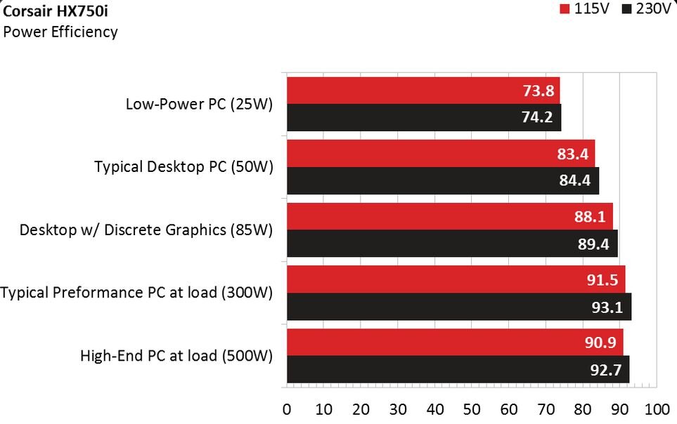

October 28, 20242 yr Author 6 hours ago, enect said: This then causes further unnecessary losses in idle. I did some reading and I understand what you mean here now. I've only ever built gaming PCs where I didn't give a shit about idle power use, so this is all sort of new territory for me. If I'm hoping to have the server idling around 50watts or so, then it would be down at like 78% efficiency most of the time on a 1000W PSU: Whereas if I went with a 750W PSU it would be around 83% efficiency at 50W: Although that only seems to go so far. The low-power efficiency of the RM550x looks equal to, if not worse, than the HX750i above at 50W: Anyway, now I see the reasoning behind going with a lower powered PSU and just upgrading it as needed if I ever do decide to add a GPU. I don't want to be running at a lower efficiency for potentially years and years on the off chance I might add a GPU someday. I ran another calculator and it looks like I could get away with a 550W PSU: But since the HX750i looks more efficient at low loads I think I'll go with that.
October 28, 20242 yr These are exactly the considerations when choosing the right PSU for a server. The Corsair would be a great choice, but you have to get it first. They aren't actually manufactured anymore, as far as I know. There is even a plug-in for the power supply that you can use to display the power consumption in the dashboard. In my humble opinion, you are on the right track and this will certainly be a nice, powerful server with acceptable power consumption. Have fun building it.
October 29, 20242 yr If you can find them, I believe the 750w seasonic titanium rated PSU is among the better ones sort-of still available at low power levels, and the 850 only slightly behind. Also top tier supplies. You will spin up all the drives at the same time at boot. For power efficiency, consider sticking with intel x710 family SFP+/10g. Well priced on the used market. May not be significant with what is noted about c states here though. Also evaluate whether you need that HBA card or can get away with onboard SATA and a more boring sata adapter or two - it may also keep power consumption down. I use a 6-port asm1166 m.2 adapter and shaved over 10w vs 8 port 9200-8i, no observed loss in throughput. Only 5 spinners for me, but 5 SSD for file shares (1 is just music for my squeezeserver, 4 are raid10 for array write cache and active/fast shares. Shares are backed up to the array still (plus more layers of backup)
October 29, 20242 yr Author 1 hour ago, _cjd_ said: I believe the 750w seasonic titanium rated PSU is among the better ones sort-of still available at low power levels, and the 850 only slightly behind. Also top tier supplies. Wow you aren't kidding, the Seasonic Prime 750 Titanium appears to have amazing efficiency! Looks like I can still get them new from eBay or refurbished from Newegg. Changed my PSU out to that on the build list. 1 hour ago, _cjd_ said: For power efficiency, consider sticking with intel x710 family SFP+/10g. Well priced on the used market. Smallest I can find in that family is this Intel X710-DA2 with dual ports. You think that would still be more power efficient than something like this (Intel 82599EN) with a single port? 1 hour ago, _cjd_ said: Also evaluate whether you need that HBA card or can get away with onboard SATA and a more boring sata adapter or two - it may also keep power consumption down. I'll look into the motherboard specs and consider that. Thanks for the tip! Edited October 29, 20242 yr by Gazeley

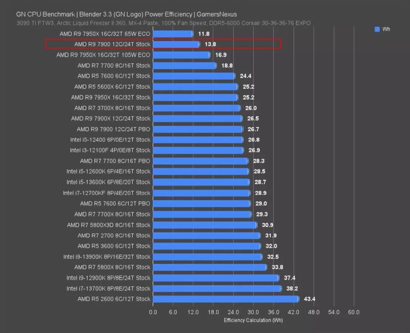

October 30, 20242 yr Author I posted a thread over on level1techs and got some great feedback. Made the following changes per their suggestions: i5-14500 changed to Ryzen 9 7900 (They convinced me that a Ryzen 7900 + GPU is better bang for my buck and has more ECC mobo options.) Noctua DH-D12L changed to BeQuiet! Dark Rock Elite (Better cooling and quieter.) ASUS Pro WS W680-ACE changed to a ASUS ProArt X670E-CREATOR (AM5 Socket, ECC Support) Samsung SSDs changed to WD Black SSDs (Apparently Samsung has had some firmware issues with recent SSDs.) Seasonic TX 750 changed to FSP Hydro Ti Pro 1000W Titanium (Better efficiency in general, but particularly in the 20-80W range.) TRENDnet 10G SFP+ changed to Intel X710-DA2 Dual 10Gbps SFP+ (Better/newer NIC) This means I'll have to add a GPU for Plex transcoding. Looks like the RTX 3060 (w/ 12GB RAM) can handle ten 4K to 1080p transcodes, so that's currently my top contender. Edited October 30, 20242 yr by Gazeley
October 31, 20242 yr Losing the Intel for transcoding may not be worth the trade, especially looking at power efficiency. Then again, it may be you'd need separate graphics for 6 transcode streams anyway. Not sure as that's not something I deal with. And I say that as someone who would only reluctantly buy Intel (CPU - no one better for network cards)
October 31, 20242 yr Author 1 hour ago, _cjd_ said: Losing the Intel for transcoding may not be worth the trade, especially looking at power efficiency. Yeah I've been agonizing over that, but a few things are swaying me: 1) I've been warned I could run into "fun and interesting" performance characteristics with Intel's P and E-cores, which aren't always handled well in schedulers other than Windows (for now at least). 2) The R9 7900 looks pretty power efficient : 3) Adding a GPU doesn't seem like it will add that much to my idle power draw. According to SpaceInvaderOne it's possible to get a GTX 3080 down to ~8 watts on idle: 4) The R9-7900 is a much faster CPU. My biggest hesitation is I assume the R9-7900 will have significantly higher idle power draw than a i5-14500 would. I can't find solid #s on that yet, but that will either solidify my decision or pull me back onto the fence. ----------------------------------------------- EDIT: Found this thread which concludes: Quote "a System for Ryzen 7000 series float around 70~80w while some results showed they can go as high as 100w during idle, whereas Intel Alder Lake and Raptor Lake system could go as low as 60w." They also mention: Quote "all 7000 series in this test were paired with a very high end power hungry X670 Extreme chipset" 🙁 Ugh I just don't know what to do. I wish Intel didn't have the microcode issues with their 13th/14th gen which limits me to the older/lower-end stuff if I want to avoid it. I wish the new Arrow Lake was more of a slam dunk regarding idle power efficiency. I wish AMD had better video transcoding. I wish ECC-capable motherboards were easier to find. Sorry to vent. I've spent too much time obsessing over this and need sleep. Edited October 31, 20242 yr by Gazeley
