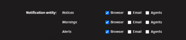

I recently had my server offline for a while (~5 months) due to some technical issues and updated from 7.0 -> 7.1.4 when I was able to get it back online. Since it was so long since I had the server on, I was giving it a bit of a configuration cleaning; going through all the options to make sure things are set up correctly after the gap in updates.
When I went in the Notifications Settings (Settings -> User Preferences -> Notification Settings), I noticed that the Join agent I am using was no longer listed as an option. Since I had this agent configured before it was removed somewhere along the line, I am still getting notifications via this agent with my previous settings intact and valid (/boot/config/plugins/dynamix/notifications/agents/Join.sh). I did a search on the Unraid forum and Unraid OS change logs to see when this feature was depreciated, but I could not find anything referencing Join.
Does anyone have any ideas on why this agent was removed? Was there something malicious I should be worried about?

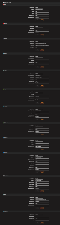

Please post a diag file...
Unless you added custom adational agent html config files. I don't recognize that notfication agent "JOIN" nor have I seen that agent on Unraid natively.
These are the current notification agents on unriad 7.1.4: https://github.com/unraid/webgui/tree/master/emhttp/plugins/dynamix/agents
What you may have may be a old agent from v5 or older or a depriacted plugin... Regardless this tell me that you have a custom html page that is rendering apart of the dynmax webui system.
I would first think that you have a docker running join-bot:
or an additional plugin like(simlar example):
https://forums.unraid.net/topic/168775-plugin-web-push-notification-agent/
https://github.com/Peuuuur-Noel/unraid-web-push-notification
that may be adding other agents.
I'm alos not finding the doc and other notification information so a agent change may have happened

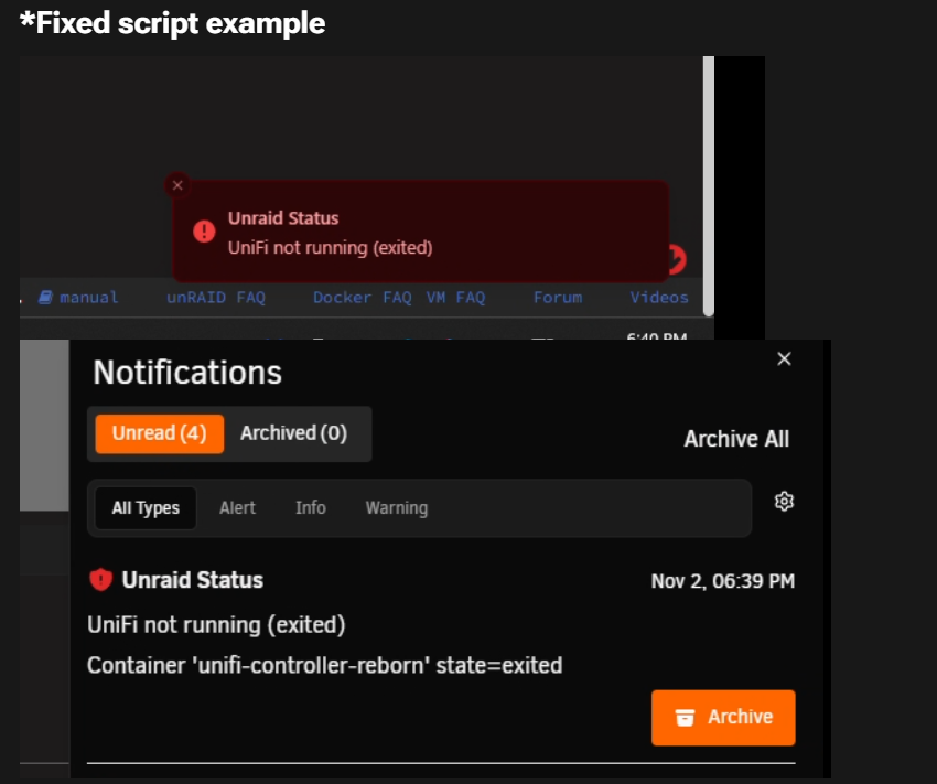

so My 2 blocks currently are:
I'm just not sure how nor what the notify system did to grab to then send to the agent to make its message...
I'm not going to be able to m,ake a plugin to share once configured.. I'm more then happy to work thoguh iissuesand help script a way around this.
as example here:
https://forums.unraid.net/topic/194631-plugin-or-script-that-can-function-as-a-docker-watchdog/#findComment-1587981
I'm not sure where nor how to tap unraid notfication to generate the message to the join api...
where I could edit the docker name set the words "unifi" on the message to container name var at the top and make notifications.
where this agent would somehow intercept and take that message and send it to xyz message over join...
So its a bit over my head as I don't know what this agen did nor how to workaround fix.

Install & test...
  1. Install the plugin
  • Copy join-agent.plg to /boot/config/plugins/join-agent.plg.
  • From Unraid:
    • Plugins → Install Plugin → Install from disk, select the file; or
    • SSH: installplg /boot/config/plugins/join-agent.plg
  1. Configure
  • Go to Settings → Notifications → Agents → Join.
  • Paste your API Key.
  • Leave Device Id as group.all or set a specific deviceId.
  • (Optional) Tweak Title/Message fields—defaults already expand $SUBJECT, $DESCRIPTION, $CONTENT, $LINK.
  1. Send a test
  • Click Notifications → Test (or):
/usr/local/emhttp/webGui/scripts/notify \
  -e "Join Test" -s "Unraid → Join
" \ -d "This is a test notification from $(hostname)." \ -m "Body via CONTENT" -i "warning" -l "/Dashboard"
If anything fails, check:
/var/log/notify_Join
Please test...
