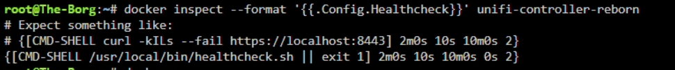

then use a docker inspect command to the docker name:
docker inspect --format '{{.Config.Healthcheck}}' unifi-controller-reborn
# Expect something like:
# {[CMD-SHELL curl -kILs --fail https://localhost:8443] 2m0s 10s 10m0s 2}

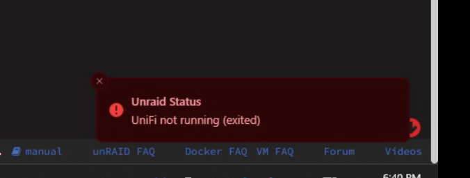

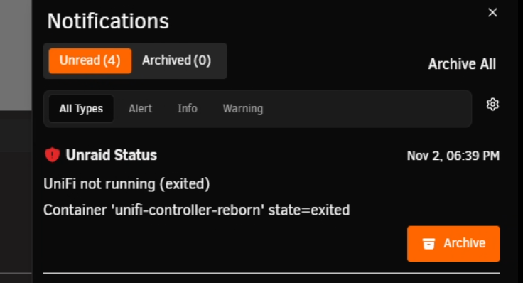

example unraid notfication (if you setup the agents for email, telgram/slac/discord to notfiy you of xyz...
et’s keep UniFi’s built-in HEALTHCHECK and add a User Scripts job that watches Docker’s view of the container and fires an Unraid notification only when something changes (down/unhealthy/recovered). No Pi file—just native notify. (all on unraid....)
Unraid User Script — unifi-health-notify.sh
Paste this into Plugins → User Scripts → Add New Script:

# 3) status/health/age
STATUS="$(docker inspect -f '{{.State.Status}}' "$CONTAINER_NAME" 2>/dev/null || echo unknown)"
HEALTH="$(docker inspect -f '{{if .State.Health}}{{.State.Health.Status}}{{else}}none{{end}}' "$CONTAINER_NAME" 2>/dev/null || echo none)"

  unhealthy)
    notify_alert "UniFi UNHEALTHY" \
"health=unhealthy
Uptime: ${AGE}s
Last health output: ${LAST_OUT}"
  status_*)
    notify_alert "UniFi not running (${STATUS})" \
"Container '${CONTAINER_NAME}' state=${STATUS}
Last health: ${HEALTH}
Uptime: ${AGE}s since ${STARTED_AT}"
  nohealth_running)
    # This image normally *has* a healthcheck; if not, warn each run
    notify_warning "UniFi running (no healthcheck)" \
"Container is running but has no Health object.
State=${STATUS}"

then your setting>notfication can alert you... and you can see a history of its health over time in unraid...
