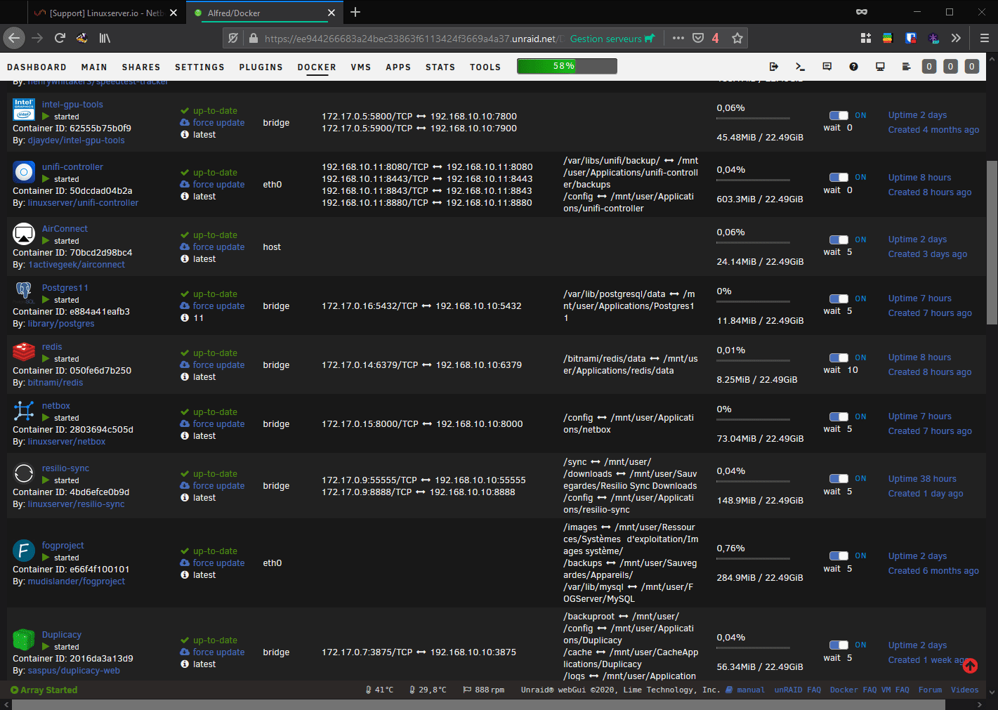

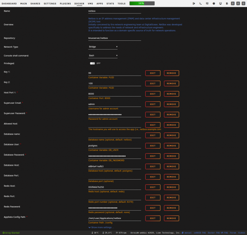

I'm also having that issue despite having a PostgreSQL and a Redis server container ready and I'm not sure how to resolve it.
Although, the one thing that confuses me is how it's trying to connect to a server with the hostname « redis » while I actually supplied a REDIS_HOST that's way different than this. I also tried with an IP address but it's still looking for « redis »...
It's also throwing Python exceptions at me in the logs which is probably part of the cause of the container not functioning but I have a hard time understanding them. So, I'd like some help on that too, please. 😅
Please find the current state of the Netbox container log and a screenshot of the current configuration for it attached.
You have not supplied the correct IP or hostname for either redis or postgres. Not sure what you have entered as host for those two fields.
Well, that's weird because that's exactly what I've done : Supplying the actual hostname (or even the IP address as I mentioned in your quote). 🤔
Maybe you missed part of my message because I already assessed the IP possibility.
But just for re-checking what I said previously, I entered the IP address instead and I got exactly the same result where the container still looks for something else than what I said. You will find attached a screenshot of the configuration using IP addresses instead and also another copy of the container's logs following that configuration using IP addresses where it still wants to talk to « redis » instead of what I actually supplied (172.17.0.14).
Also, for the sake of answering you correctly, what you see in the screenshot that I put as the Redis server and the PostgreSQL server are the identifiers of the two containers respectively. They show up as that hostname when checked from inside the containers. Attached is a GIF that shows how I get them from the consoles.
netbox.log
You should use the unraid IP and not the internal docker IP as they change. Also, if you want to use host names, the containers need to be on a custom bridge and you use the container name.
Do you use the standard ports or have you changed them? Try setting them to the ports you use for the postgres and redis instead of blank.
It's much easier if you supply the docker run command instead of screenshots.

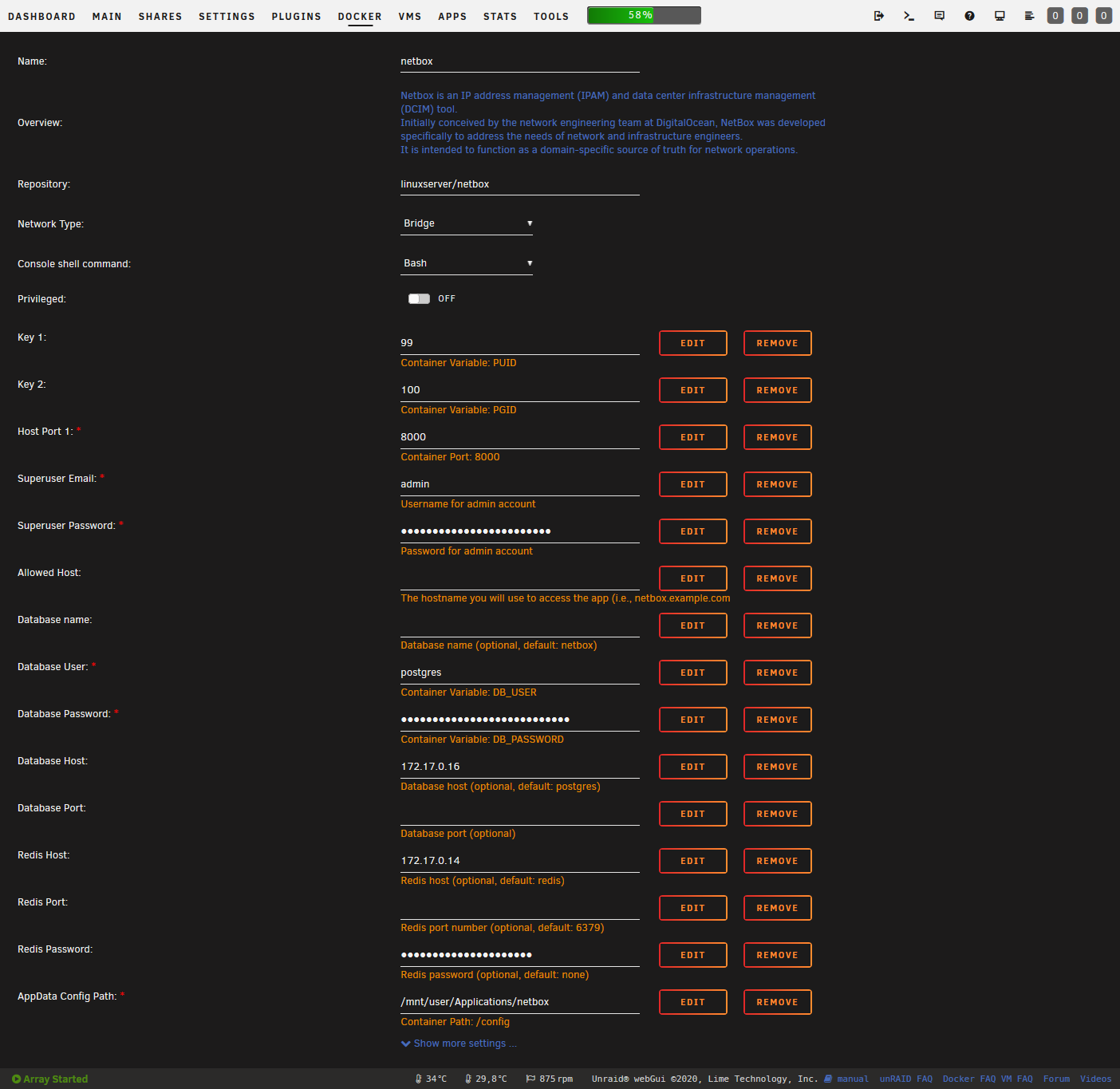

Sorry about the assle with the screenshots. I didn't know it was possible to extract docker run commands from the configuration done inside the unRAID interface...but I can't find how to do that. How is it done?
Edited by campfred
That's not the current version of the message I posted. (Form issue?)
While my searches on doing that didn't give me a meaningful answer so far, I although found the location of the configuration files (or user template files actually).
So, have attached the current state of the container template for Netbox where I've put in the host's IP address instead as suggested and the log from the container where it is still looking for a « redis » hostname instead.
Oh, and sorry for forgetting to respond about the ports, I do use the standard ports. I can give the container template files for both of them too if you want to check them out.
my-netbox.xml netbox.log
How to get the docker run command is in the docker faq stickied in this subforum.
You change something in the template and change it back, then you hit apply, and in the popup you have the docker run command.
Post all 3 commands and also set the ports in the netbox template as I asked you to in my previous post. And set the IP to the correct one.

1 hour ago, campfred said:
Sorry for missing out on that. I never checked on that window that appears. I always just ran it and went to other things while it was working on the server and come back on the web panel to check on things through the logs.
Also, sorry for missing the sticky posts. My screen reader just goes past them and I have no idea as to why it skips these items in the posts table, so I never have been aware they were there. My apologies.
Here are the command equivalent to the deployment of the containers so far!
docker run -d --name='Postgres11' --net='bridge' -e TZ="America/New_York" -e HOST_OS="Unraid" -e 'POSTGRES_PASSWORD'='//REDACTED//' -e 'POSTGRES_USER'='postgres' -e 'POSTGRES_DB'='postgres' -p '5432:5432/tcp' -v '/mnt/user/Applications/Postgres11':'/var/lib/postgresql/data':'rw' 'postgres:11' f8adc057221fdd1ff0b1a101899abfd73a3b956894a4057219a7184a58597fc4
docker run -d --name='redis' --net='bridge' -e TZ="America/New_York" -e HOST_OS="Unraid" -e 'ALLOW_EMPTY_PASSWORD'='no' -e 'REDIS_PASSWORD'='//REDACTED//' -e 'REDIS_AOF_ENABLED'='yes' -p '6379:6379/tcp' -v '/mnt/user/Applications/redis/data':'/bitnami/redis/data':'rw' 'bitnami/redis:latest' ba73d23de343538c1b5cd900c98e254af20bdb0dfef2d177175960b46dcb6c95
docker run -d --name='netbox' --net='bridge' -e TZ="America/New_York" -e HOST_OS="Unraid" -e 'PUID'='99' -e 'PGID'='100' -e 'SUPERUSER_EMAIL'='admin' -e 'SUPERUSER_PASSWORD'='//REDACTED//' -e 'ALLOWED_HOST'='' -e 'DB_NAME'='' -e 'DB_USER'='postgres' -e 'DB_PASSWORD'='//REDACTED//' -e 'DB_HOST'='192.168.10.10' -e 'DB_PORT'='' -e 'REDIS_HOST'='192.168.10.10' -e 'REDIS_PORT'='' -e 'REDIS_PASSWORD'='//REDACTED//' -p '8000:8000/tcp' -v '/mnt/user/Applications/netbox':'/config':'rw' 'linuxserver/netbox' 7f755b848a9c09526dce30a1b5673e22971a9b963d7b7c10943f533d06a707fc
Set the ports in the netbox template and also the DB name.
If that doesn't work, try deleting /mnt/user/Applications/netbox and change something in the template and change back and hit apply.
Alright. 'Done it but I still get the exceptions and it's still looking for the « redis » hostname...
Commands :
docker run -d --name='Postgres11Netbox' --net='bridge' -e TZ="America/New_York" -e HOST_OS="Unraid" -e 'POSTGRES_PASSWORD'='(ThePassword)' -e 'POSTGRES_USER'='postgres' -e 'POSTGRES_DB'='Netbox' -p '5432:5432/tcp' -v '/mnt/user/Applications/Postgres11':'/var/lib/postgresql/data':'rw' 'postgres:11'
docker run -d --name='redis' --net='bridge' -e TZ="America/New_York" -e HOST_OS="Unraid" -e 'ALLOW_EMPTY_PASSWORD'='no' -e 'REDIS_PASSWORD'='(ThePassword)' -e 'REDIS_AOF_ENABLED'='yes' -p '6379:6379/tcp' -v '/mnt/user/Applications/redis/data':'/bitnami/redis/data':'rw' 'bitnami/redis:latest'
docker run -d --name='netbox' --net='bridge' -e TZ="America/New_York" -e HOST_OS="Unraid" -e 'PUID'='99' -e 'PGID'='100' -e 'SUPERUSER_EMAIL'='admin' -e 'SUPERUSER_PASSWORD'='(ThePassword)' -e 'ALLOWED_HOST'='' -e 'DB_NAME'='Netbox' -e 'DB_USER'='postgres' -e 'DB_PASSWORD'='(ThePassword)' -e 'DB_HOST'='192.168.10.10' -e 'DB_PORT'='5432' -e 'REDIS_HOST'='192.168.10.10' -e 'REDIS_PORT'='6379' -e 'REDIS_PASSWORD'='(ThePassword)' -p '8000:8000/tcp' -v '/mnt/user/Applications/netbox':'/config':'rw' 'linuxserver/netbox'
Of course, you'll find the container's log attached.
netbox.log
