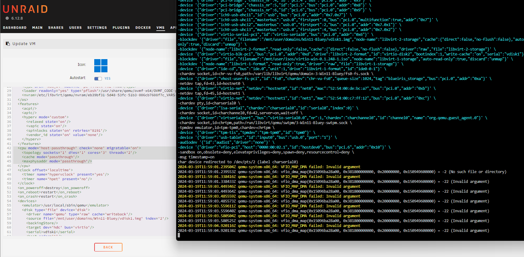

2024-02-20T20:13:31.598676Z qemu-system-x86_64: VFIO_MAP_DMA failed: Invalid argument
2024-02-20T20:13:31.598726Z qemu-system-x86_64: vfio_dma_map(0x1533b5448800, 0x381000000000, 0x20000000, 0x153393200000) = -2 (No such file or directory)
2024-02-20T20:13:31.649529Z qemu-system-x86_64: VFIO_MAP_DMA failed: Invalid argument
2024-02-20T20:13:31.649545Z qemu-system-x86_64: vfio_dma_map(0x1533b5448800, 0x381000000000, 0x20000000, 0x153393200000) = -22 (Invalid argument)
2024-02-20T20:13:36.144856Z qemu-system-x86_64: VFIO_MAP_DMA failed: Invalid argument
2024-02-20T20:13:36.144938Z qemu-system-x86_64: vfio_dma_map(0x1533b5448800, 0x381000000000, 0x20000000, 0x153393200000) = -22 (Invalid argument)
2024-02-20T20:13:36.197494Z qemu-system-x86_64: VFIO_MAP_DMA failed: Invalid argument
2024-02-20T20:13:36.197533Z qemu-system-x86_64: vfio_dma_map(0x1533b5448800, 0x381000000000, 0x20000000, 0x153393200000) = -22 (Invalid argument)
2024-02-20T20:13:36.252206Z qemu-system-x86_64: VFIO_MAP_DMA failed: Invalid argument
2024-02-20T20:13:36.252249Z qemu-system-x86_64: vfio_dma_map(0x1533b5448800, 0x381000000000, 0x20000000, 0x153393200000) = -22 (Invalid argument)
2024-02-20T20:13:36.283888Z qemu-system-x86_64: VFIO_MAP_DMA failed: Invalid argument
2024-02-20T20:13:36.283912Z qemu-system-x86_64: vfio_dma_map(0x1533b5448800, 0x381000000000, 0x20000000, 0x153393200000) = -22 (Invalid argument)
2024-02-20T20:13:38.413536Z qemu-system-x86_64: VFIO_MAP_DMA failed: Invalid argument
2024-02-20T20:13:38.413555Z qemu-system-x86_64: vfio_dma_map(0x1533b5448800, 0x381000000000, 0x20000000, 0x153393200000) = -22 (Invalid argument)
hal9000-diagnostics-20240220-1224.zip

-device '{"driver":"vfio-pci","host":"0000:00:02.1","id":"hostdev0","bus":"pci.6","addr":"0x10"}' \
-sandbox on,obsolete=deny,elevateprivileges=deny,spawn=deny,resourcecontrol=deny \
-msg timestamp=on
char device redirected to /dev/pts/0 (label charserial0)
Looking at your XML, it looks correct.
<hostdev mode="subsystem" type="pci" managed="yes">
<driver name="vfio"/>
<source>
<address domain="0x0000" bus="0x00" slot="0x02" function="0x2"/>
</source>
<address type="pci" domain="0x0000" bus="0x06" slot="0x10" function="0x0"/>
</hostdev>
<memballoon model="none"/>
</devices>
also using the correct lines in the qemu command. But looks like it is missing a find, Have you raised an issue on github for the dev.  I don't enough about the srvio process.
-device '{"driver":"vfio-pci","host":"0000:00:02.2","id":"hostdev0","bus":"pci.6","addr":"0x10"}' \
-msg timestamp=on
2024-02-20T20:21:59.338500Z qemu-system-x86_64: VFIO_MAP_DMA failed: Invalid argument
2024-02-20T20:21:59.338541Z qemu-system-x86_64: vfio_dma_map(0x14c496248800, 0x381800000000, 0x20000000, 0x14c474000000) = -2 (No such file or directory)

Not sure if you want to test to see if this stops the error? You cannt use limit= on 6.12.8 thou. I have tested my VM runs with the new settings seems to remain persistant. But dont have the error to see if this fixes.
https://github.com/tianocore/edk2/discussions/4662
    <topology sockets='1' dies='1' cores='1' threads='2'/>
    <cache mode='passthrough'/>
    <maxphysaddr mode='passthrough'/>
  </cpu>
  </cpu>
Hey,
I have been getting the errors too. I found my way to this thread via the intel-igpu-sr-iov page
I still get the errors trying this fix
2024-05-07T15:15:00.263790Z qemu-system-x86_64: VFIO_MAP_DMA failed: Invalid argument
2024-05-07T15:15:00.263827Z qemu-system-x86_64: vfio_dma_map(0x146231aa2000, 0x380000000000, 0x400000000, 0x145e30400000) = -2 (No such file or directory)
2024-05-07T15:15:00.265299Z qemu-system-x86_64: VFIO_MAP_DMA failed: Invalid argument
2024-05-07T15:15:00.265304Z qemu-system-x86_64: vfio_dma_map(0x146231aa2000, 0x380400000000, 0x2000000, 0x145e2da00000) = -22 (Invalid argument)
I had the same problem again. it seems after i stop my VM and try to start it again. it gives that error. When i restart my whole server. the VM works again as long as it keeps running.

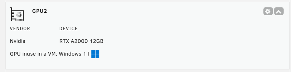

Hello,
I hope everyone is doing well!
I am currently experiencing the same error with my Nvidia RTX A2000.
Has anyone solved the issue, and are there any recommendations? 🤞
Please find the information below:
1.   Error code:
2025-02-03T12:03:08.605185Z qemu-system-x86_64: VFIO_MAP_DMA failed: Invalid argument
2025-02-03T12:03:08.605205Z qemu-system-x86_64: vfio_container_dma_map(0x55e9884c7260, 0x383800000000, 0x200000000, 0x154a3b000000) = -22 (Invalid argument)
2025-02-03T12:03:08.606773Z qemu-system-x86_64: VFIO_MAP_DMA failed: Invalid argument
2025-02-03T12:03:08.606787Z qemu-system-x86_64: vfio_container_dma_map(0x55e9884c7260, 0x383a00000000, 0x2000000, 0x154a39000000) = -22

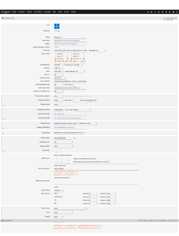

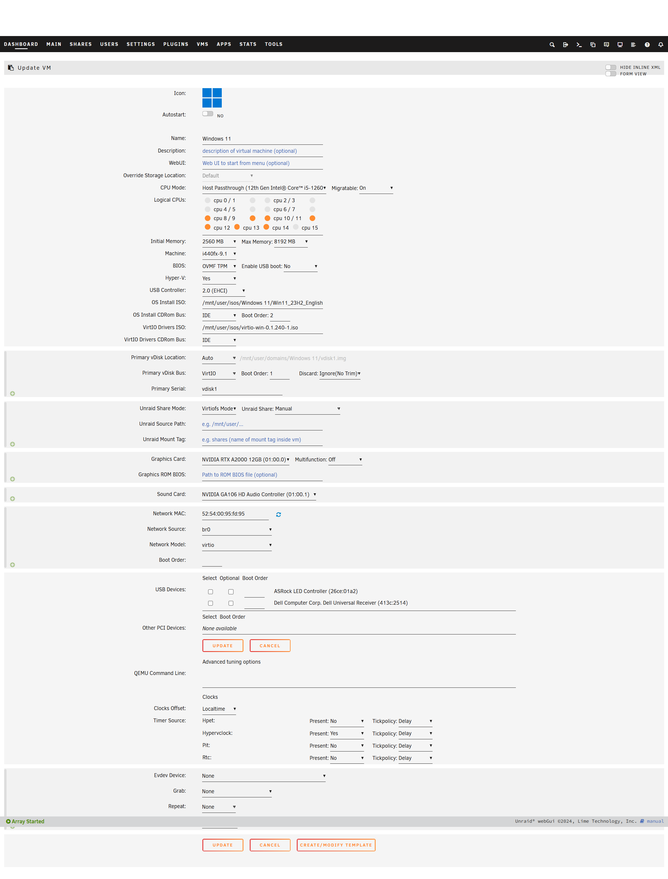

2.    I also checked that the graphic and sound cards are grouped together and utilised in the VM (I tried binding and unbinding, and it didn't make a difference). Please see below:
3.  I changed the PCIe ACS override in all states (disabled, downstream, multi-function, and both), but nothing changed.
4.  I also checked:
IOMMU: Enabled
Resizable BAR and Above 4G Decoding: Enabled
VT-d: Enabled
5. I attempted to grab the vbios of the GPU and boot from it, but nothing made a difference.
6.  The VM template is the following:
Thanks!
