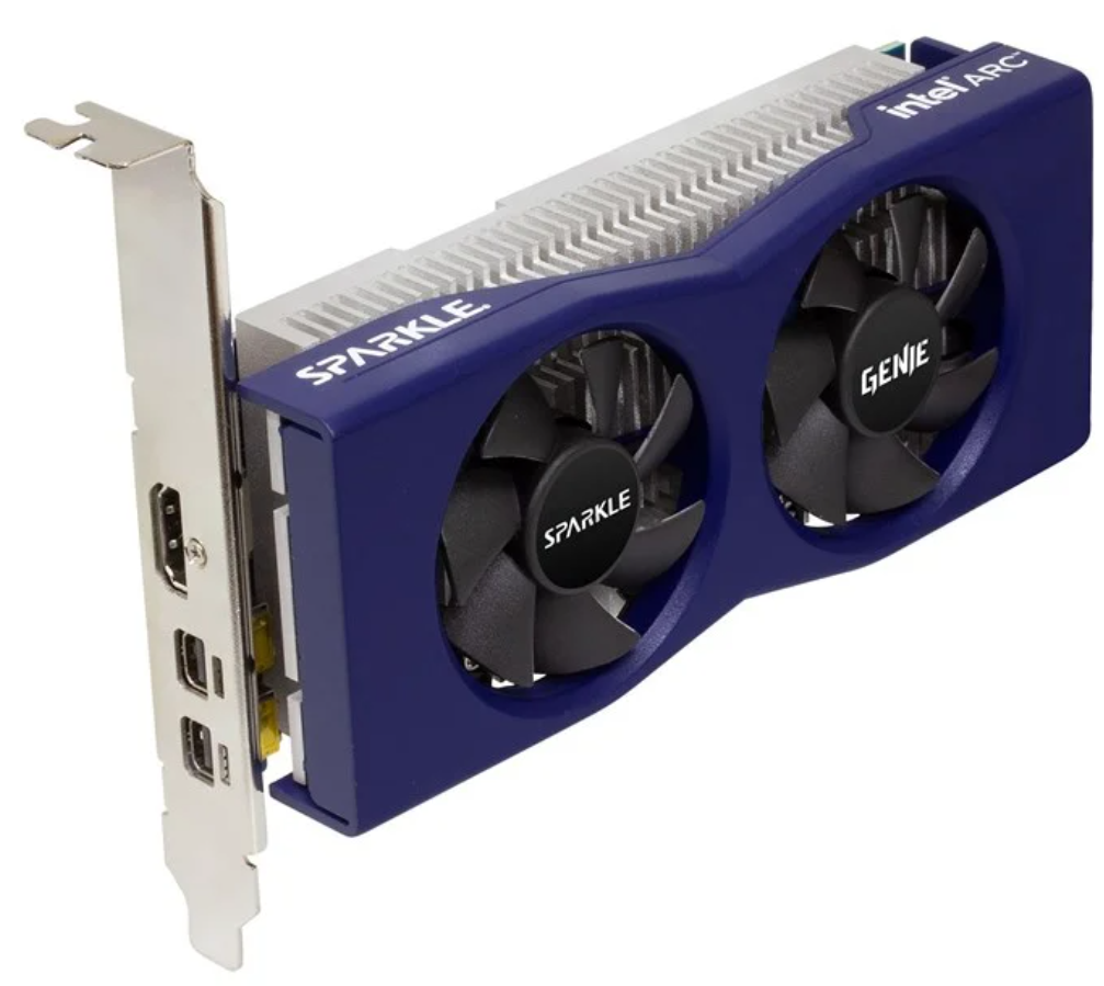

August 16, 20242 yr Author Just ordered a Sparkle Arc A380 Genie - 6GB GDDR6 RAM 🙂 I hope the low profile will help the airflow in my case
