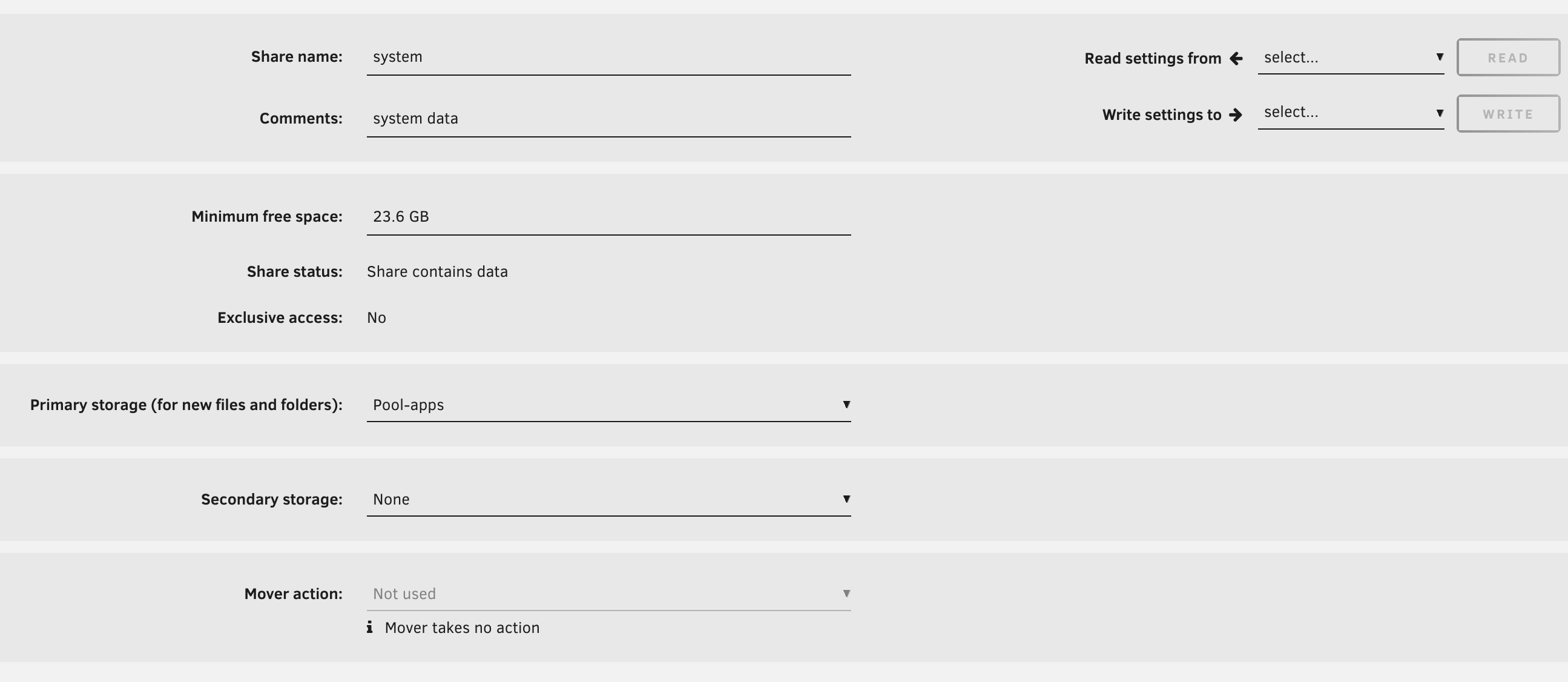

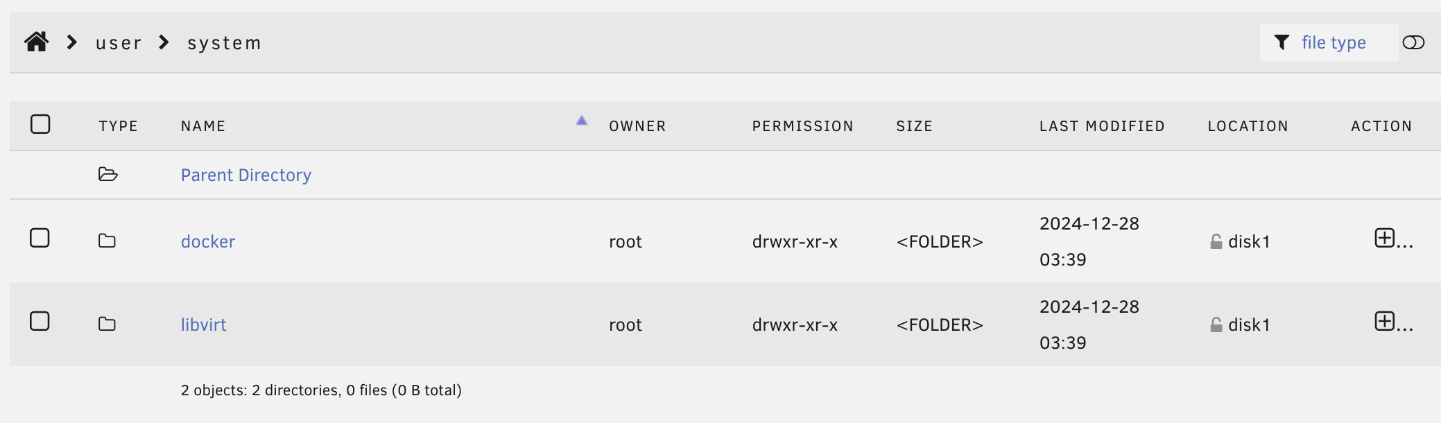

  1. Thanks @itimpi your solution worked and now that I moved the folders to the pool, the Exclusive Access is automatically set to "yes"
  2. Thanks for your reply ! So if I understand well, after disabling Dockers/VM all I have to do is simply use the "move" options ? And after that I could be able to enable Exclusive Access I guess ?

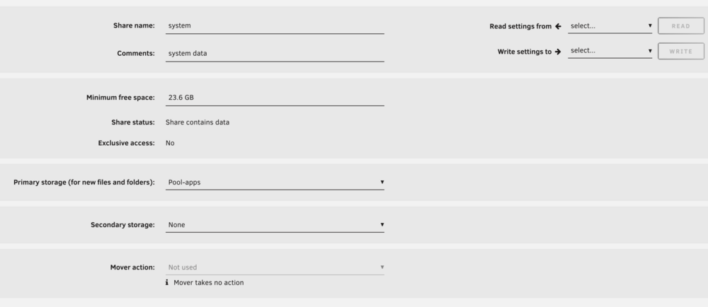

  3. Yeah I know it was literally my second screenshot and it was one of my questions "How to properly moves back my data to pool from array", aka the main purpose of this thread 😅
  4. Thanks for your reply ! Here is my diagnostics files. diagnostics-20260509-1751.zip
  5. Hello everyone, After getting a disk full I couldn't start my dockers. I wanted to enable Exclusive Access for the System share but the option is set to No and greyed out as you can see in my first screen. Before doing anything stupid, I would like you advices on how to properly move the files/folder to my SSD pool-apps. Do I have to simple turn off all my Dockers or do I have to put the array in maintnance ? And also why can't I enable Exclusive Access ? It's enabled in the settings and I already have Exclusive Access enabled on my appdata share. Thanks to any of you who will answer me !
