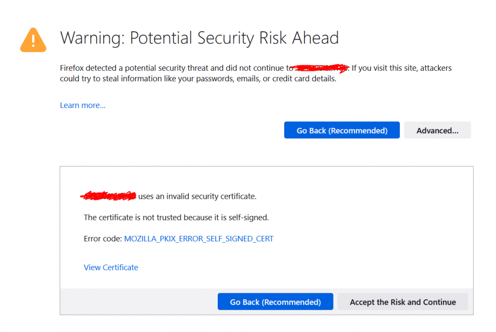

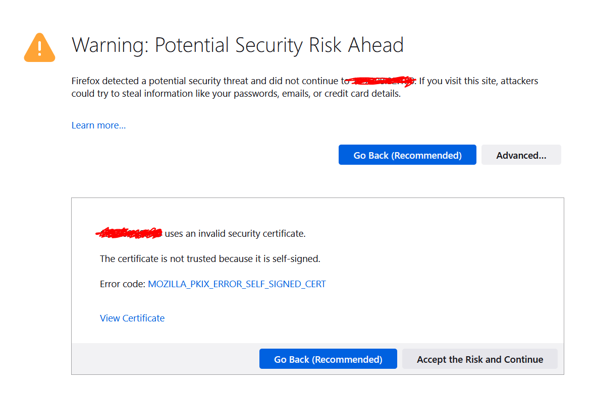

Hey there,
I've set up an Nginx proxy to an FileBrowser docker (and previously NextCloud) about a year ago, and so far everything has been working like a dream.
Until yesterday >.<
Not sure what happened, and when, but Nginx wasn't able to auto-renew the SSL certificate for my domain. I only noticed this yesterday, when I wasn't able to connect to the FileBrowser from the net anymore.
I've tried to "manually" (as in, from the Nginx GUI) renew the certificate, but it keeps failing.
On certain browsers (like Samsung's own web app, which doesn't seem to give two hoots about secure connections) I can connect to the FileBrowser docker just fine.
I also created a new domain, and new Nginx proxy host to my FileBrowser docker, without the SSL certificates, just to test if the connection is good. It is.
This is what I'm getting from the Docker log (inside of UnRaid) when I try to renew the certificate:
Internal Error
Error: Command failed: certbot certonly --config "/etc/letsencrypt.ini" --cert-name "npm-6" --agree-tos --authenticator webroot --email "[EMAIL HERE]" --preferred-challenges "dns,http" --domains "[EMAIL HERE]"
Saving debug log to /var/log/letsencrypt/letsencrypt.log
Some challenges have failed.
Ask for help or search for solutions at https://community.letsencrypt.org. See the logfile /var/log/letsencrypt/letsencrypt.log or re-run Certbot with -v for more details.
    at ChildProcess.exithandler (node:child_process:397:12)
    at ChildProcess.emit (node:events:390:28)
    at maybeClose (node:internal/child_process:1064:16)
    at Process.ChildProcess._handle.onexit (node:internal/child_process:301:5)
The external log files I can't seem to find anywhere 🤔

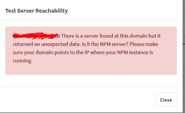

Trying to test the server reachability, I get:
Any help would be appreciated! :)

1 hour ago, REllU said:
This, however, created a "Bad gateway" error, which I'm now struggling with.
First page, read the 5xx error paragraph.
Rightyo! Let's see..
4.) Does NPM reach your target container?
Nope. Nginx container is in br0, and wasn't able to connect to FileBrowser, since that was in Bridge mode.
Changing FileBrowser into br0 as well, allows Nginx to connect to it succesfully.
I've then changed the port forward rule to reflect this change, which seems to work fine.
However, the situation is still very much the same:
✔️ http://[my-public-ip] (Skipping Nginx entirely)
✔️[FileBrowser_ip]:[FileBrowser_port] (Skipping Nginx entirely)
✔️Connection between Nginx and FileBrowser (with br0 network)
✔️http:// domain . com
❌https:// domain . com (results in bad gateway)
❌Server reachability test (Within Nginx)
I've only now jumped to the official docker image of the Nginx Proxy Manager, previously, I was rocking the jlesage's docker image, which has server me well up until the issue yesterday with renewing certificates. It was also using Bridge-network mode.

With Nginx running, I'm getting the (original issue from yesterday) potential security risk, which would point out for an invalid certificate.
Trying to continue from here gives me an "Secure connection failed"

Going to the certificates tab within Nginx, and testing the reachability of the server seems to still give me the same error as before. So I'm guessing renewing the certificates will still be an issue.
Edit 4:
Disabling the port-forward rule for port 80 within my router seems to still work.
Doing this however, does give me a different result in reachability test, which is now stating that there is no server.
