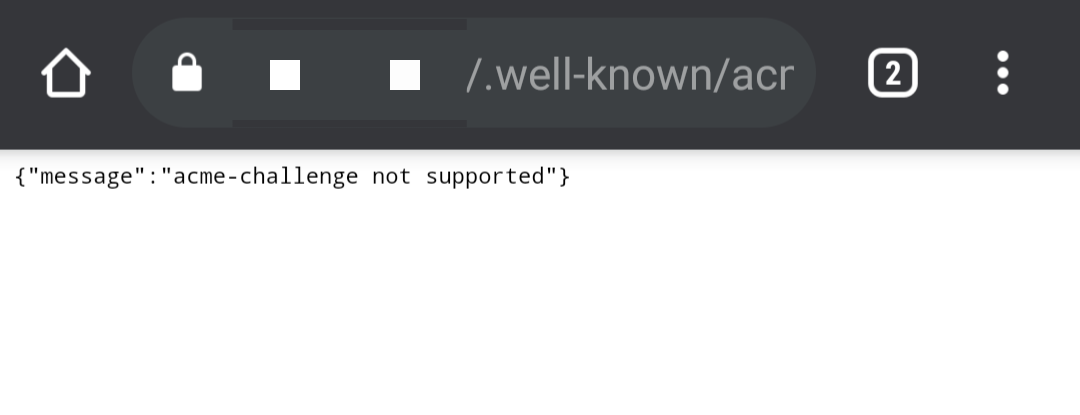

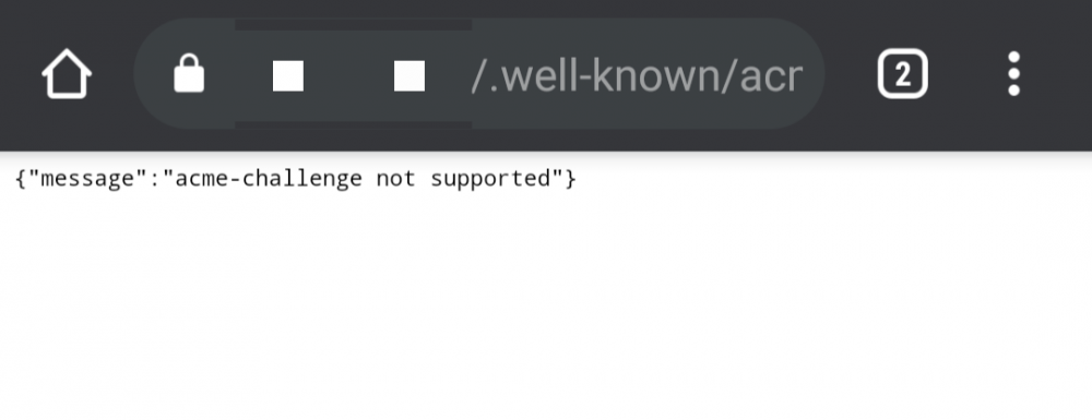

Hey there, I've been using NPM for quite a while without issue, but I have a weird one that just came up.
Some proxy hosts return HTTP 500, but only to certain clients. For example, one host will not work on my desktop, but works fine on my work computer and phone on the same WiFi or on cellular. A different host won't work on my work computer, but does work on my home desktop and my phone. I can't see where to find any logs that would help me track this down. Clicking logs in Unraid shows me the container's logs but there isn't anything that applies to incoming connections and why they fail. (ie. I restarted the container at 12:27, and there are log entries about that, and then when I load a page that works or that errors at 12:34, there are no new log entries for success or failure.)
Can anyone help with this?
Interesting question. At the moment I don't know an answer, but please try to open the following url with your work computer:
https://yourdomain.com/.well-known/acme-challenge
This URL is NOT forwarded by NPM to your container. Instead it serves it itself (it's usually used by Let's Encrypt, to verify SSL certificates).
By that we could find out if NPM is throwing the error 500. If you instead see something as follows, than NPM itself is reachable:
Maybe the container is returning the error 500 and not NPM.
Another thing you should test is http instead of https. This means you need to disable "force SSL" if it's set in the host settings (if you enabled HSTS, you need to use a different browser after disabling HSTS, as your browser stores this info for several months).
I'm unable to do this from work as mydomain.com is not pointed to my home servers, but to a different live site hosted commercially. I could do this later from home by overriding the hosts.etc file.
I believe it's safe to say that NPM is reachable, since for example, from my work computer:
edi.unraid.mydomain.com - Functions properly
gd.unraid.mydomain.com - Error 500
Also both are functioning properly from my phone at the exact same time.
This would be odd but not impossible, since it loads properly on other devices. I also thought of this, but there are no logs in Unraid (these hosts proxy to Unraid GUI) to indicate a failure either.
I'll have to try this later from home.
Should NPM be logging errors and/or successful connections? Is there a container var that could enable more verbose logging?

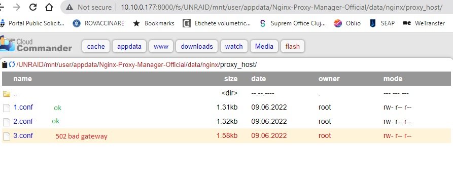

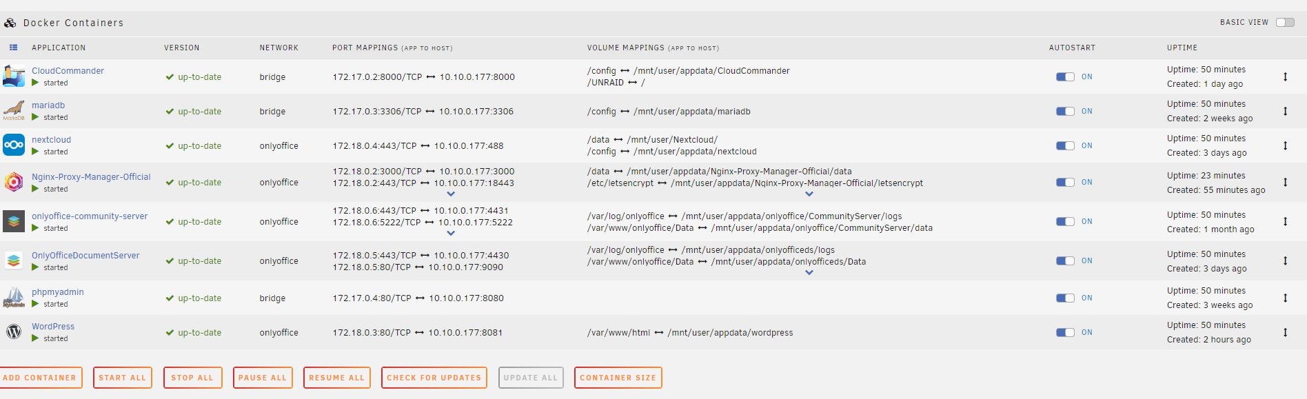

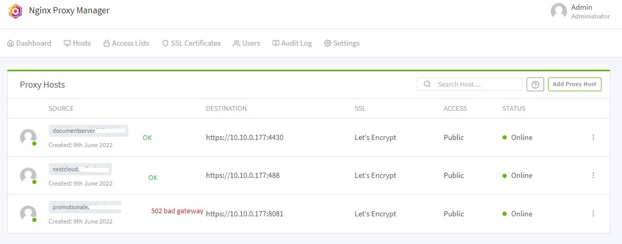

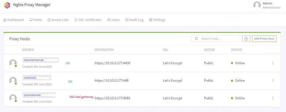

Hello,
Not sure if anyone an help me with the infamous 502 bad gateway openresty error, I tried all the solutions in the last 2 days.
What I need is to access a worpress docker site from internet using nginx proxy manager.
The wordpress docker is running fine, is accessible from local network, the nginx proxy docker is also working fine, there are also another 2 dockers that works fine from the internet.
I attached some printscreens with everything and the error in nginx log is:
2022/06/09 14:01:05 [error] 366#366: *281 SSL_do_handshake() failed (SSL: error:1408F10B:SSL routines:ssl3_get_record:wrong version number) while SSL handshaking to upstream, client: 86.xxx.xxx.xx, server: promotionale.example.com, request: "GET /favicon.ico HTTP/1.1", upstream: "https://10.10.0.177:8081/favicon.ico", host: "promotionale.example.com", referrer: "https://promotionale.example.com/"
not sure if is apache server not accessible by nginx
Can anyone figure it out?
Thanks!
3.txt default_host.txt

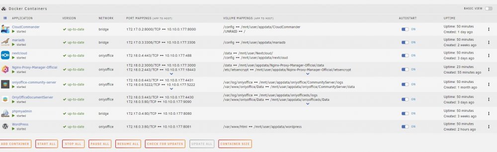

You are using https as target. The wordpress container listens to http. Using https inside the same local container network raises only the cpu usage without any benefit. Thats the reason why most of the containers do not even support https (port 443).
I tried without the https and it's just adding the port at the end of it. Same result on different browsers or pc.

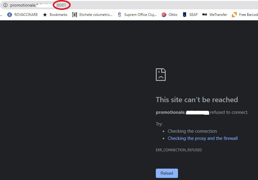

A proxy usually listens only to the ports 80 (http) and 443 (https). Depending on the used domain, the traffic is forwarded to a custom target. In your case 10.10.0.177:8081. This means if you open https://wordpress.example.com, it will forward this traffic to 10.10.0.177:8081. If you instead open https://wordpress.example.com:8081 it will reach nothing as NPM does not listen to this port.
PS http://example.com and http://example.com:80 are completely the same. The same is valid for https://example.com and https://example.com:443. Conclusion: http and https are only shortcuts for those ports.
The only open ports to this unraid server are 80 and 443, that are used by nginx to redirect traffic to the specified internal ports. 8081 is the wordpress container but the port is not opened on router. cloudflare dns is pointing the https://wordpress.example.com  to the external fixed ip address and nginx should redirect to the worpress container. that's why is weird that browser is adding the 8081 port at the end of the link.
this is not the first time doing this, but this time I have no ideea why is not working, i did this before last unraid update, not sure that is the cause.
i did reinstall wordpress container, nginx container, nothing changed, they are on the same network
it's probably me, but I just can't figure it out :(
I managed to make it work by deleting all, delete custom bridges, and recreate from scratch.
Thanks for advices!
