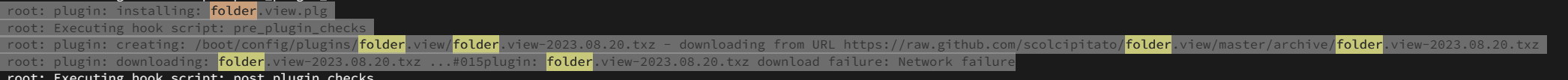

  3. Checked boot logs, looks like plugins get reinstalled during reboot. Folderview wants to download itself for install, that fails on my unraid. I do not have Internet Access when Unraid is booting.
  4. Great Plugin, although i have to reinstall it after every reboot of unraid. It does land in the error plugin tab after a reboot. Installing it again works till next reboot. Is this known or normal for this kind of Plugin ?

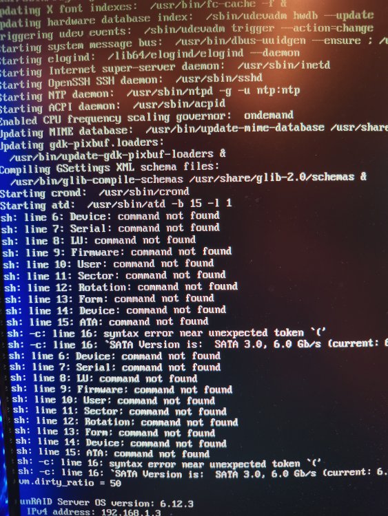

  8. Lately noticed weird messages on the console after a boot up. Everything so far looks to be running. It is a while since i last checked the console. Where is this coming from ? Also noticed that a plugin called folderview is always gone after a reboot and i have to reinstall it.
