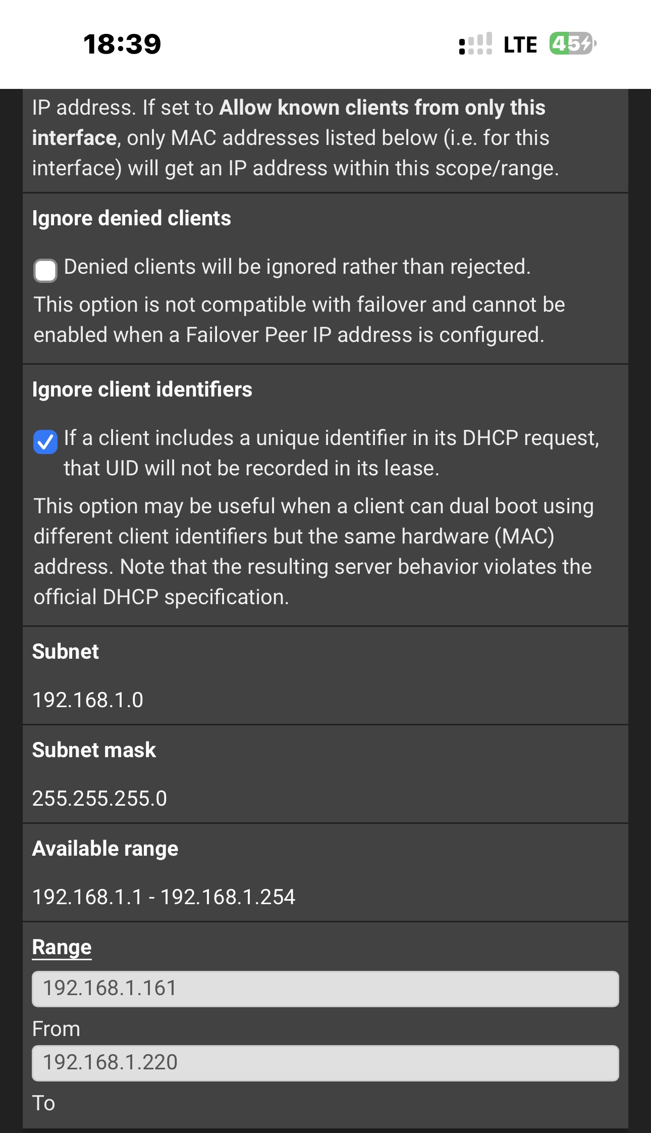

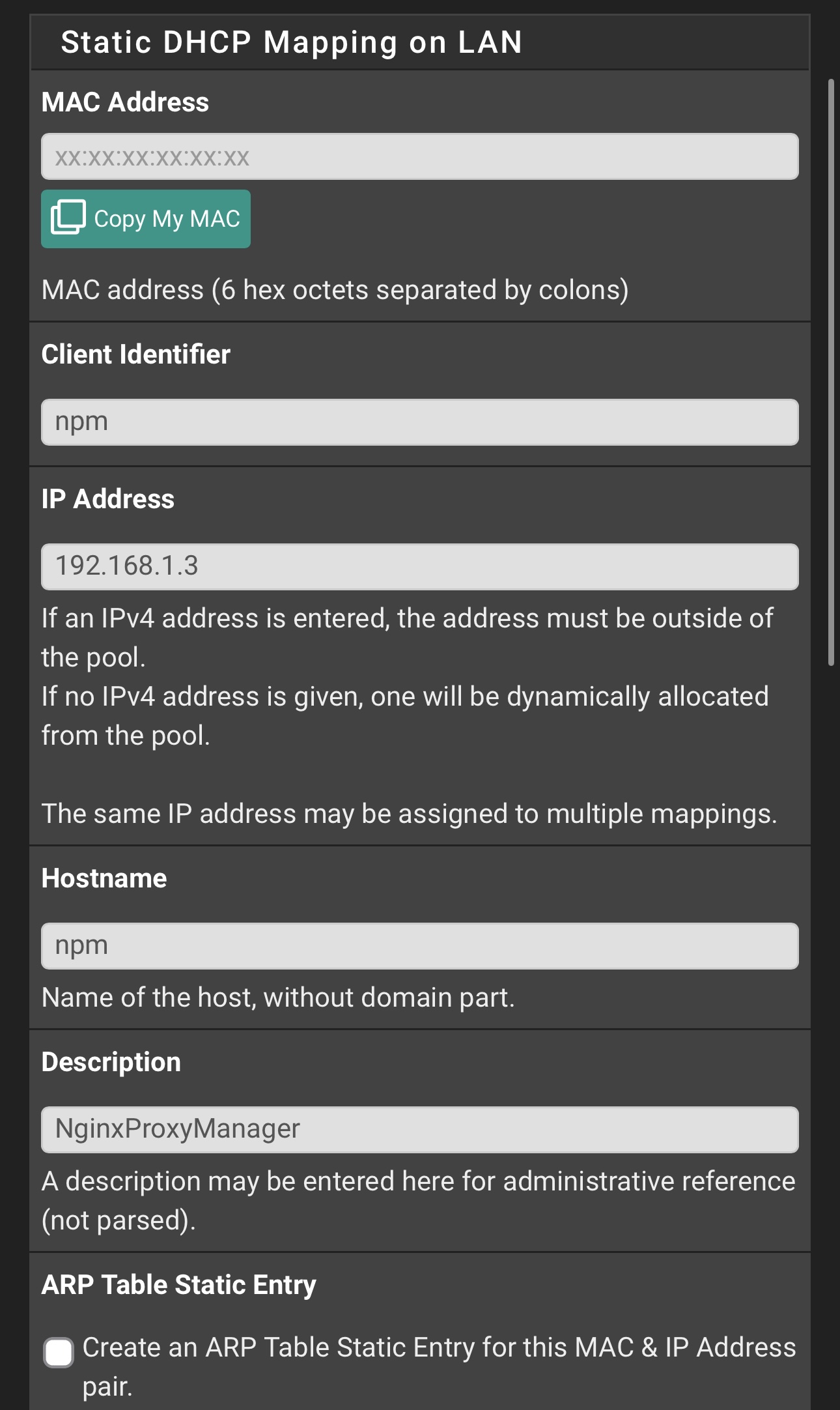

19 minutes ago, mgutt said:
Is it part of a DHCP range?
No, but in pfSense I don’t have a MAC addresses assigned with .3 or static set because Unraid uses same MAC address for everything?
See post below below for pics. Somehow totally jacked up post.
Edited by blaine07
I think other issue is now that Unraid uses ipvlan for Docker it uses same mac address for every container in Unraid. I am already using Unraids NIC Mac address for a static IP for Unraid itself which means I can't actually set static IP for NPM since MAC address is already tied to Unraids actual IP. Since Unraid changed to ipvlan I haven't figured out how to get around it; i suspect it's relative to my issue, somehow, though.
You can just specify the address on unraid side instead of using DHCP.
Or switch back to macvlan, the default has changed because it was a rather common source of issues, but if it worked fine for you like it does for me you can still use it.

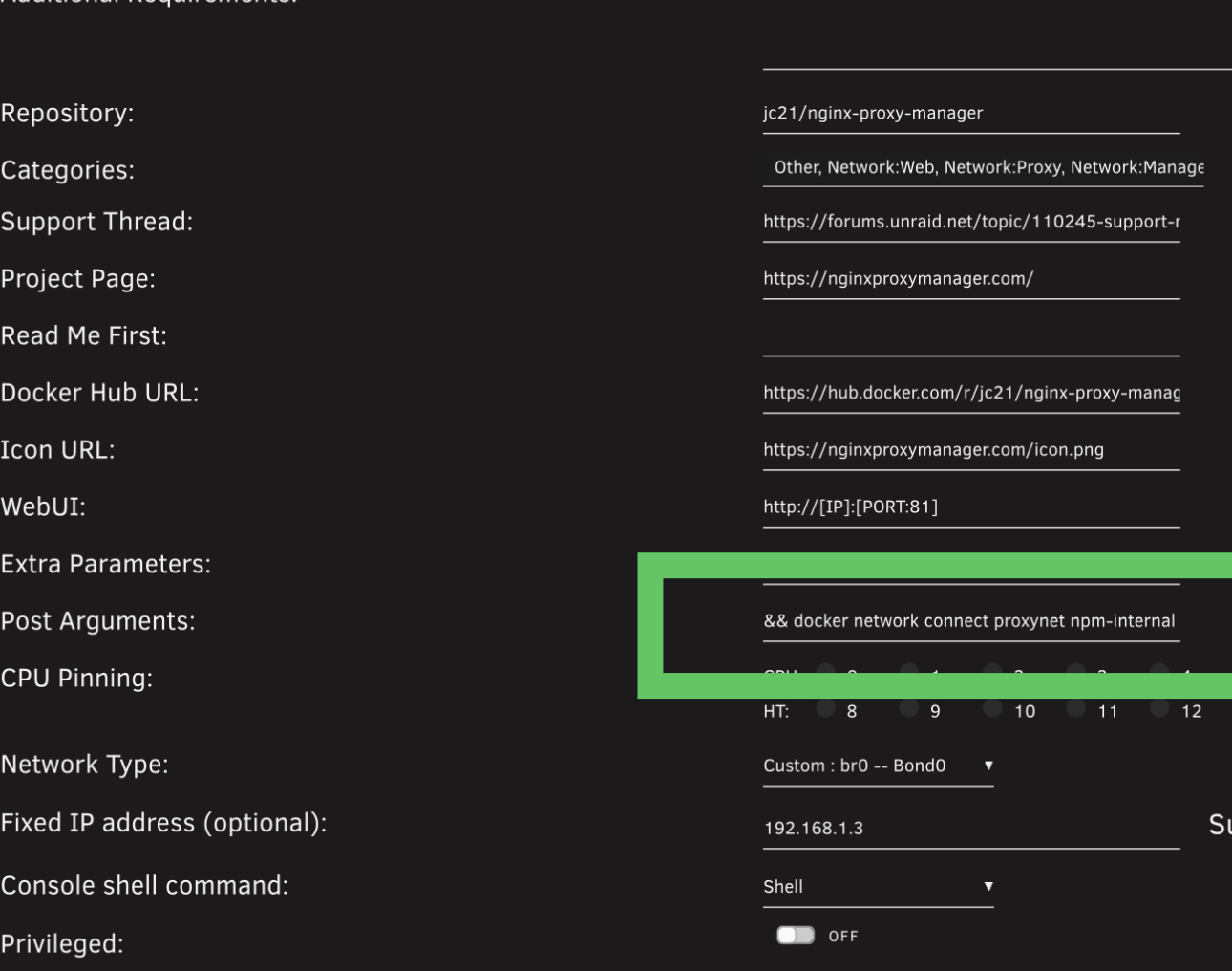

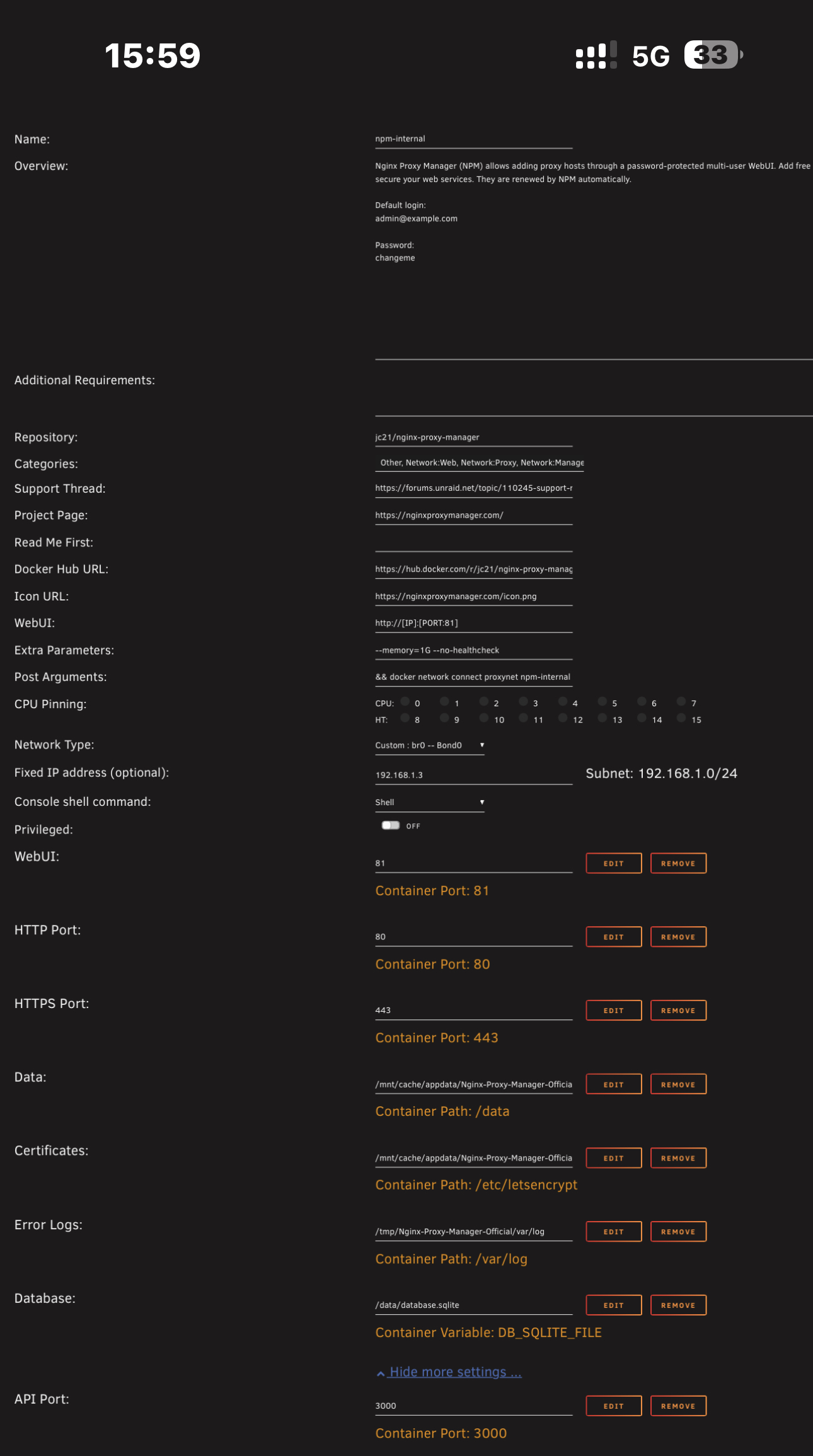

4 hours ago, blaine07 said:
Macvlan was total chaos for me. I just deleted the mapping on pfSense. We’ll see what that does.
Back to doing it again. Guess I just may ignore it. It never quits working. Just spams logs. Or I need to put a 1 hour restart chrono on NPM. Sometimes it goes 2-4 or 12 hours without spamming logs.... Hmm
Am I doing this add on network thing right? I don’t even think I need it because I am not referring to any containers by name- all IP:PORT. Could this be my issue?
Yeah there is something wrong with the command. Or does your npm container has the name npm-internal
Syntax is:
docker network connect network_name container_name
But note: In some situations the post arguments are not executed. I think it was while updating a container. But I'm not sure.
Syntax is:
I’ll try just removing it and see what happens. Since not referring to any containers by “name” and instead using all IP:PORT I don’t think I even need the syntax/be on specific network too?
