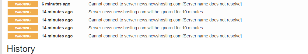

  1. @binhex I do have one further question though. I am using PIA via wireguard in the container and am constantly getting the below when trying to DL items... if I click the spanner and click unblock it will eventually work... if I am DL'ing things in the background (on a schedule per se) it may happen when it first gets added but will eventually resolve itself after the 10min wait.. any idea why this happens? is it because of the name servers in the template of the container and maybe one of them cannot resolve the server of the news reader?

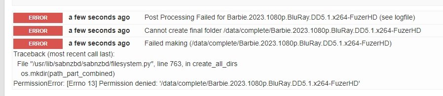

  2. FYI Sorted the above. Changed the permission on the unraid share for just the completed folder to match the incomplete folder and now its working. although not touched the settings of the shares in over 3 years so no idea what caused it.
  3. I am having the same issue as above. Recently after completing a download SAB says it cannot write to the incomplete folder even though nothing has changed on my system other than updating the container. screenshot attached of the error... any idea what's causing or a fix? P.S excuse the title of the file, I swear it was just to test

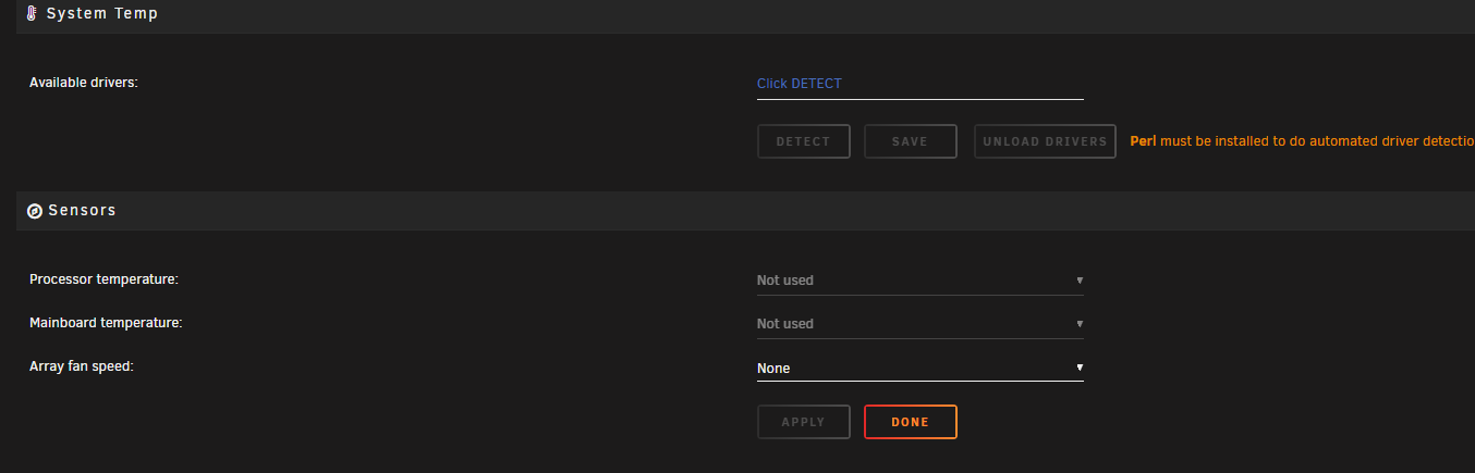

  12. to be fair i already had that installed. it seem updating unraid borked it.. working again now
  13. Hi all. Maybe a bit dumb on my part but I have just installed unraid 6.10.3 (previously I was on 6.9) and now system temp plugin seems to be broke. when i go into the plugin settings page everything seem to be greyed out, tried rebooting the server a few times but doesn't help any idea?
