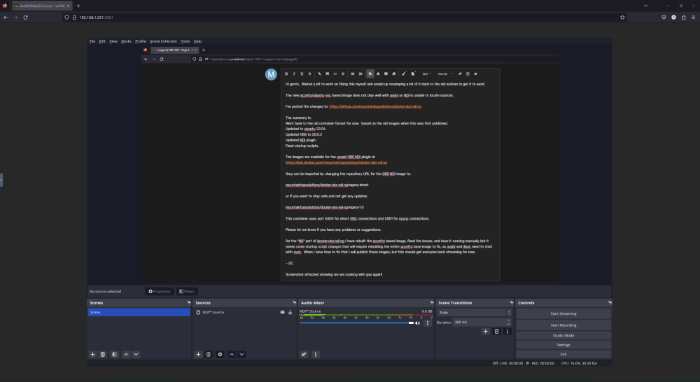

  • Created an issue on GitHub to report this there as well   Also, @patrickstigler, thanks a lot for putting this all together.
  • mountaintop
    mountaintop
    Hi gents,  Waited a bit to work on fixing this myself and ended up revamping a bit of it back to the old system to get it to work.   The new accetto/ubuntu vnc based image does not play well

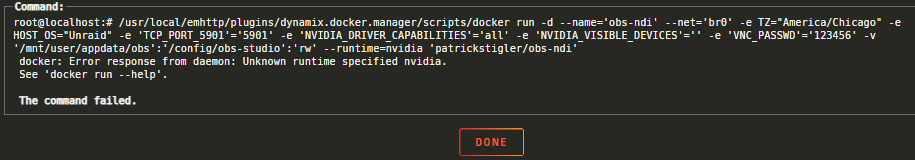

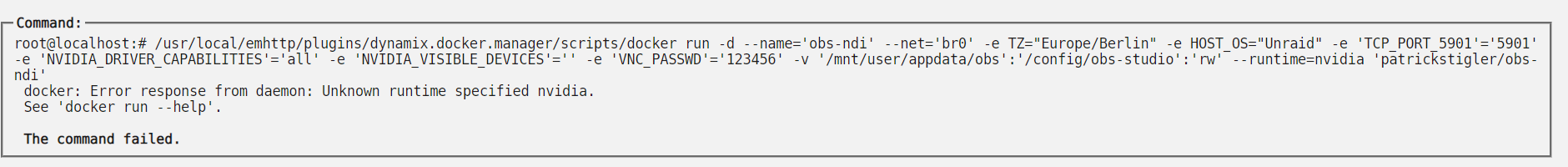

Getting an error trying to install this?  I do not have an nvidia card, is it a requirement?
Beat me by seconds, I am having the same issue.
Hi you can run it without a GPU, just remove the --runtime=nvidia
That should fix it.
@parish
@phoenixrisen
Hi, i have the same issue. I'm trying to install without the extra parameters.
I didn't delete the extra parameter in advanced view. Now it works.
You tried installing the Nvidia-Driver?
I was running into the same issues as yall but after installing the driver the default variables worked (only thing I changed was the IP address)

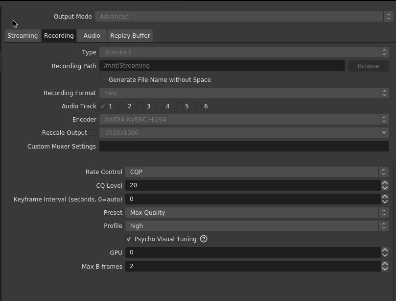

Perhaps I miss something but it seems that the recording does not really uses the GPU?
I have everything set - same as for Plex for the Docker run statements. But the GPU is barely in use.
The settings are just an example. I have tried a lot of different  settings.
The output from my main computer is 1080p 60FPS.
On the Docker I reach only max 40FPS recording.
It iw only possoble that it uses the dGPU or doesn't use it, something in between is not possible.
What card are you using? In your screenshot I see the Recording tab, what does the Streaming tab look like.
Do you simulaneus use Plex, or better speaking is Plex transcoding in the background?
same as for Plex

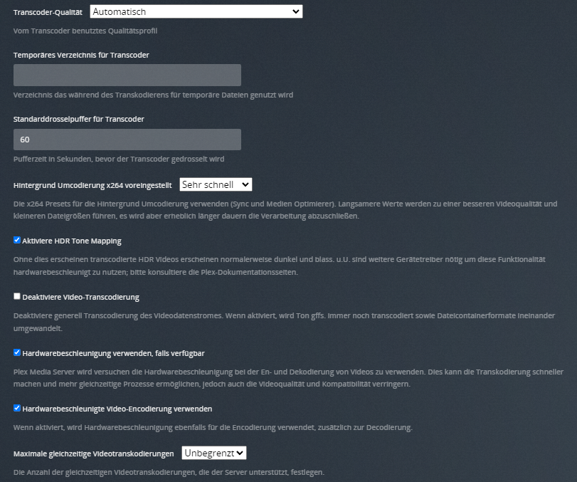

Have you turned on trottling in the Plex settings for transcoding?
This is just a normal behavior if yes, try to turn it off, force a transcode and see what happens.

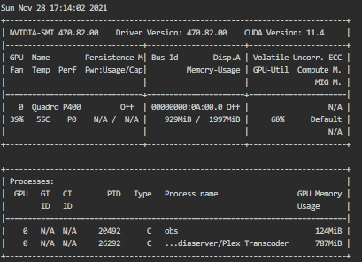

I am running a Quadro P400 - no active processes.
My Plex Settings are default:
I assume you speak german. But it's basically default, auto select Quality, Hardware acceleration and unlimited simultanes Encodings.

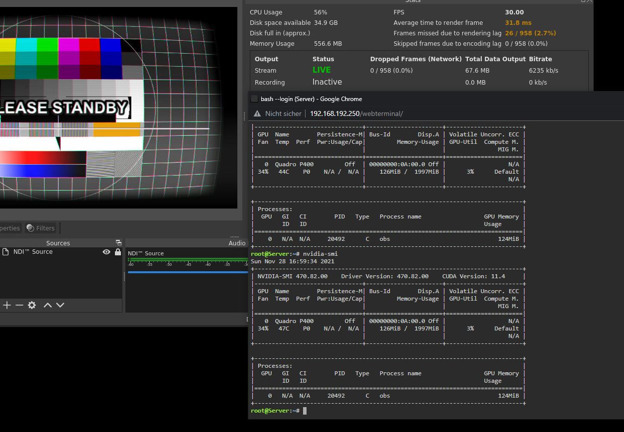

I am running a docker with OBS and a Docker with Plex which share the GPU.  If you have an idea let me know. I will check again. And as soon as I find a solution I will update the container.
This seems completely okay to me.
Side note, you can also type in "watch nivida-smi" this will update nvidia-smi every two seconds, to end it press CTRL+C
If I got you right there, you think I have obs running 2times at the same time?! No
No, I thought maybe you run 2 or even 3 Plex transcodes and try to use it for a 4th transcode for OBS (by default only 3 simultaneous transcodes are allowed on consumer/prosumer cards).
I really can't help, from what I see OBS is using your card and should work just fine.
The difference in usage from OBS and Plex is caused because you started transcoding a 4K file am I right?
A 1080p file is really not that hard to transcode, even for the P400. I only can think of a problem with OBS that it transcodes not like you want it to, the card should be capable of 1080p/60 without a sweat.

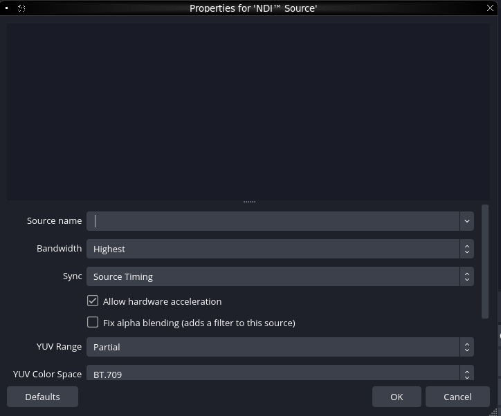

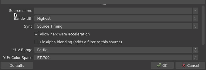

One thing I was missing was the hardware acceleration on the NDI source but even with this option enabled only the CPU is used.

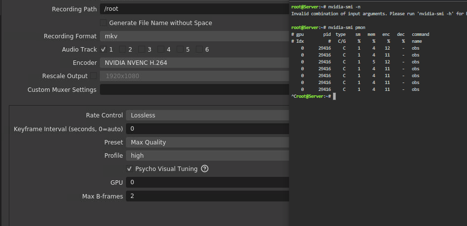

On my PC itself the whole NVENC works just fine. Do you have any starting point for me how I could troubleshoot it to check for the issue within the container/with the driver?
Wait you transcode first on your PC or am I wrong?
From my understanding you don't need to enable NVENC on the main machine where you actually capture the screen because you are "streaming" the raw footage over the NDI plugin, correct me if I'm wrong please...
Also keep in mind that the low usage can be also caused because the card only has to encode the stream and not like it's the case on Plex where it has to decode/encode it again.

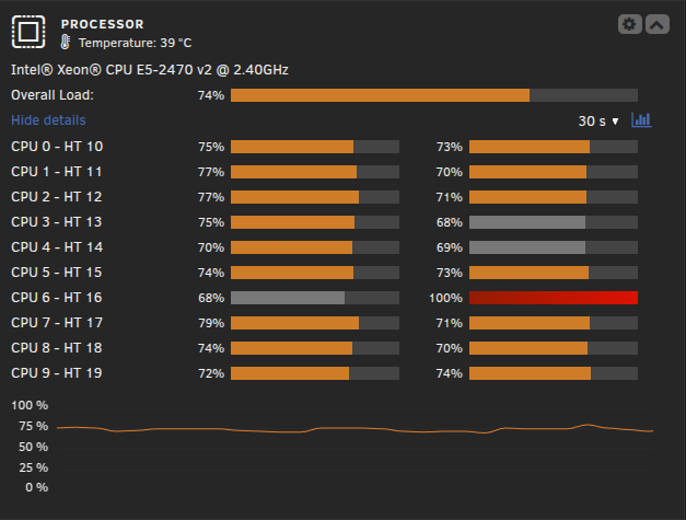

My problem is that the container does not really utilize the GPU. When I stream or record the CPU usage goes up, the GPU usage sticks at around 1%-2%. And I can see it as well in the recording performance.
