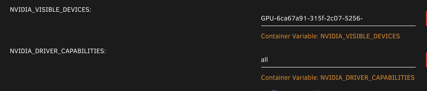

On 12/2/2021 at 12:24 AM, patrickstigler said:
I'd say you GPU is not really used by OBS.
Have you checked to NVIDEA parameters in Docker?
Yes, same settings as with Plex container and there the GPU is used.
Just to make sure, you're removed the last part of the GPU ID only in this screenshot, right?
Because that is not the full ID.
Yes, just kind of a habit for IDs in general.

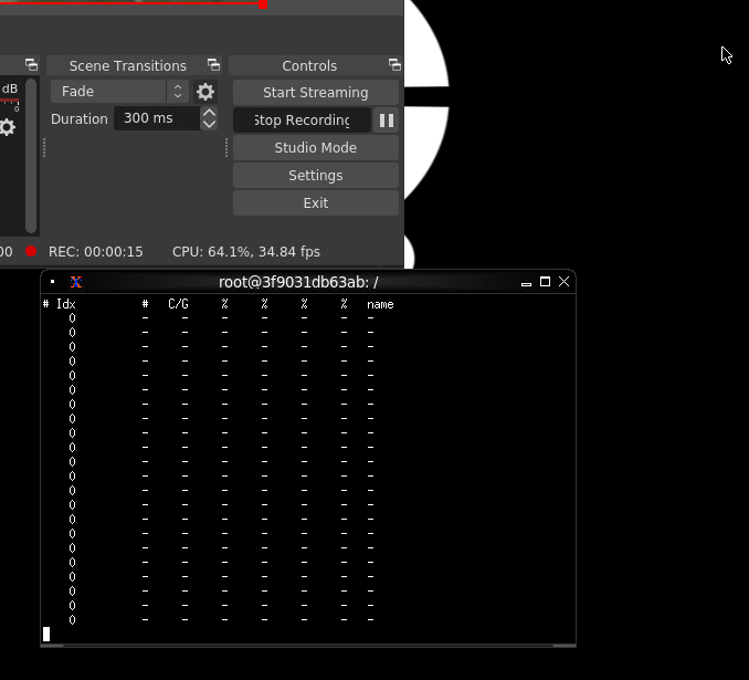

Ok I updated the whole image, but I think you will have the same problem. I hope that the rewrite of the NDI tool will improve it. But at the moment I am not 100% sure if it is the NDI or the OBS itself. I might setup a VM to test it and improve the container.
For some reason I got it working that via "nvidia-smi pmon" I get the report back that OBS is using my GPU. The encoding is just something between 2-7% though. That translates also in my FPS the recoding happens. I play on 60 FPS, output is 60 FPS but the recording depends on the container . If I fully load all CPUs then it even drops down to 4 FPS recoded up to 40 FPS. This feels like the GPU is not really used?

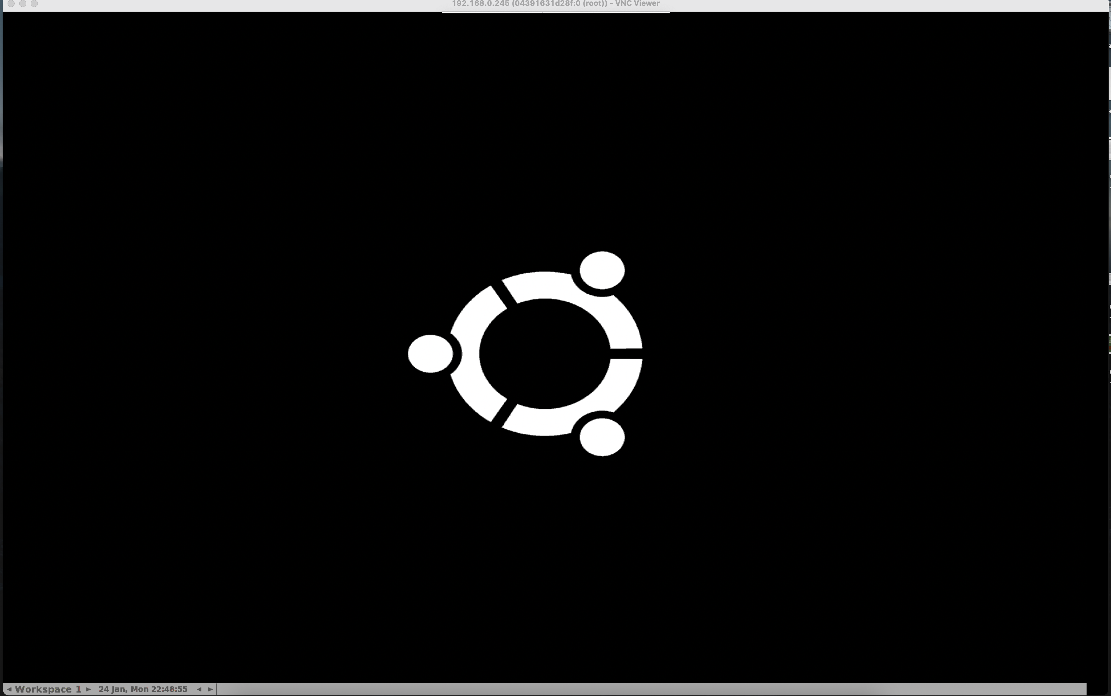

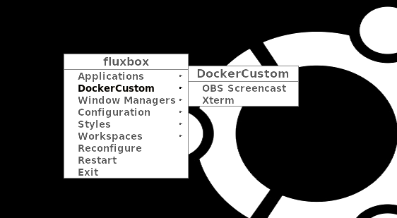

Hi All, can someone help, I'm just getting this screen when I connect and unable to load OBS
Right click on the screen
