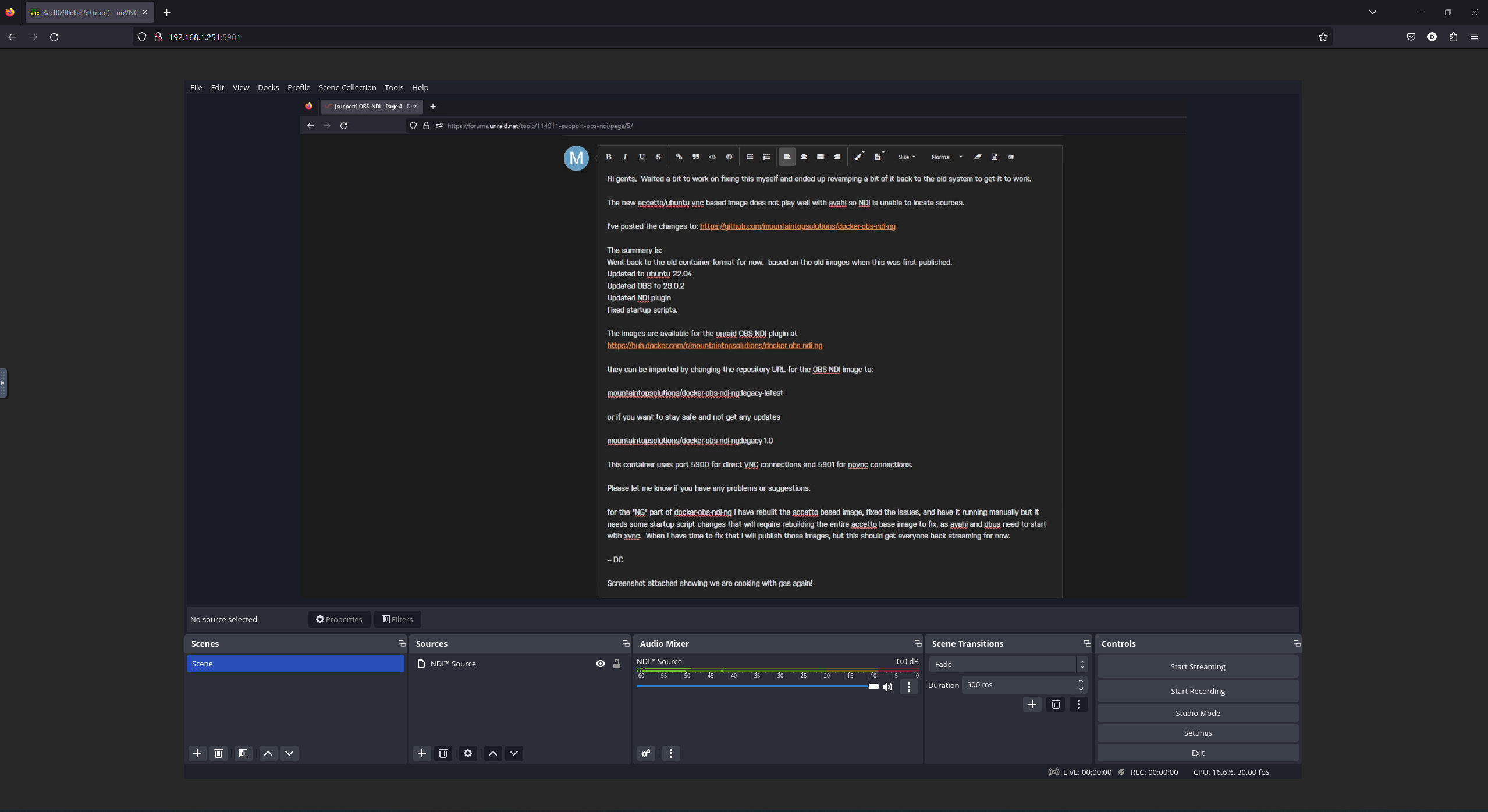

    Hi gents,  Waited a bit to work on fixing this myself and ended up revamping a bit of it back to the old system to get it to work.   The new accetto/ubuntu vnc based image does not play well
  • patrickstigler
    patrickstigler
    Hi you can run it without a GPU, just remove the --runtime=nvidia     That should fix it.   @parish @phoenixrisen
On 3/1/2023 at 5:37 AM, patrickstigler said:
Hi Sorry for the delay.
I will take a look at it, but currently I am quite busy so I had no time to do something on the image.
Also my network interface broke (might be a software issue) but now I have to fix the build pipeline first. I will update you guys here.
No need to be sorry, I'm just grateful for your work
The new accetto/ubuntu vnc based image does not play well with avahi so NDI is unable to locate sources.
I've posted the changes to: https://github.com/mountaintopsolutions/docker-obs-ndi-ng
The summary is:
Went back to the old container format for now.  based on the old images when this was first published.
Updated to ubuntu 22.04
Updated OBS to 29.0.2
Updated NDI plugin
Fixed startup scripts.
The images are available for the unraid OBS-NDI plugin at
https://hub.docker.com/r/mountaintopsolutions/docker-obs-ndi-ng
they can be imported by changing the repository URL for the OBS-NDI image to:
mountaintopsolutions/docker-obs-ndi-ng:legacy-latest
or if you want to stay safe and not get any updates
mountaintopsolutions/docker-obs-ndi-ng:legacy-1.0
This container uses port 5900 for direct VNC connections and 5901 for novnc connections.
Please let me know if you have any problems or suggestions.
for the "NG" part of docker-obs-ndi-ng I have rebuilt the accetto based image, fixed the issues, and have it running manually but it needs some startup script changes that will require rebuilding the entire accetto base image to fix, as avahi and dbus need to start with xvnc.  When i have time to fix that I will publish those images, but this should get everyone back streaming for now.
-- DC
Screenshot attached showing we are cooking with gas again!
-- DC
I just set up your container and everything worked perfectly right off the bat! Would it be possible to add a "spice" option along side VNC for accessing the container? Spice allows for usb passthrough, so we could use stream decks and foot pedals to control the OBS scenes in the container. It's not necessary by any means, but it would be a nice quality of life upgrade. I'm not too familiar with containerization, but I would be happy to help in any way that I can!
