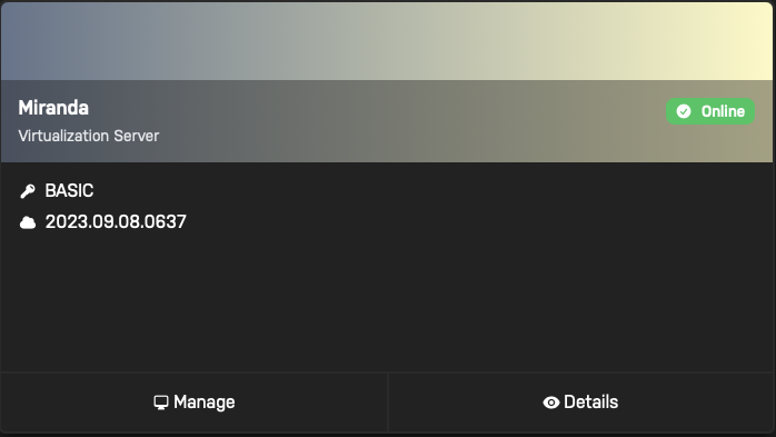

  10. I also checked my router's app and the server is not showing up in the list of connected devices. However it looks like my server can still ping the Unraid mothership as it shows up as being online on the Unraid Connect dashboard website.

  12. This is a new system. It has never worked properly unfortunately, it's always been a little erratic. This machine uses 4 nvme drives in a pcie card that came with my motherboard (https://www.amazon.com/ASUS-M-2-X16-Expansion-Card/dp/B084HMHGSP). I just double checked and it looks like I did not properly configure my bios to use these nvme drives as a raid 0. That might have been why Unraid was giving me errors and why the drives were showing up as 4 separate drives. I've just wiped the drives and configured them properly. Here is the new diagnostics file. Unfortunately, this still doesn't resolve the issue with the webUI. From the server's command line I can ping google and my laptop just fine, but from my laptop, I cannot ping the server. Perhaps this is a network issue? I double checked and it looks like the server and the laptop are both connected to the same network. The server via ethernet and the laptop via wifi. miranda-diagnostics-20241031-0736.zip
