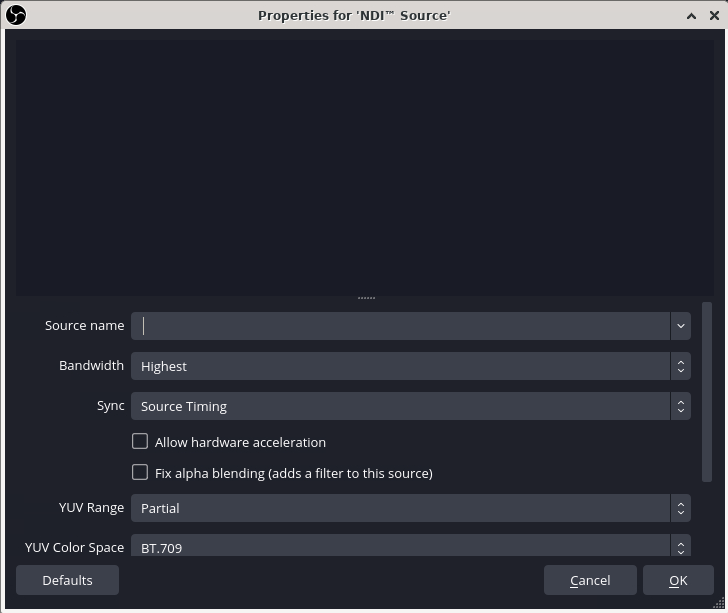

2. When I try to pick up my NDI source, I don't see any options. Is there something I'm missing?

2. You have to be in the same subnet. That is also the reason why you have to define a IP for the container.
I'm having the same issue as iForeverNoob.  After updating (and updating all my OBS "endpoints"), my NDI source isn't showing up in the Docker image, but it does show up in a Windows VM that runs from the same Unraid server.

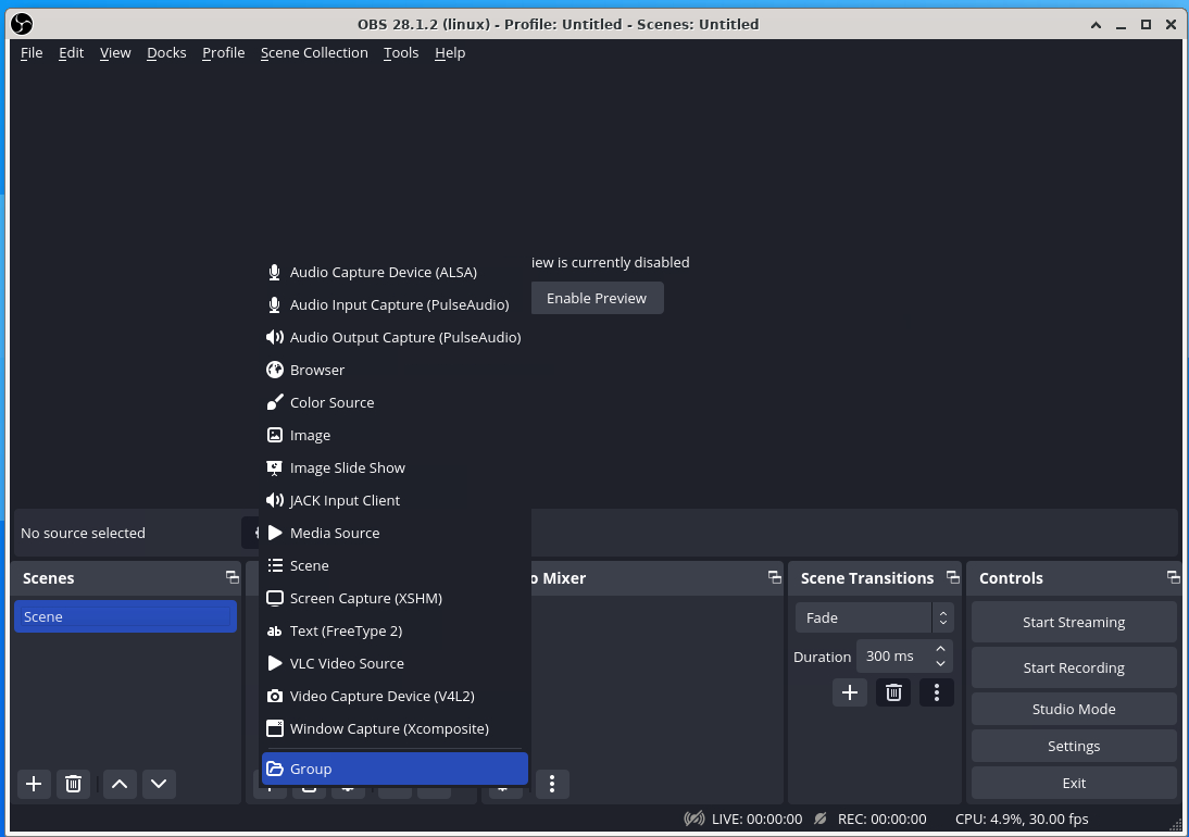

But unfortunately now I don't have the possibility to select the NDI plugin.

It looks like NDI was removed with the newest build, yes.

@patrickstigler It seems the latest image broke the install of the NDI plugin. Any chance you know why?

@patrickstigler Appreciate the work you've put in. I can confirm that changing extra parameters to --device=/dev/dri allows for H.264 encoding by Intel QSV, however the latest image does not have NDI Source as an option. Any chance this can be fixed?

Actually I got it right, you just have to change extra parameters to --device=/dev/dri and when you spin up the container, open OBS, settings, streaming, advanced, you will see that there's the hardware encoder available for usage. The problem now is that this container seems abandoned by the dev and the latest one has broken NDI implementation where under sources, NDI doesn't even show up. Sigh, it would be nice if @patrickstigler would come back to this.
