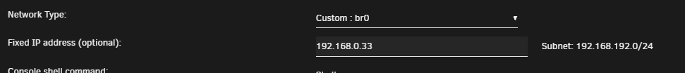

You must be in the same subnet. Than it will work. Just define your container within the same Subnet i.e. 192.168.0.X
That is the exact way I am using it.
Sometimes it can take a bit till your Desktop will be found. (Have you enabled it on your desktop?)
Hi would you please help.
I am trying receive ndi streams inside docker container but obs studio doesn't see any ndi source from outside. I try to setup Subnet but it doesn't help.
Let me know please does your obs studio inside docker see outside ndi source?
what ports do you share with host
i am expose ports docker run --shm-size=256m -it --expose 5353 --expose 5353/udp -p 5900:5900 -p 5901:5901 -p 5910:5910 -e VNC_PASSWD=123456 daedilus1/docker-obs-ndi:latest
As far as I know it does not work with exposed ports. You have to create a bridged interface in your subnet.
So if you IP is 192.168.0.[something] it must be 192.168.0.[a free IP] like 192.168.0.200

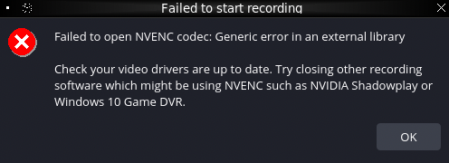

Since the last update I did I get this error and cannot record anymore?

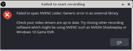

Correct me if I am wrong but I recall that I always used NVIDIA NVENC HEVC up until a point it did not work anymore?
Nowadays when I try to record something with it selected as the encoder I receive this error (also with the previous build)
