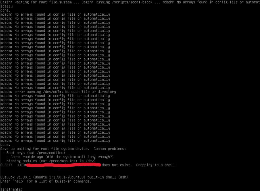

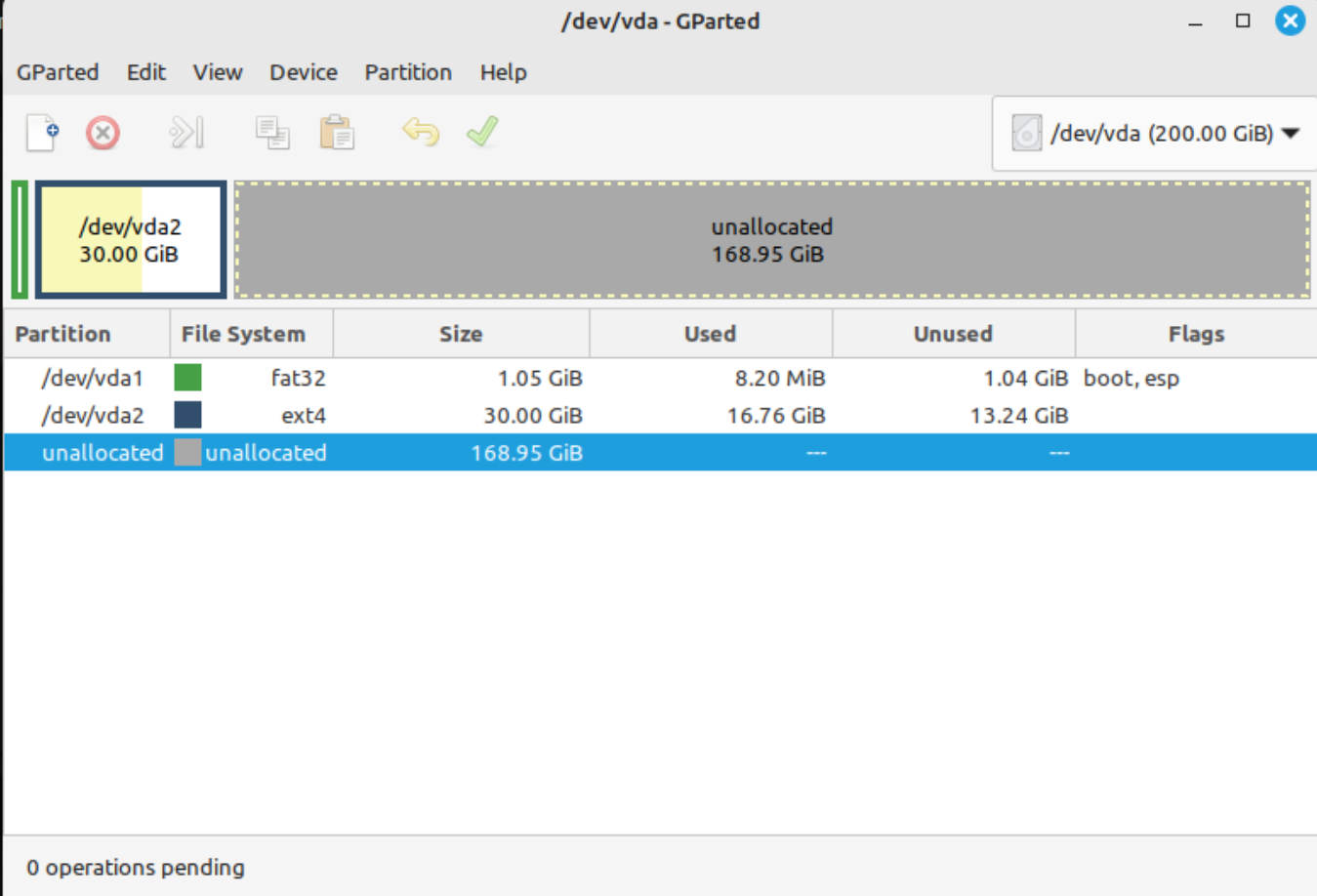

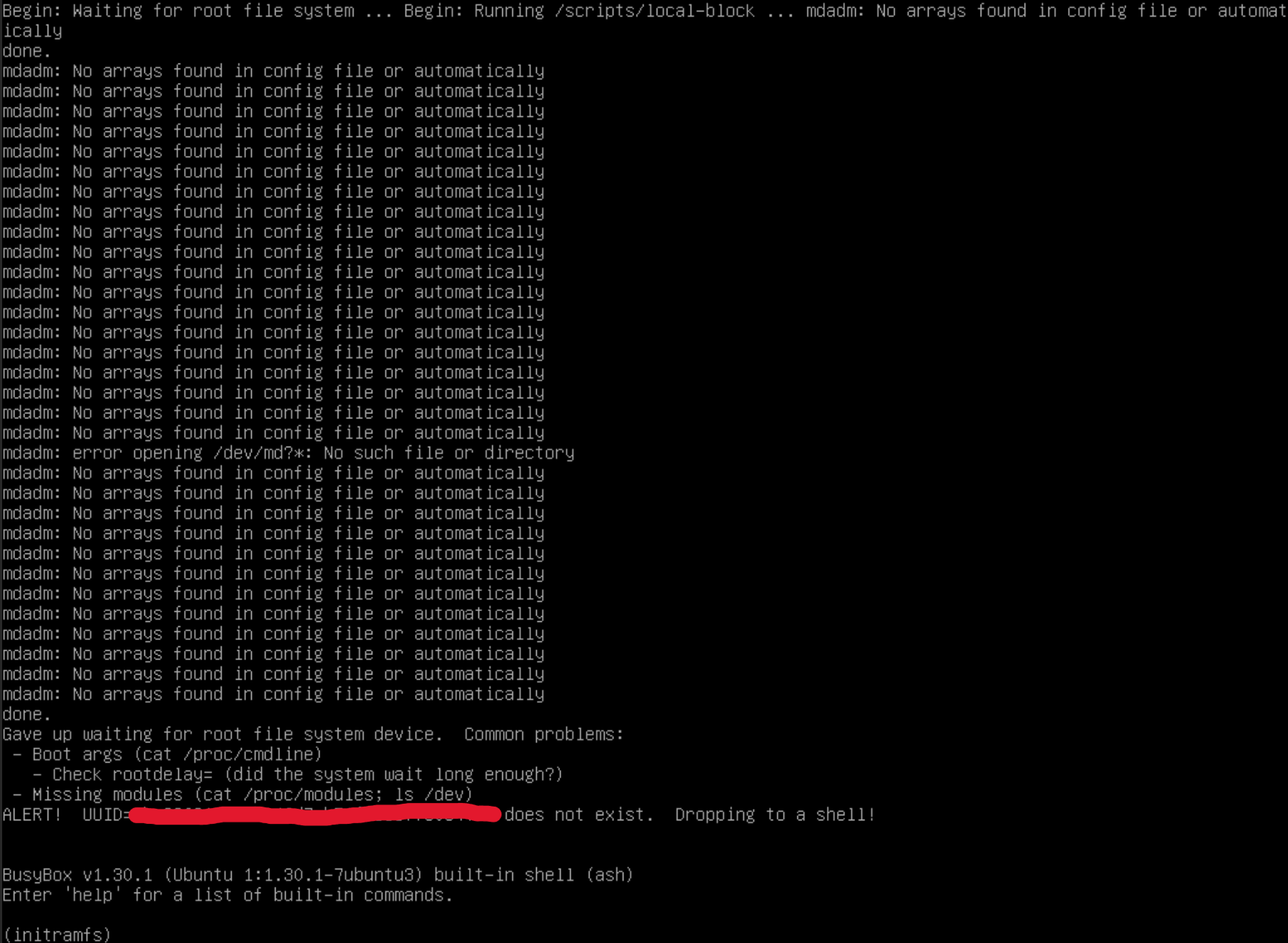

  1. I'm having some trouble shrinking my Ubuntu Server 22.04 vdisk from 200 GiB to 40 GiB. I booted into a live distro, used GParted to shrink the primary partition to 30 GiB (to expand up to 40 later), and confirmed there are no partitions after it. Booted back into Ubuntu and it worked perfectly. Shut it back down and made a backup. Resized the .img file with qemu-img to 40G, and now suddenly it will no longer boot. It gives up waiting for the root filesystem to become available. Since I had a backup, I tried multiple different variations of the command, to no avail: qemu-resize --shrink vdisk1.img 40G qemu-resize --shrink vdisk1.img 199G qemu-resize --shrink -f raw vdisk1.img 40G qemu-resize --shrink -f raw vdisk1.img 199G Am I missing a critical step for Ubuntu/Linux that isn't required for shrinking a Windows vdisk? Thanks in advance.
