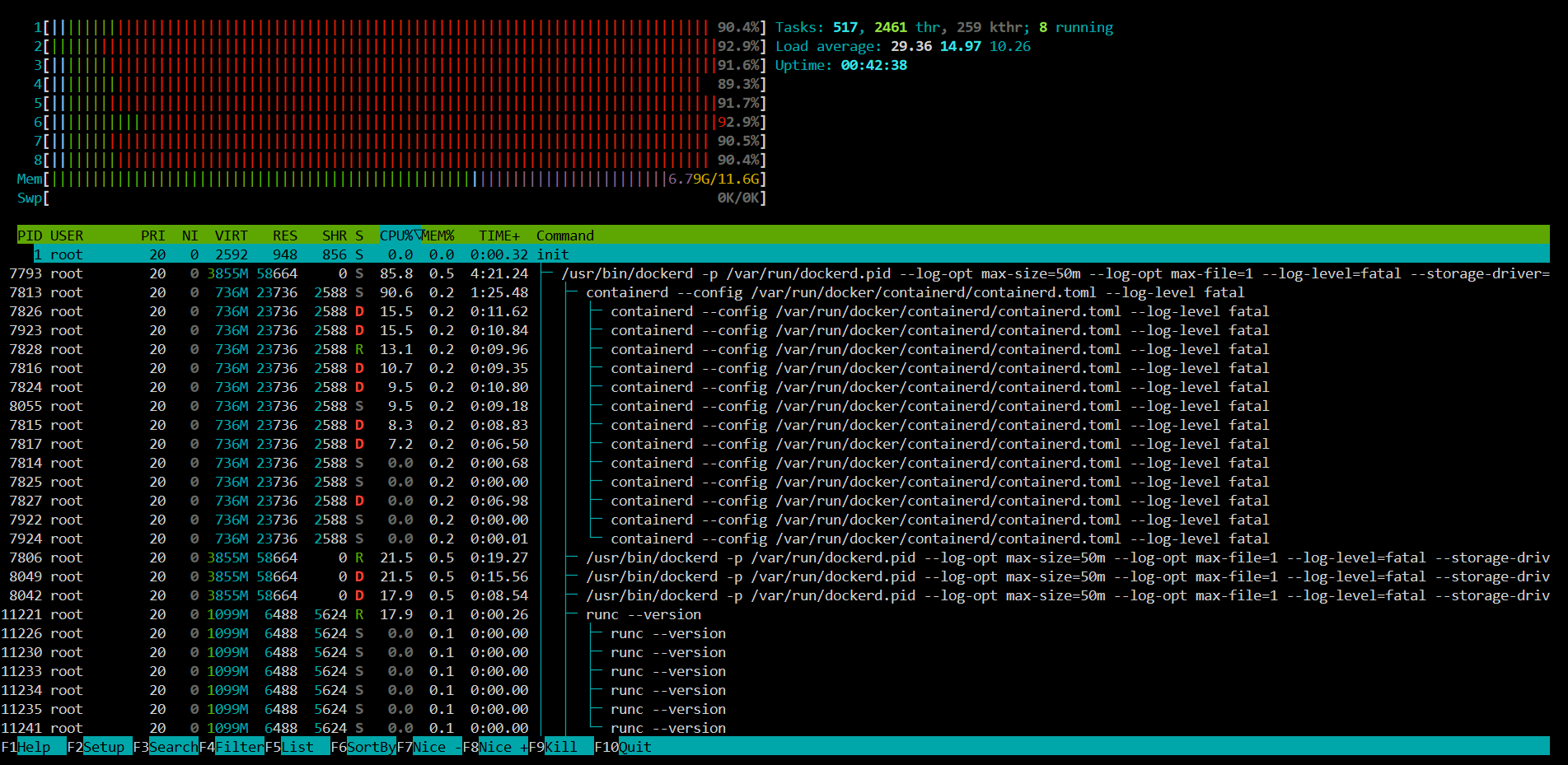

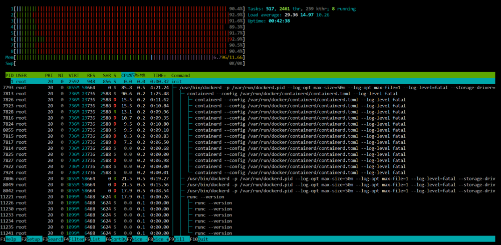

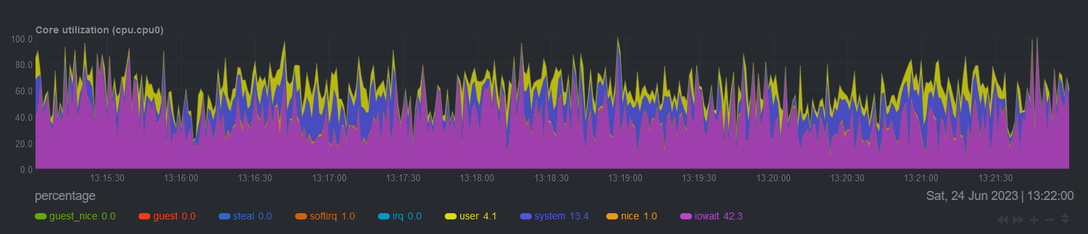

I checked netdata and apparently IOWAIT is constantly consuming the most resources.  When running htop command in terminal I saw... well, I have no idea what I was looking iat. But I'm attaching the pictures and diagnostics.

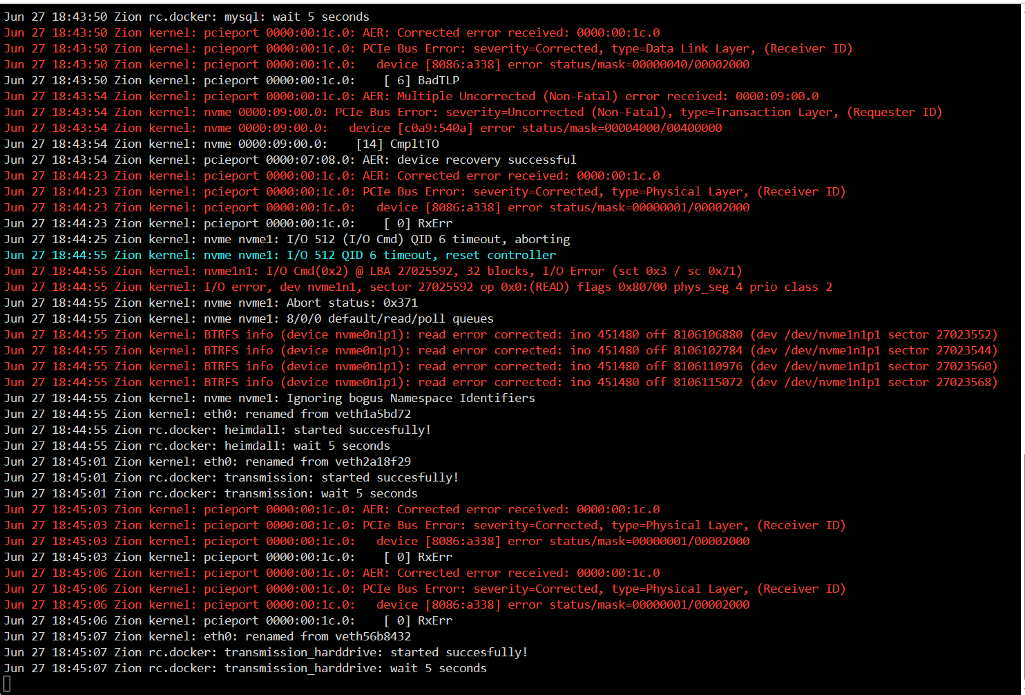

I found the problem is from the m.2 cache drives I connected over PCIE slot. One time I happened to write the cache to total full, and tried to fix it. Since the read error corrected message shows right after the server recovering from freeze, I think I might to run a full test on the m.2 drives to fix the issue.1950905279_Screenshot2023-06-27184514.thumb.png.09806f162fb3b137058c2d35428b5048.png

After my server rebooted I noticed 1 error what I haven't had before.
the error is refering to an vifo-pci.
I have atached the print screen for a better view.
Missed this post, you need to edit /boot/config/vfio-pci.cfg and remove the offending entry.
