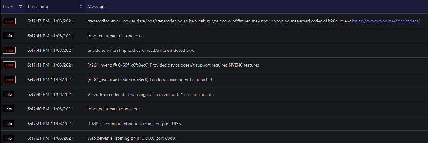

  3. I have noticed the same, the GPU is encoding ok, but there is something in obs that is using a lot of CPU. If I encode with ffmpeg-nvidia docker with the same settings my cpu doesn't pass 15%.
  4. Yeah I've already seen that post searching in the thread. I'm not encoding, so the card was free at that moment. I have an old gt710, and driver 470.74. Maybe it doesn't support your ffmpeg build.. but i wonder why it does work with the jellyfin ffmpeg. Thanks @ich777
  5. Hi @ich777 thanks for your hard work💪 I have a problem with owncast and nvenc encoding. I know the card works because I have it working in a jellyfin container, but in the owncast container i cant make it work. First of all here is the docker run command: An here the error in owncast: And transcoder.log: ffmpeg started on 2021-11-03 at 18:47:40 Report written to "data/logs/transcoder.log" Log level: 32 Command line: /usr/bin/ffmpeg -hide_banner -loglevel warning -hwaccel cuda -fflags +genpts -i pipe:0 -map v:0 -c:v:0 h264_nvenc -b:v:0 2700k -maxrate:v:0 2862k -g:v:0 96 -keyint_min:v:0 96 -r:v:0 24 -tune:v:0 ll -map "a:0?" -c:a:0 copy -sws_flags bilinear -filter:v:0 "scale=1600:900" -preset p4 -var_stream_map "v:0,a:0 " -f hls -hls_time 4 -hls_list_size 3 -segment_format_options "mpegts_flags=+initial_discontinuity:mpegts_copyts=1" -pix_fmt yuv420p -sc_threshold 0 -master_pl_name stream.m3u8 -strftime 1 -hls_segment_filename "http://127.0.0.1:41175/%v/stream-mtmr4EK7R%s.ts" -max_muxing_queue_size 400 -method PUT -http_persistent 0 "http://127.0.0.1:41175/%v/stream.m3u8" [flv @ 0x55f4c6fc07c0] decoding for stream 0 failed Input #0, flv, from 'pipe:0': Metadata: encoder : Lavf57.56.100 Duration: N/A, start: 62188.689000, bitrate: 2864 kb/s Stream #0:0: Video: h264 (High), yuvj420p(pc, bt709, progressive), 1920x1080, 2800 kb/s, 0.0000 fps, 30 tbr, 1k tbn, 60 tbc Stream #0:1: Audio: aac (LC), 48000 Hz, stereo, fltp, 64 kb/s Stream mapping: Stream #0:0 -> #0:0 (h264 (native) -> h264 (h264_nvenc)) Stream #0:1 -> #0:1 (copy) [h264_nvenc @ 0x55f4c6fc8ec0] Lossless encoding not supported [h264_nvenc @ 0x55f4c6fc8ec0] Provided device doesn't support required NVENC features Error initializing output stream 0:0 -- Error while opening encoder for output stream #0:0 - maybe incorrect parameters such as bit_rate, rate, width or height Conversion failed! I thought it could be because of the version of ffmpeg, or maybe bad build with some dependencies missing. The jellyfin docker im using has this version of ffmpeg: ffmpeg version 4.3.2-Jellyfin Copyright (c) 2000-2021 the FFmpeg developers built with gcc 8 (Debian 8.3.0-6) configuration: --prefix=/usr/lib/jellyfin-ffmpeg --target-os=linux --extra-version=Jellyfin --disable-doc --disable-ffplay --disable-shared --disable-libxcb --disable-sdl2 --disable-xlib --enable-gpl --enable-version3 --enable-static --enable-libfontconfig --enable-fontconfig --enable-gmp --enable-gnutls --enable-libass --enable-libbluray --enable-libdrm --enable-libfreetype --enable-libfribidi --enable-libmp3lame --enable-libopus --enable-libtheora --enable-libvorbis --enable-libdav1d --enable-libwebp --enable-libvpx --enable-libx264 --enable-libx265 --enable-libzvbi --enable-libzimg --arch=amd64 --enable-opencl --enable-vaapi --enable-amf --enable-libmfx --enable-vdpau --enable-cuda --enable-cuda-llvm --enable-cuvid --enable-nvenc --enable-nvdec --enable-ffnvcodec libavutil 56. 51.100 / 56. 51.100 libavcodec 58. 91.100 / 58. 91.100 libavformat 58. 45.100 / 58. 45.100 libavdevice 58. 10.100 / 58. 10.100 libavfilter 7. 85.100 / 7. 85.100 libswscale 5. 7.100 / 5. 7.100 libswresample 3. 7.100 / 3. 7.100 libpostproc 55. 7.100 / 55. 7.100 Hyper fast Audio and Video encoder And owncast this: ffmpeg version n4.4 Copyright (c) 2000-2021 the FFmpeg developers built with gcc 10 (Debian 10.2.1-6) configuration: --prefix=/usr --libdir=/usr/lib/x86_64-linux-gnu --enable-shared --enable-nonfree --enable-nvenc --enable-libx264 --enable-libx265 --enable-gpl --enable-cuda --enable-cuvid libavutil 56. 70.100 / 56. 70.100 libavcodec 58.134.100 / 58.134.100 libavformat 58. 76.100 / 58. 76.100 libavdevice 58. 13.100 / 58. 13.100 libavfilter 7.110.100 / 7.110.100 libswscale 5. 9.100 / 5. 9.100 libswresample 3. 9.100 / 3. 9.100 libpostproc 55. 9.100 / 55. 9.100 Hyper fast Audio and Video encoder Hope you can help me to figure it out
