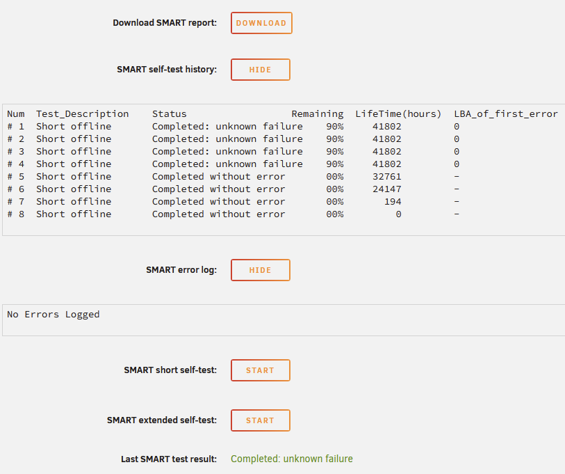

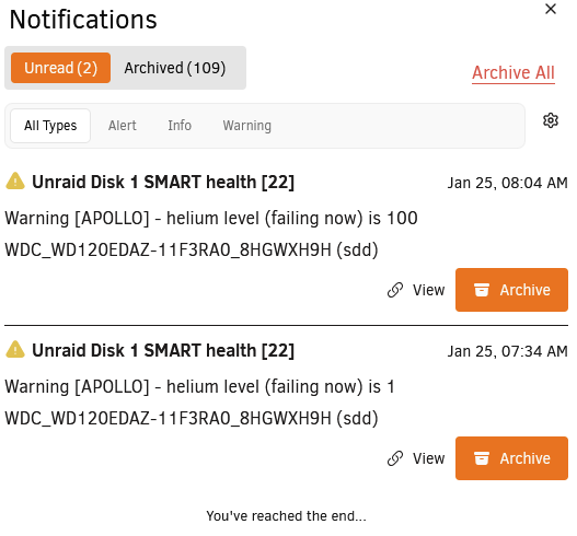

  1. Woke up today to 2 notifications from Unraid: Which is confusing because 100 would be a good value. On the SMART report the raw value is 100 but it's still marked as FAILING. And the report says "Drive failure expected in less than 24 hours. SAVE ALL DATA." I panic bought another drive which was frustrating with the current market prices, but I then did some research and it seems like it could still work? I'm reading a lot of threads about failing helium levels but a drive still functioning for months or years after. I do have 1 parity drive and anything super important is redundancy backed up elsewhere. The drive is 5+ years old and out of warranty, so RMA'ing it isn't possible. My speculation is it's just a sensor failure if it reported 1 then 100? But if I try to run a SMART Short Test it just immediately fails: Anyway, I've attached the full SMART report to this thread. What is the risk if I cancel my order and keep this drive going? I just shouldn't really be spending $250 right now if I don't have to. But I know having a hot swap replacement is a good idea also. WDC_WD120EDAZ-11F3RA0_8HGWXH9H-20260125-1010.txt

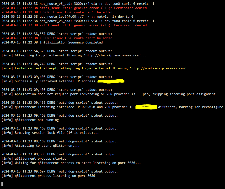

  10. Is there any way to diagnose why qBittorrentVPN is spiking my CPU? It keeps jumping from 1% -> 40% -> 2% -> 30%, etc. As far as my Unraid Processor load shows, it kind of sit around 25-30%. Here's what my "docker stats" shows: 2024-03-15 11-34-27.mp4 This is with 0 active torrents. My CPU is: Intel Xeon E3-1230 v3 @ 3.30GHz (full specs in signature). Using qBittorrent v4.3.9, Unraid 6.12.6, docker is pinned to 2 cores, 4 threads. Using AirVPN as my VPN client, if relevant. I assume the issue is that I have 3126 torrents in my client. I actually had 5000 but just yesterday got them down. But the general higher-than-expected idle CPU load has been an issue for a few months now. I only now figured I should debug it. Nothing seemingly out of the ordinary in my qBittorrentVPN logs: Any insight would be appreciated! Or if it's clearly just my high torrent count, I'll accept that. I'll try to dwindle it down.
  11. That makes sense! The torrent client version should be approved, I'm on 4.3.9. But good idea to check if the VPN server itself is being blocked or rate limited of some kind. I'm going to try switching VPN servers. Thanks for the reply, I appreciate it!
