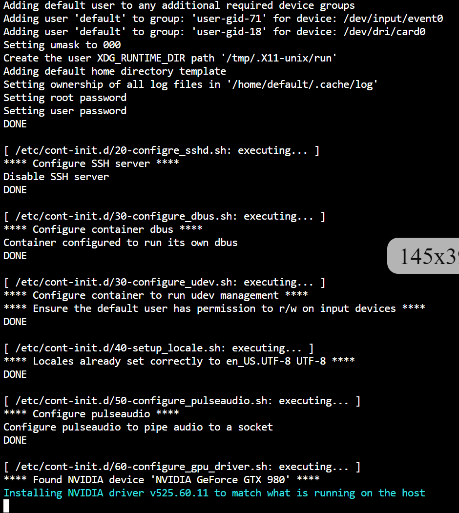

Is there any way to fix that? I am getting the same issue with my GTX 980 I'm trying to pass through. Just a continuous boot loop trying to match the host driver (see below)
Edited by randerson8804
Attached log
