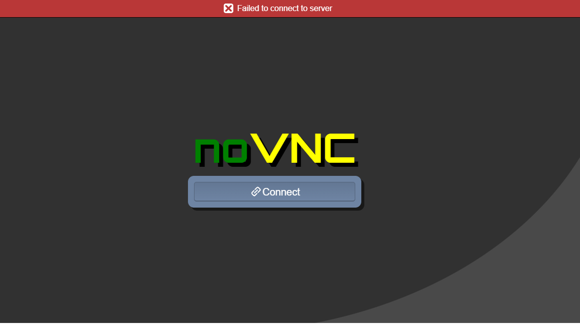

Hey.
I having an issue running this container. I open the WebUI and it just says "Failed to connect to server.  No VNC."
It worked the very first time I opened it after install. Was able to sign in to my account. Had to close the window and come back later. After that, it started saying this. Nothing changed in my server. Not sure what happened.
2 minutes ago, Ichithekiller said:
Hey.
Same problem here since updated to unraid 6.12 with Nvidia Driver 535.54.03
The log says :
2023-06-18 15:42:33,523 INFO spawned: 'x11vnc' with pid 5827
2023-06-18 15:42:34,524 INFO success: x11vnc entered RUNNING state, process has stayed up for > than 1 seconds (startsecs)
2023-06-18 15:42:37,325 INFO exited: desktop (exit status 11; not expected)
2023-06-18 15:42:37,327 INFO spawned: 'desktop' with pid 5858
2023-06-18 15:42:38,329 INFO success: desktop entered RUNNING state, process has stayed up for > than 1 seconds (startsecs)
2023-06-18 15:42:38,329 INFO reaped unknown pid 5862 (exit status 0)
2023-06-18 15:43:03,655 INFO exited: x11vnc (exit status 11; not expected)
2023-06-18 15:43:03,657 INFO spawned: 'x11vnc' with pid 6074
2023-06-18 15:43:04,658 INFO success: x11vnc entered RUNNING state, process has stayed up for > than 1 seconds (startsecs)
2023-06-18 15:43:07,470 INFO exited: desktop (exit status 11; not expected)
2023-06-18 15:43:07,472 INFO spawned: 'desktop' with pid 6105
2023-06-18 15:43:08,474 INFO success: desktop entered RUNNING state, process has stayed up for > than 1 seconds (startsecs)
2023-06-18 15:43:08,474 INFO reaped unknown pid 6109 (exit status 0)
The log says :
Downgrade your driver to v530.41.03
48 minutes ago, Ichithekiller said:
Hey.
Problem is that Unraid 6.12 recommend 535.54.03
I'm running 6.12 just fine with the other driver. You don't need to be on "Latest" for GPU. I assure you it'll be fine if you downgrade, and it will fix the container.
