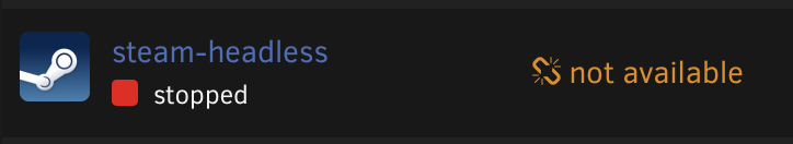

On 1/20/2023 at 1:21 PM, dopeytree said:
Is anyone else's showing up with update version not available?
In the docker section, toggle the "advanced view," then go down to steam-headless and "force update."

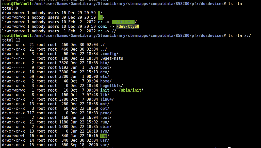

On 1/21/2023 at 8:19 PM, Josh.5 said:
I took a quick look into this. This is happening because steam is creating a drive link "Z:" to your root path "/" as a symlink. If you then view this from the host Unraid OS it looks like this:
This is not something that the Steam Headless container is doing as much as it is what the Unraid host shares are doing. It has created a symlink to / and so if you brows that you will see all the things in your root filesystem.
Hopefully this helps you in finding a solution that works for you. As for this container, there is not really any point in finding a fix. The solution as far as I can tell is to better configure your network shares for Unraid.
Thank you for looking into this.  Sorry for my late reply.
My concern is that the symlinks, and the folder containing the symlinks, were created by this container.
I don't think this is an issue with my share config, as it hasn't changed in a long time, and the offending folder and symlinks didn't exist before I installed the Steam container.
But now that I know they are symlinks, I can just clean them up.  Thanks for taking time to look into it.

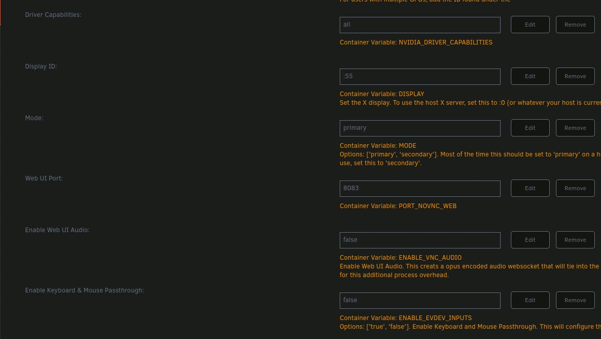

Trying to use sunshine with moonlight, am i the only one that is unable to get keyboard and mouse support ? I can start and connect using moonlight , i get a video stream but unable to control the keyboard or mouse.
me too.
I have read something about multi sessions or seats. So the keyboard and mouse ist on the wrong "Desktop". But i have no idea to check ths or even fix it.
I just did change the network mode for the container from bridge mode to network ... and also update the container to the version release last night and now keyboard and mouse is working !!!
You cannot run this container in bridge network mode if you want to use inputs outside of steam big picture. Bridge will prevent things like controllers from working in game.
Yep. I figure that out this morning . My bad for not reading the instructions!

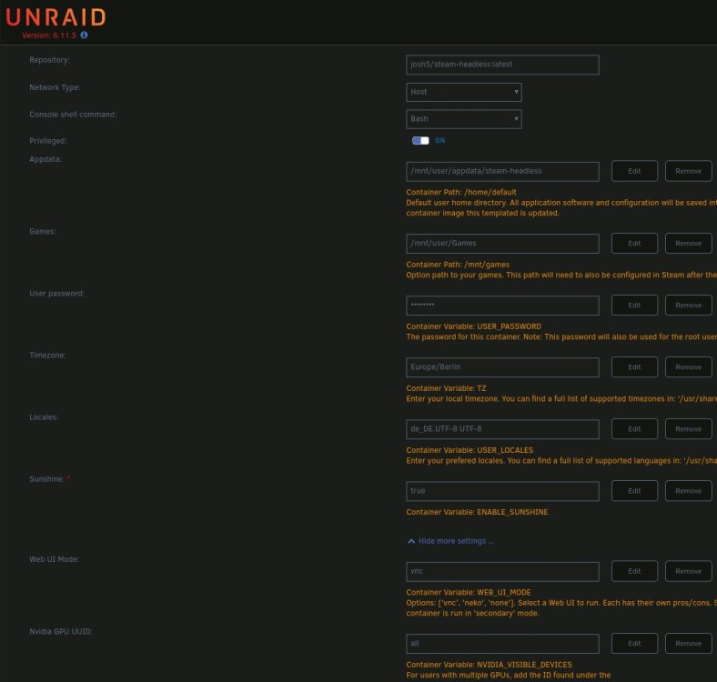

Do you got your inputs working?

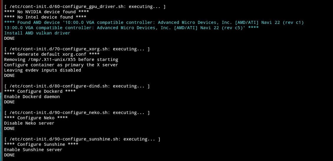

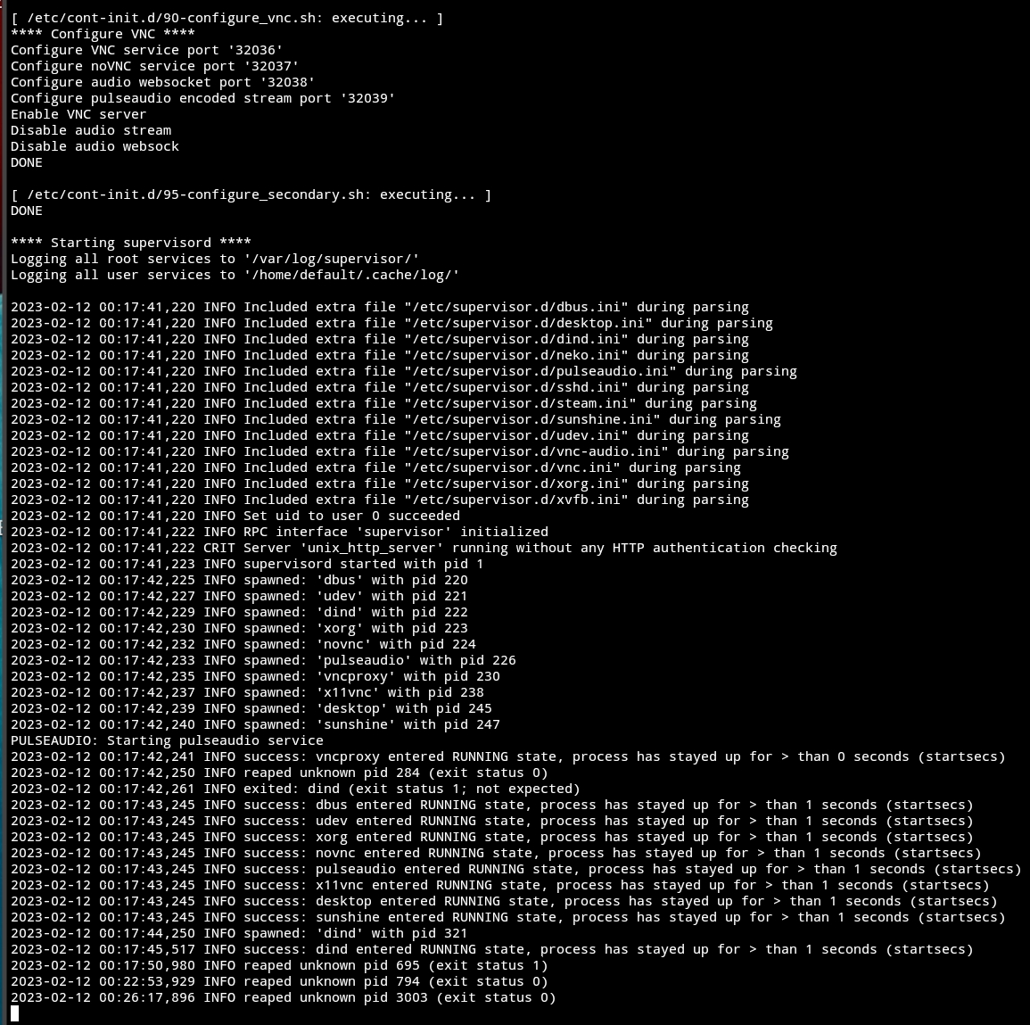

I started the container from scratch and just added the env for sunshine.
On Unraid 6.11.5 the uinput plugin is not needed anymore, right?
Here is the docker log, maybe i'm missing something.
493416457_Screenshot_20230212_002924_SamsungInternet.thumb.jpg.d37f05a70fef6efa51290f89760c3a9a.jpg
831703833_Screenshot_20230212_002914_SamsungInternet.thumb.jpg.995ca8910f2bc3047af642ddc3cc86e7.jpg

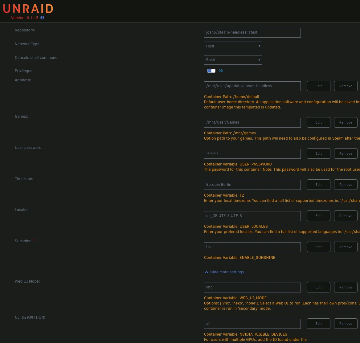

And the Docker Config:
1196411218_Screenshot_20230212_003444_SamsungInternet.thumb.jpg.4fbb9f0a6edee385a46ed4fb9476641e.jpg
140031567_Screenshot_20230212_003459_SamsungInternet.thumb.jpg.ae9abf76940d9f046340a3da04437ab3.jpg
