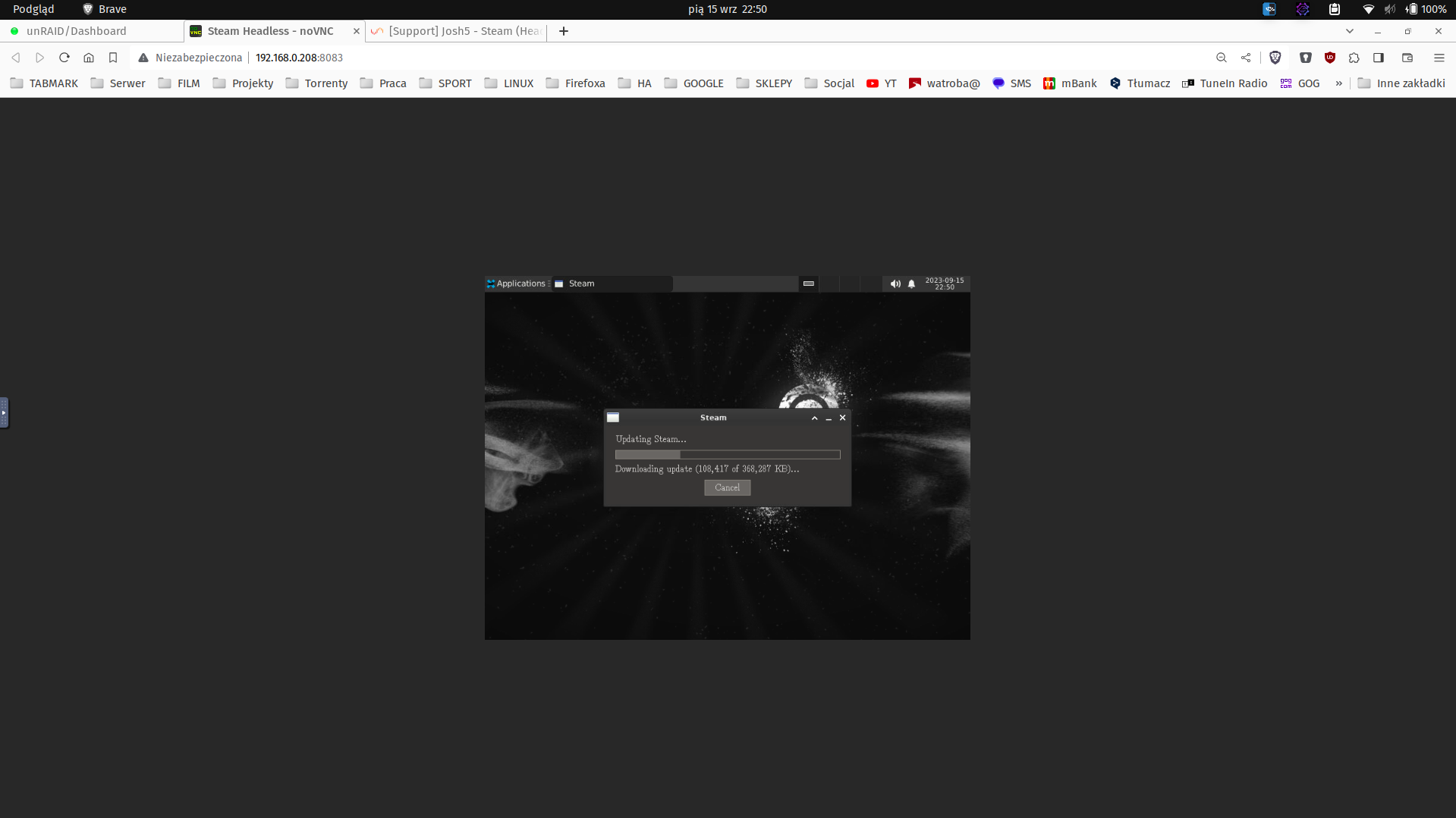

Hello @Josh.5 I install steam-headless on my unraid to test how it works. My hardware is:
ASUS PRIME H610I-PLUS D4 motherboard
Intel® Core™ i5-12600K
64 GiB DDR4
intel UHD 770 GPU.
it's possible to run on that? I install but my desktop window is very small and steam after installation don't work at all. Nothing happen after login. I don't change anything in container.
Regards.
@MarianKoniuszko That could be due to the Intel iGPU drivers. I'm not sure it's fully compatible with this type of setup. Or some tweaks would be needed.
Hi, @z0nik thanks for answer. Do You think it's also reason why steam don't want to show. I see only as minimized. I try steamos container from linuxserver and it works OK.
Regards.
Regards.
Steam might be running minimized. See top right for Tray icon, Right click and select Library to open Steam. 🙂
That's what I mean. That don't work at all.
That's very strange @MarianKoniuszko - it works OK for me here. Also I see Josh has updated the image 4 hours ago, so he's still tweaking/fixing it in different ways. :x
This happens when you have an AMD or Intel GPU and you dont use an HDMI or DP dummy plug.
