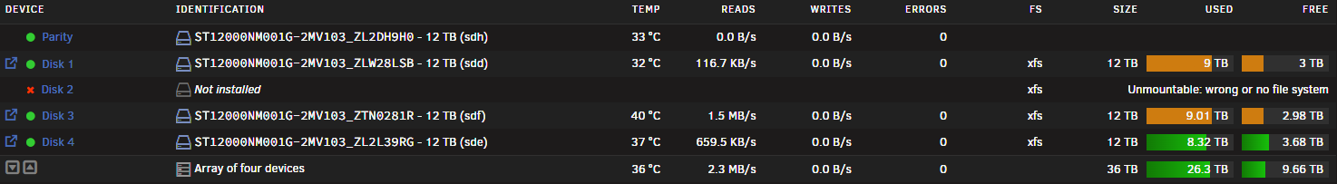

  5. Running it now. It's finding a LOT of problems that it didn't when I checked it with the disk in the array.

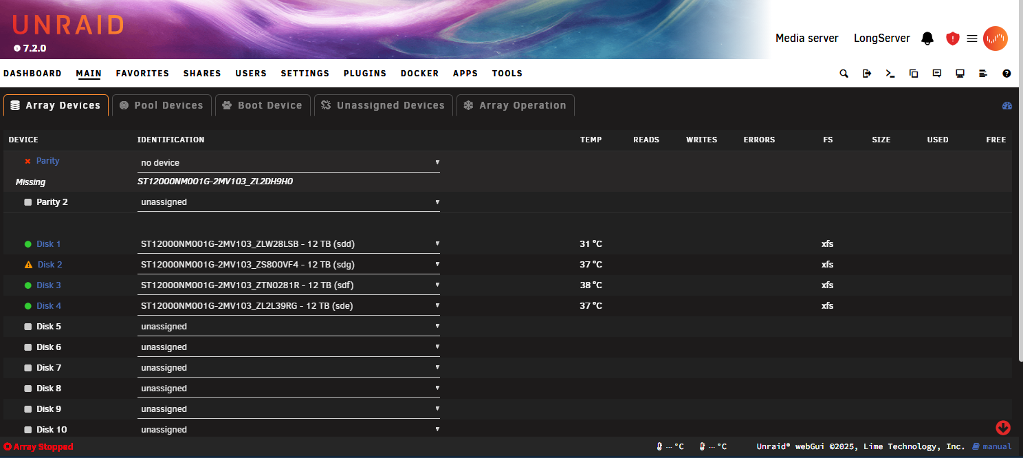

  9. root@LongServer:~# fdisk -l /dev/sdh Disk /dev/sdh: 10.91 TiB, 12000138625024 bytes, 23437770752 sectors Disk model: ST12000NM001G-2M Units: sectors of 1 * 512 = 512 bytes Sector size (logical/physical): 512 bytes / 4096 bytes I/O size (minimum/optimal): 4096 bytes / 16773120 bytes Disklabel type: gpt Disk identifier: 92B2D47B-E56E-4114-9AD2-2B6719D80C4D
  10. Removed the partition in gnome disk management, but did not format and have not mounted the disk since. I did run TestDisk, but it didn't identify anything that looked like the partition, so I did not write any changes. Just restarted the server in Unraid, diagnostics are attached. If the array can be restarted and the parity recovered and/or rebuilt, that would be amazing. longserver-diagnostics-20260317-0955.zip
  11. I did not attempt to mount the drive anywhere else. Before I saw that it was unmountable, I started the array in normal mode intending to rebuild. The rebuild started automatically, but there was a warning that Disk 2 was unmountable, and on the array status that drive had a red X rather than the green dot. Hovering over the drive said that the contents were emulated, and my system appeared to be functioning normally otherwise, my docker containers were running without problems. At that point, I cancelled the rebuild since I knew it being unmountable would not let it complete successfully. I stopped the array and restarted it in maintenance mode. The SMART diagnostics for Disk 2 were fine, so I ran the XFS file check. It attempted to fix it but failed. I tried again from the command line and got the same failure. In maintenance mode, there was no error message about the drive being unmountable, but it came back when I switched back to normal mode. My initial thinking at that point was format the drive and let it rebuild. But it did warn that formatting would lose the data, so I didn't proceed with that. When that wasn't getting anywhere, I shut down and rebooted from a Linux Mint image. I hoped that if I formatted the drive outside of Unraid, it would be treated like a new disk and I could add it in place of the now-missing Disk 2 to rebuild, since the contents would have been emulated. None of the drives were mounted while I was in Mint. I ran xfs_repair -n on the four drives showing XFS filesystems. None showed any errors that should have made them unmountable, and Gnome's disk manager showed an enabled mount button for all 4 (which I did not hit). My mistake was thinking the parity drive was also xfs and the one drive showing an unknown file system and no mount button was Disk 2 of my Unraid array, since I didn't see any reason it would be unmountable in Unraid but (theoretically) mountable in Mint. At this point I'm thinking I'll have to recreate the array with a couple of smaller disks that I have available, copy data via mounting in unassigned devices, then add the now-empty disk to the array and move onto the next. If I'm understanding the way Unraid stores files, I should be able to get at least 3/4 of my data from the 3 good drives and cache SSD, and maybe the rest if the failed drive can be mounted. For future reference if something like this happens again, if a filesystem is corrupted and unmountable, is there a non-destructive way to reset the disk? ie remove the disk from the array and start it with an emulated disk, format the disk in unassigned devices, then re-add it as if it were a replacement drive? Also fwiw, I'm still on 7.2.0 because I had an update fail on me a while back and was holding off on trying again. So if it was a glitch that may have been fixed since then, that's also on me. I'll post the diagnostics when I'm back in front of it and boot it up in Unraid again.
  12. The actual drive was unmountable, but the emulated drive was running in its place. If I started the array in normal mode, my data was available, but that drive had a red X and on the array function screen it said it was unmountable. I tried an xfs repair both from the UI (while in maintenance mode) and the command line, but it kept failing. I knew rebuilding wouldn't fix that, which is why I didn't do a rebuild, and was trying to reset that drive so I could replace it with itself, basically. I didn't actually mount the other drives, though if I can get the bad data drive repaired and mounted, then I can rebuild the parity, hopefully.
  13. So, I screwed up. I've been moving my server from an ITX case to a Poweredge R730xd. I was initially having trouble with drives cutting out, and one of my data drives wound up with a corrupted, unmountable file system. I tried several times to repair it, but it would always fail at the end. After a day or two of trying to get it mountable (the drive itself passed diagnostics, the XFS filesystem was just completely hosed), I figured that since the emulated drive was working, I'd boot into a different Linux, wipe that drive, and let Unraid treat it like a new replacement and rebuild. My mistake was not getting the serials of the drives first. On the five drives, I saw four XFS volumes and one unmountable unknown format. The four XFS drives seemed to pass a check, so I figured the bad drive was the unknown, and deleted the partition. Rebooted to Unraid and discovered it was the parity drive, and my array was now totally shot. I haven't mounted any of the drives since. I'm currently running TestDisk on the parity drive. It's found deleted FAT32, HPFS - NTFS, and FAT16 partition info so far, but it's still got 25% or so to go on the quick scan. Is there any hope it'll find the correct partition and let me restore it? If so, what format is the partition in? I assume the filesystem is something not normally readable, and as I recall gparted said it was a Linux partition. Failing that, is there another way to recreate the partition since the data should still be intact? I didn't format the drive, only remove the partition.
