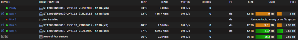

Post a screenshot from Main and the output from fdisk -l /dev/sdh
root@LongServer:~# fdisk -l /dev/sdh
Disk /dev/sdh: 10.91 TiB, 12000138625024 bytes, 23437770752 sectors
Disk model: ST12000NM001G-2M
Units: sectors of 1 * 512 = 512 bytes
Sector size (logical/physical): 512 bytes / 4096 bytes
I/O size (minimum/optimal): 4096 bytes / 16773120 bytes
Disklabel type: gpt
Disk identifier: 92B2D47B-E56E-4114-9AD2-2B6719D80C4D
Diagnostics the user posted Sept 2023 had those same disk assignments, except current disk4 was parity2
Still some confusion from your first post, but maybe not critical that we understand all the details.
Was disk2 the "emulated disk"?
Yes, I was running out of space recently and went down to one parity drive, with the expectation of moving to a new machine that could hold more drives and going back to 2 at that point.
Correct. It still indicates that if I hover over it on the Main tab, but obviously it's not going to work in this state.
It can't actually emulate a disk when no parity is assigned.
We'll have to wait for @JorgeB to tell us how to fix partition on parity if possible.
Ok, I'll hold off on doing anything else with it until we determine if that repair is doable or if I'll just have to manually salvage what I can.

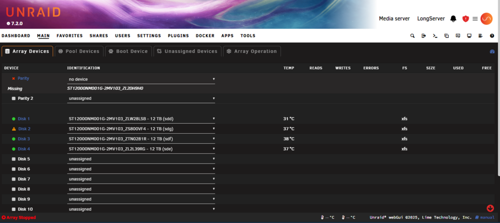

You can create the partition using
sgdisk -o -a 8 -n 1:32K:0 /dev/sdh
If you rebooted since the last diags, check that the disk is still sdh, it can change.
Then reboot and see if the disk goes back to being assigned, if yes, unassign disk2 and post new diags after array start, if it doesn't, you may need to do a new config, but it needs specific steps to get it to emulate disk2 again, so post here.
Ok, updated diagnostics with Disk 2 removed from the array.
Main still says it's unmountable and there's no mnt/disk2 folder, though that may be normal behavior for an emulated disk.
