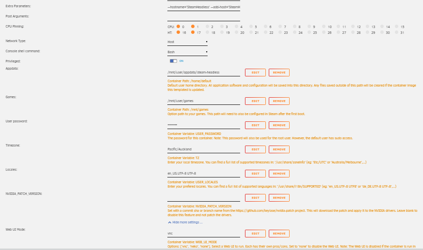

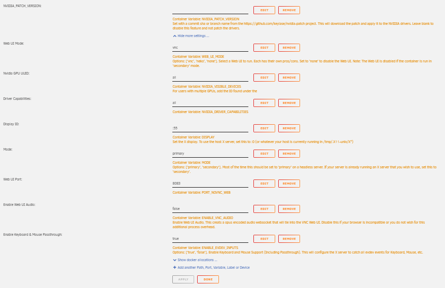

I'm trying to get the sound to work through the secondary instance.
The main one is working just fine through moonlight/sunshine and I can see the secondary instance and launch games and play them just fine, but there is absolutely no sound. I've tried a couple of games and also playing videos through the steam store page (which work on the main instance) but I hear nothing on secondary. Is there any configuration I have to do to get this working?
I've been searching through this thread and haven't had any luck finding info on getting an AMD igpu working other than radeon-top and remove the nvidia parameters.  Anyone know of anything else to try or is that a known no-go.  AMD 5700G.
EDIT: Forgot to mention, have rebooted unRaid after changes to test/rule out as well.

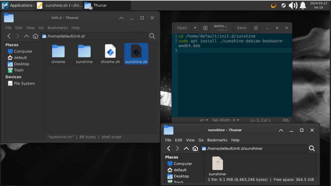

Hello, I can help you with how to update sunshine, It may not be the most optimal way, since it requires manually downloading the latest version, but it worked.
1. create "sunshine" folder in "/home/default/init.d" folder
2. download the file "sunshine-debian-bookworm-amd64.deb " of the page https://github.com/LizardByte/Sunshine/releases and store the file in the folder "/home/default/init.d/sunshine"
3. create "sunshine.sh" file in "/home/default/init.d" folder and in the content of the file it is this:
cd /home/default/init.d/sunshine
sudo apt install ./sunshine-debian-bookworm-amd64.deb
