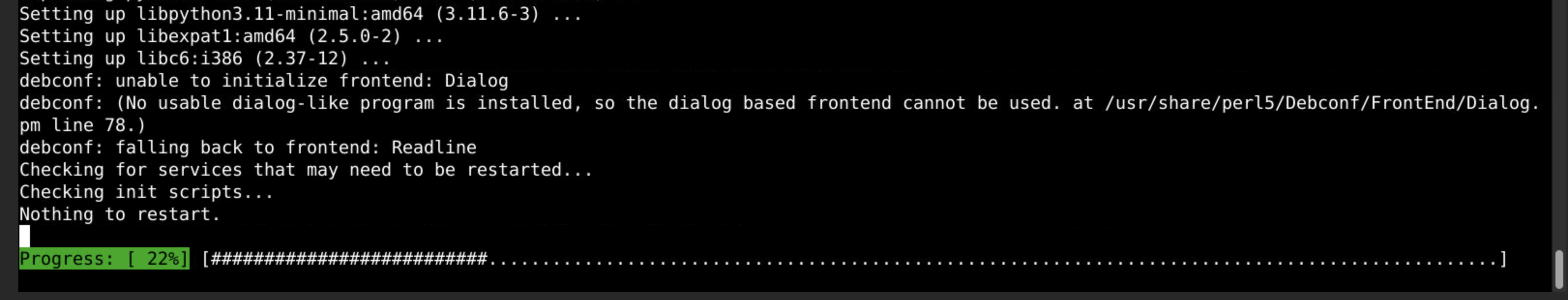

Secondly, I was looking at installing some bits, but it needs to do a apt install, I noticed there are a ton of updates to do right out of the box.
Is it safe to do this? I tried to apt update, but it just hung at 22%

I was running the command as sudo apt-get full-upgrade

Clicking Apps then System then Software never yields any updates available. Its always you're updated.
Even tho I know there is like 650 updates pending if you do apt update...

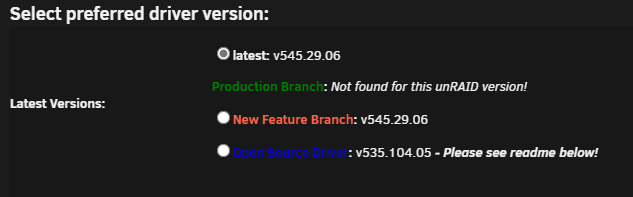

The docker has been working very well for the last few months.  Yesterday I spun it up and when accessing the GUI, it "fails to connect to server."
The logs are:

Not sure what's changed.  I recently updated to 6.12.6, but nothing else is having an issue.
Yep, mine just wouldn't open up steam to save it's life.
Hi Team,
for those having the X Server crashing issue please add --device='/dev/dri' to your extra paramaters, i am using an AMD GPU and this solved the crashing for me. Happy new year.
I am having the same issue as well. I upgraded from 6.12.4 to 6.12.6, and how this container no longer works, which is a shame. I really like it.

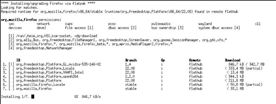

I'm encountering a problem where it seems stalled trying to download drivers and Firefox. It gets stuck on one specific download. The ones before it went fine, but it'll never progress to the ones after. It always gets stuck at 8%.
I was able to resolve this by renaming a manual driver download and placing it in the proper directory. Instead of trying to download the file, it ran what was already there.

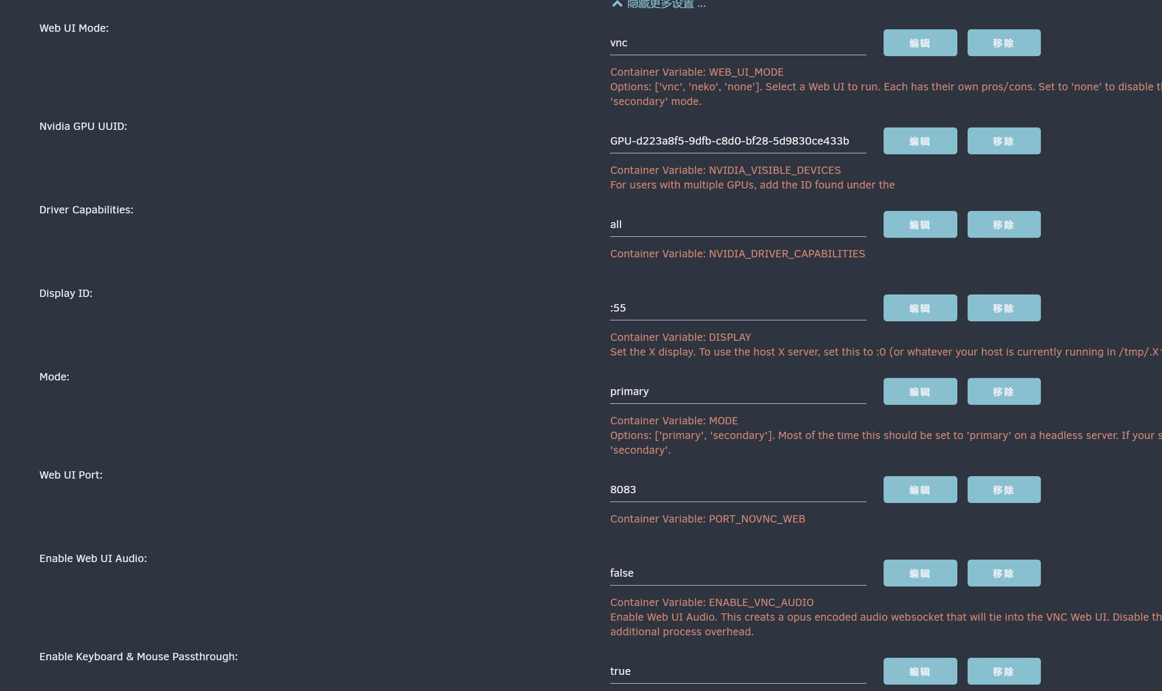

Hello, I encountered this error while trying to run Steam headless. What should I do? Thank you very much.
[ /etc/cont-init.d/10-setup_user.sh: executing... ]

Some important configurations are shown in the figure

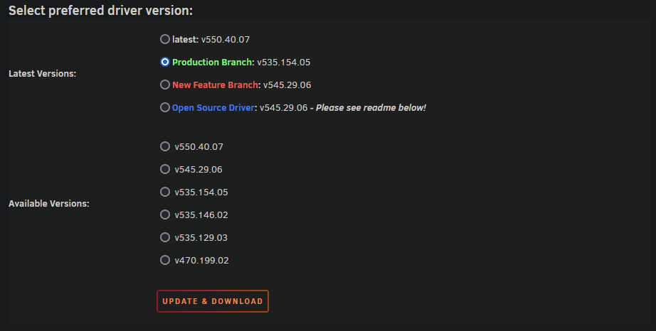

I changed the nvidia driver to production and solved the problem
I had the same issue on unraid, steam-headless went into a bootloop trying to match the server's nvidia driver
Changed the driver to the production driver as you pointed out, rebooted and steam-headless worked again.

Those who are having issues with this container crashing repeatedly, and never getting going, should consult this thread, it solved the problem for me:
https://github.com/Steam-Headless/docker-steam-headless/issues/111
More specifically, xorg was crashing, and the container was not accessible.
It was working fine for a while, and suddenly wouldn't run anymore a few months back.
Scroll down to apclapp's comment.  A real hero.
I don't have this luck.

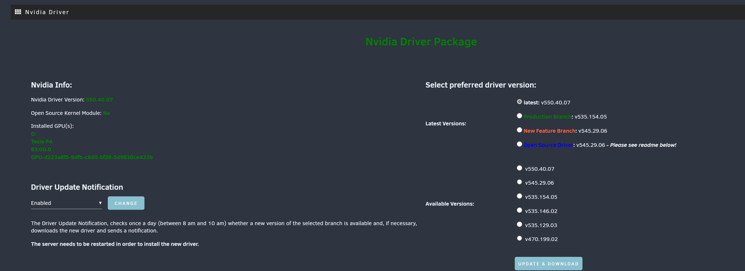

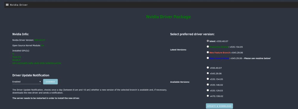

Unraid 6.12.4
I swear I had production branch before but it's gone since I moved the card in my case (found out it was in x1 instead of x16). Quadro RTX A4000. Cannot run any games in steam, it just either start and stop or just show nothing.
Unraid 6.12.4
Weird. This is actually what fixed it for me, was just stepping down to Production Branch. But I'm on 6.12.6... don't know why you're not updated, but I don't think theres any harm in updating your Unraid. It'll probably show up then.image.png.32c8c2a75339fdd9522e2a30f77e4b9c.png
I also had to go to production branch for my nvidia drivers to get it to work.
Another issue I'm having is I can't get my resolution above 1600x900.
Edited by bobdole199534
I see there's some pull request to fix some >500 driver issue. Unsure if it will be merged, don't see any new built since september 2023. Owner must be busy.
Ok I manage to update to latest version of unraid and install production. Now I do have it starting and steam running. But when I start a game, it's says running and I never see the game, it just sit in running. After sometime, steam return as if the game nicely closed. I tried using the vnc and steam remote play and all yield same result. I tried installing protonge and samething. Any clues? Is there something I'm missing?
