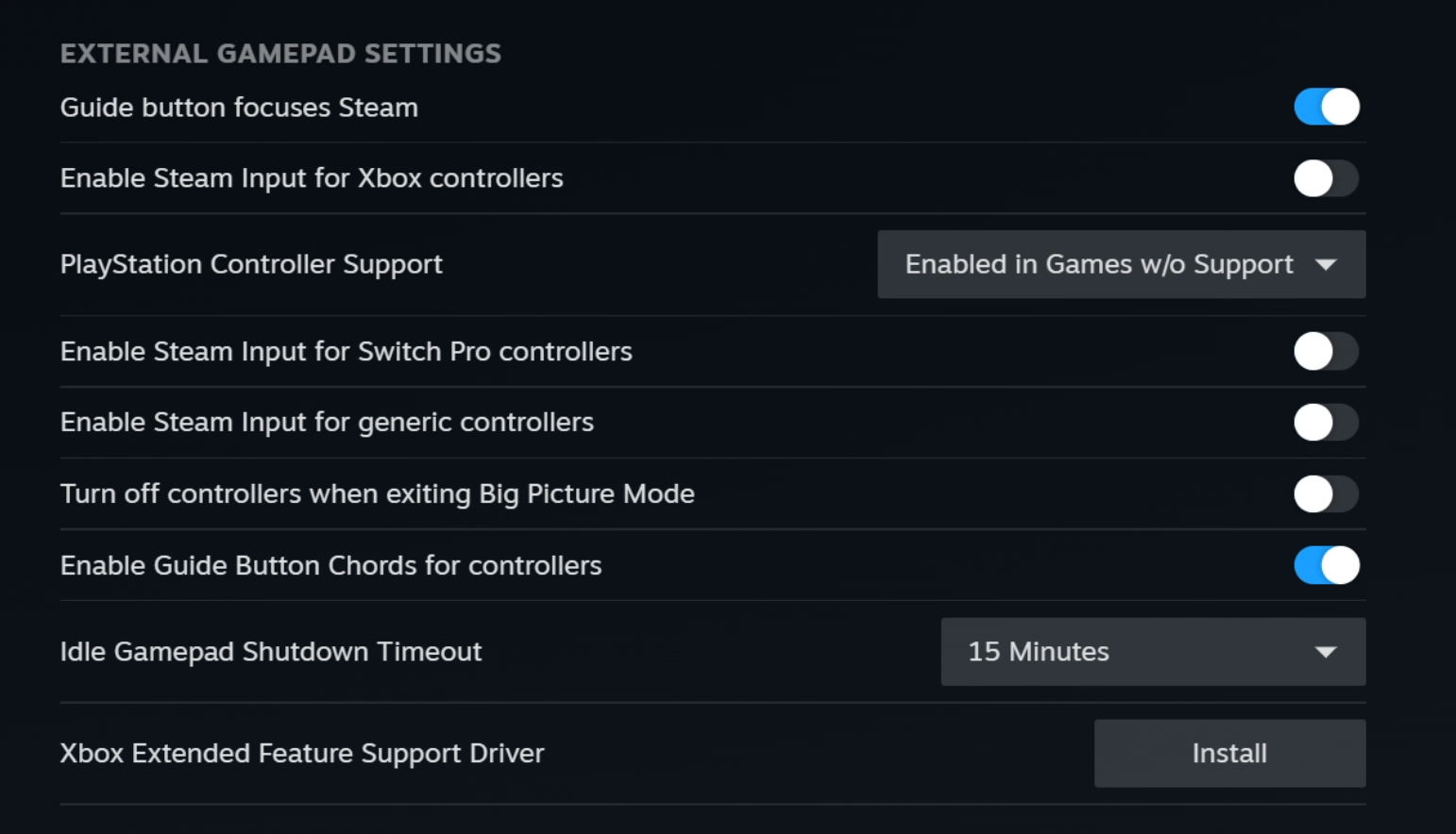

14 hours ago, bmartino1 said:
with controller stuff. Make sure the setting in steam are installed for controllers.
By default per steam client per machine:
You may need to enable the controllers.
Double-check sunshine as well inside the docker.
Thanks for the reply.
Here are my steam client "Controller" settings:
When I select "Enable Steam Input for Xbox controllers" the "CONTROLLER" dialog box for the game switches to "Mostly Playable...":
Regardless of these settings, the controller is recognized in Steam and passes calibration perfectly.  The controller stops functioning when starting a game, but the mouse and keyboard continue to work.
This experience is the same on a Windows PC using Steam Remote Play (STREAM) and Steam Link on the nvidia shield.  I've tried a bluetooth Xbox S controller and the nvidia shield controller, both behave the same.
I even tried the "Xbox Extended Featured Support Driver" without success.
I contrast, I tried streaming from a Windows PC and it worked perfectly.  I suppose I can try streaming from a Linux PC to see if the controller works.  Maybe the issue isn't the steam-headless container, but a Linux issue in general.
I've found stuff like this which sounds similar, but to no avail.  Any help is appreciated.  This is such a cool idea--being able to run GPU compute workloads next to gaming is a fantastic idea.

Quick Summary:
Review help docs on steam as this is more a client server steam issue...
double check controller drivers and inputs in client and on remote device
in steam double check controller option are enabled and game support control and launches with that support.
*Depending on how far you are with a wireless controller. You can pass that to the VM/Docker and use that passed usb device to have a local connected controller.
You should also have the generic input switch enabled, as when passing over a network "while streaming" the hid input changes. Which can lead to this behavior.
Its something you have to play around with. On Windows I usually enable them all. In the docker it's most of them but generic for sure needs enabled...
Review their docs:
https://help.steampowered.com/en/faqs/view/0689-74B8-92AC-10F2
as this could also be a docker driver add-on needed to install xinput and directinput...
XInput or DirectInput has been known to have issues with steam remote play. (This is why I prefer to use a xbox 360 controllers)
(in which case you would leave this docker and use a lxc / VM) ...
Lets review/exampine the steam client:
With nvidia shield with a wired controller works best. I use old afterglow xbox360 to the shield.
when steamlink and the steam controller first came out I tested and tried at best it was a nice remove screen viewer to alt tab and watch movies...
Steam and steamlink tried, but that was more prof of concept then actual usability...Form my experience...
NVIDIA shield with steam link app had better stream and input handling. But due to amazon and goolge fight over Android TV the shield is reaching EOL...
SO Hardwire as much as possible. Use a LAN connection... LAN link over wifi has lag and can be unplayable. Without a certain level of connectivity and bandwidth, even control inputs will not pass...
a mini pc running (Holo) arch steamOS or windows would preform better than the docker. This has to do with resources and host access to drivers and support...
Also make sure the game is set to use the controller before launch. There are addition setting and other launch options if you dig into steam docs and commands...
example: https://www.epicgames.com/help/en-US/c-Category_RocketLeague/c-RocketLeague_TechnicalSupport/steam-controller-configuration-for-rocket-league-a000084237
this is why sunbeam exists in the docker as it was a parsec like experience to remove screen view and use remote xinput to interact.... as you would use sunbeams client and connect to gurantee a better remote and input experience...
My last testing found that this docker hasn't been maintained and updates are needed. but a steamOS docker exisits in the CA as well for its evolution... try that one instead...
as my solution was to leave this docker for a better experience due to having granular control over the container...

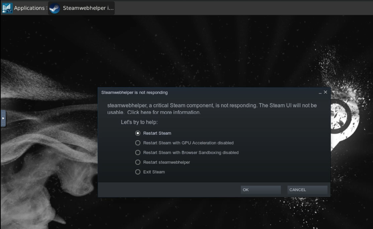

On 11/22/2024 at 4:26 AM, bmartino1 said:
new docekr installs apear to be broken.
steamweb helper errors.
terminal commands to reinstall steam are presented with permission errors.
Did you ever try this sorted? I’m getting the same error. It launched fine the first not but failed afterwards.
i did not. I've moved on to the arch steam os docker verion and other means to acompliush my goals.
In the past this was a permission issue and steam related in terms of downlaoding data.
https://github.com/ValveSoftware/steam-for-linux/issues/10412
it could have also been host g card driver related...
but no I was unable to get it corected.

The unraid version kept crashing, so I decided to use docker.compose manager and it was able to start up.  I'm getting now "Steamwebhelper is not responding" error.  Looking at the logs it isn't super clear what the issue is but I do see a random PID starting and stopping.
I'm using a 1080ti, and have the GPU setup correctly (it's showing up in the container).  I turned off any other docker that has that GPU associated with it (just my AI dockers).
Every now and then in the steam bootstrap_log I'm seeing that it attempts to download an update finishes but skips applying it?
It doesn't matter what option I select it still fails and pops this message back up. lmk if there is anything I can look at to troubleshoot this issue.
Edited by Wachuwamekil

Hi! I have RTX4060 used in unRAID for Jellyfin transcoding and want to use it for steam-headless as well but it seems that when jellyfin container is active steam-headless can't detect NVIDIA card. Is there any fix for that?
I got my SteamWebhelper sorted out @Wachuwamekil
I was reading a comment that it pointed out it was die home directory.
https://forums.unraid.net/profile/278474-bomberus/
Ussually it is something like /mnt/user/appdata/steam-headless/
I changed this direktly to
/mnt/vm/appdata/steam-headless/
vm here is the pool name were the appdata is located on my unraid.. So without the user/
And it works right away. So thanks tio @Bomberus for the hint.
