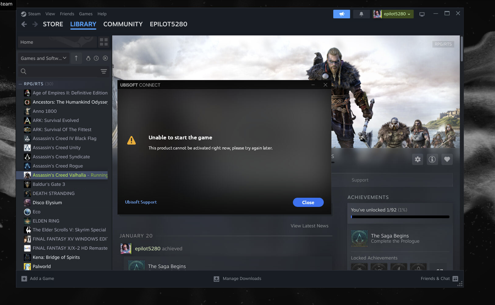

  8. Anyone know why Assassins Creed Valhalla might not run on this? Runs fine on the steam deck but doesn't get past the Ubisoft loader and says it can't be activated on headless
