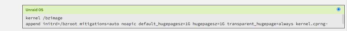

This was what I did to keep the GUI from displaying on the P400, which obviously doesn't work with the A310.

as you need to tell bios to boot to either pcie or onboard GPU.
as your case is IPGU first then pcie arc GPU...
you may need to add additional syslinux grub settings...
Does you machine have onboard graphics?
CHECK BIOS FIRST!
and have unraid remove the Frame buffers at boot.... (more a NVIDIA thing for vfio / pass through...)
#GPU Pass Through Remove Frame Buffers:
video=vesafb:off,efifb:off,simplefb:off,astdrmfb initcall_blacklist=sysfb_init
Go to Main > Flash > syslinux
Warning. this may remove unraids ability to dmesg display out. Making debug at local console harder as there will be no screen...
to undo at grub boot menu, hit edit and remove the video / intcall back line at the grub boot menu at unraids boot with a monitor...
