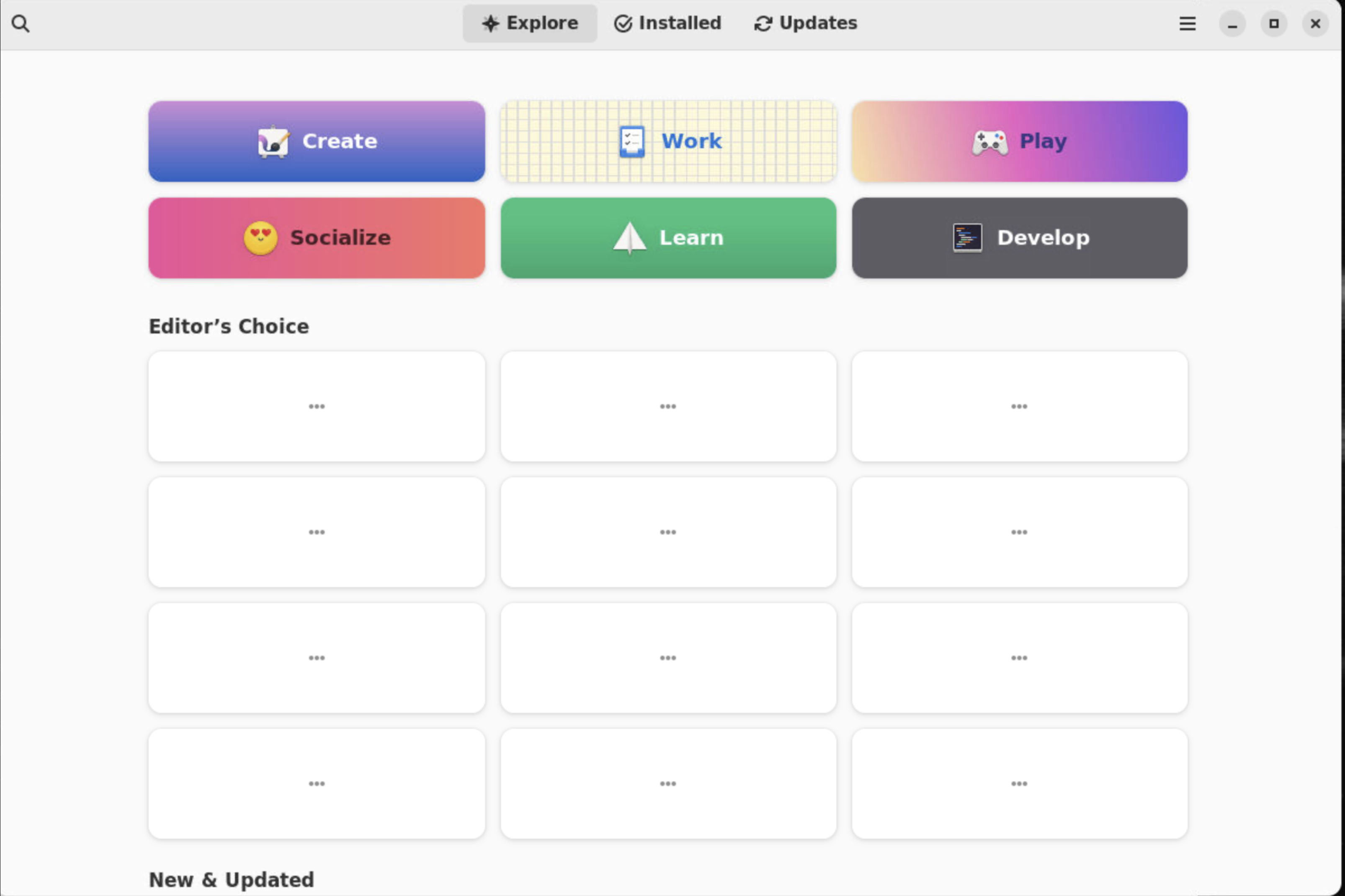

Anyone got a solution for gnome software not loading completely? Thanks!
