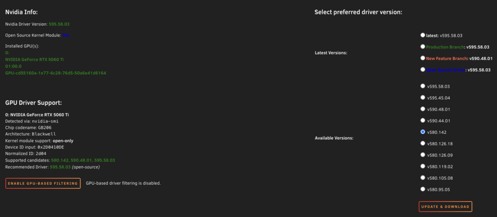

On 4/7/2026 at 3:43 PM, chesh said:
If anyone is currently having issues launching Steam-Headless or launching games (assuming you can get to the desktop), and you're using Nvidia drivers, try downgrading your drivers to v580.142. This is what finally fixed my issues.
How were you able to downgrade? If I downgrade the version to 580.142 (obviously non open source), my GPU is not detected (and consecutively not usable, sure). How to downgrade to open source 580.142? Thx!
I had the same issue, when attempting to downgrade my GPU drivers, my GPU was no longer detected. After a few reboots and going back to the latest driver, I was about to get the desktop to the steam headless container. And then I noticed sunshine was not starting.
I had to install the "user" version of sunshine and Firefox, for sunshine to work on restart again. From the software center.
Thanks for reaching out. I can downgrade, but the downgraded driver is the closed source version, which doesn't work with my 5060Ti...

1 hour ago, chesh said:
Try different driver versions. I know it's a pain, but I started at latest and downgraded to each driver lower that was compatible until one worked. I'm on a 3060 12GB and the v580.159 is what worked for my card.
That's exactly what I couldn't do, because I have a 5060Ti (Blackwell) and therefore dependent to the open kernel modules, which in turn prevented any driver downgrade under Unraid. – That said: the acutal unraid/driver upgrade (7.2.5/6.12.85/595.71.05) fixed the bug with "Failed to acquire modesetting permission" issue.
